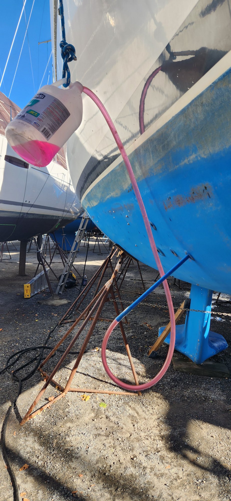

Almost. The head intake line needs to tee into the sink drain line as close to its thru-hull as possible because it needs to be below the waterline to draw in any water.
