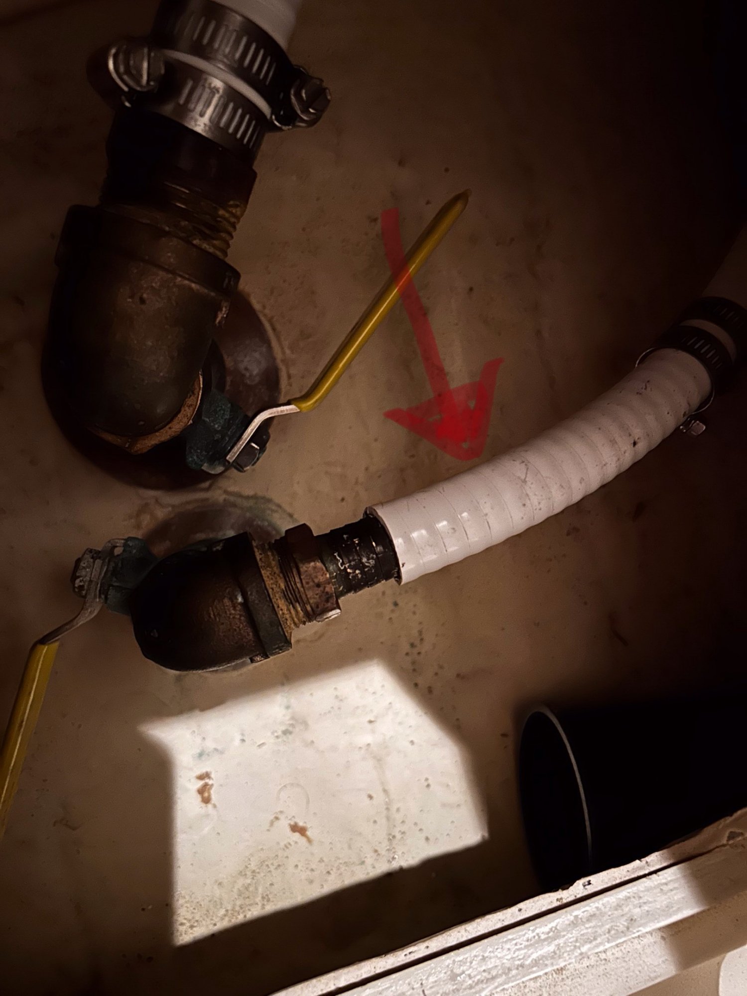

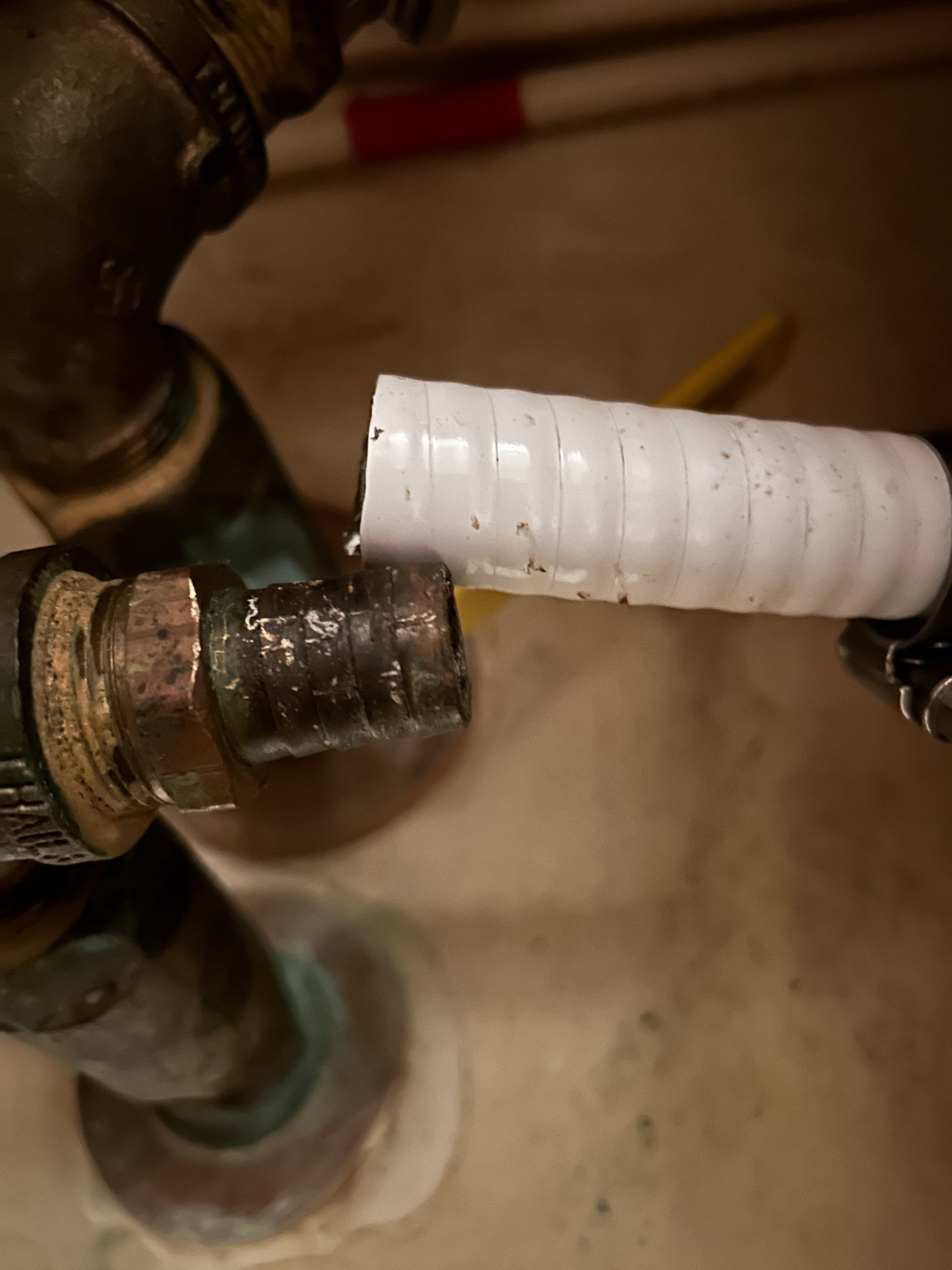

Today I just could not get the seawater water intake hose off the thru hull, to winterize the toilet. So I had to cut the hose to be able to pump antifreeze from the gallon into the toilet.
Has anyone modified their hose with a ”T” fitting or something else like it to be able to get antifreeze into the pump handle of the toilet?
My thought is if I had a way of connecting a hose to the line I wouldn’t have to remove it from the thru hull. It involved a whole lot of shaking on the thru hull to free the hose and I just didn’t want to do that.
I have enough play in the hose to be able to reattach it to the thru hull, the hose slid off the pump handle side easy enough. I used Super Lube on the hose fittings for just this reason but I guess not enough on the thru hull side.

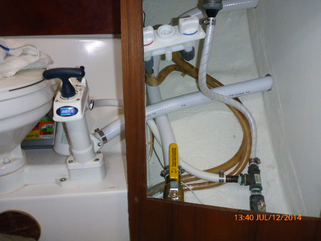

Run the sink drain down to the thru hull. In the middle install a T fitting. Open the thru hull, water from sink dumps overboard. Pump the head and raw water comes in from the thru hull.
Shut the through hull, fill the sink, and you can pump fresh water from the sink drain into the head. Fill the sink with antifreeze (first empty the water lines and the holding tank) and you could pump the AF. From the sink drain into the head.

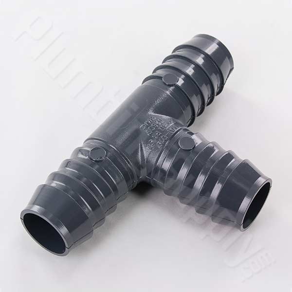

I have thought of putting a T in my engine intake hose for the same reason…very poor access to the clamps on the hose barb on my strainer. The T I was looking at has hose barbs on the 2 ends, and a hose thread with cap on the middle opening. So you remove the cap, and screw on a short piece of garden hose.
Something like this…
But, I haven’t done it yet…put up with bloody knuckles again this haulout.

You got it 99% correct. The tee in the sink drain needs to be as close to the seacock as possible to put it below the waterline to make it possible flush with sea water.
I got this idea from a Tartan owner in the mid-'90s..Tartan used to plumb their toilet intake lines this way. I liked it so much that I began recommending it as the way to flush the sea water out of the entire system--intake line, pump, channel in the rim of the bowl and the discharge line. pouring fresh water into the bowl only rinses out the discharge line. This not only provides a way to rinse out the entire system, it provides a safe way to flush with fresh water...just close the seacock and flush with water from the sink.

Sink drain thru-hulls are below the waterline on almost all sailboats. So disconnect the toilet intake hose from the thru-hull (close the seacock first!) and r-route it to tee or wye it into the sink drain line as close to the seacock as possible because the connection must be below waterline to work. You'll be left with an unused thru-hull that you can repurpose to use for a washdown pump and probably be able to shorten the intake line.
This will allow you to flush normally with sea water. After you’ve closed the sink drain seacock in preparation to close up the boat (you do close all seacocks before leaving the boat to sit??), fill the sink with clean fresh water and flush the toilet. Because the seacock is closed, the toilet will draw the water out of the sink, rinsing the sea water out of the entire system—intake line, pump, channel in the rim of the bowl and the discharge line,(Water poured into the bowl only rinses out the toilet discharge line). If your toilet is electric, be careful not to let it run dry…doing so can burn out the intake impeller. Or you can keep the sink drain seacock closed except when it's needed to drain the sink and flush with fresh water down the sink all the time...your choice.
It may also be necessary to keep the sink plugged except when in use, with a rubber sink plug or by installing a conveniently located shut-off valve in the drain hose. Otherwise the toilet may pull air through the sink when you try to flush, preventing the pump from priming. To add antifreeze to the system, make sure the sink drain thru-hull is closed and pour it down the sink.
Just flushing antifreeze through the toilet does not protect the pump or the bowl because anything poured into the bowl just goes out the discharge line, it does not circulate through the intake line, pump and channel in the rim of the bowl. If you're still using the toilet intake thru-hull, disconnect the intake line from it (close the thruhull first!)...stick it into the jug of antifreeze and flush the toilet.

The couple of tee's shown above look like plastic or maybe nylon. Are these okay for below water line use?
Dec 2, 1997
9,011
- - LIttle Rock
Nylon is fine for below decks use. but it has no UV resistance...exposure to natural light turns it into powder. So whether it's acceptable for exterior use below-waterline depends on how far below waterline and whether heeling can expose it to daylight. Marelon or schdule 80 PVC would be a much better choice.

Thanks. I'm talking about interior below waterline use. To clarify, is it okay to use a nylon tee below the waterline between the seacock, the intake line and the sink drain?
Jun 11, 2004
1,933
Oday 31 Redondo Beach
There's very little if any UV damage to anything INSIDE a boat...You can use nylon anywhere below decks.
--Peggie
Thanks. For some reason I thought nylon hose connections were not suitable for below waterline use. Not because of UV degradation but because of strength and crushability.
