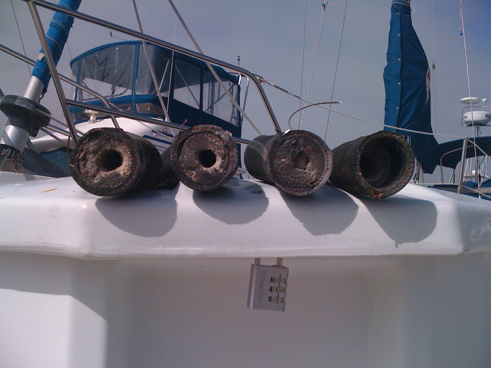

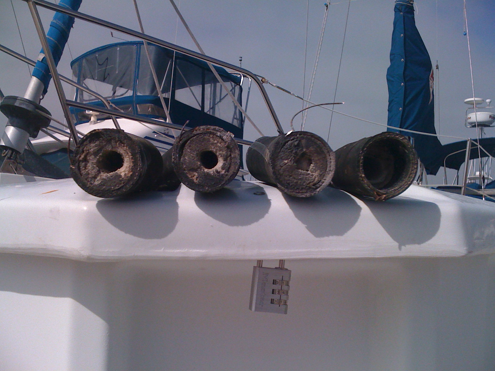

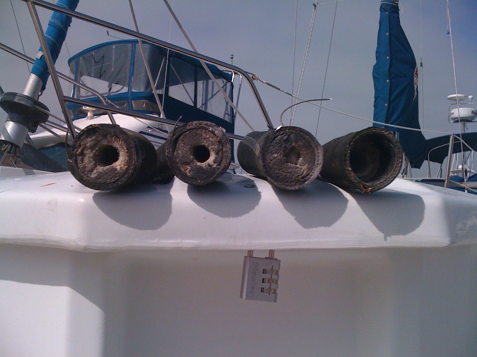

You've prob'ly answered this question in an earlier post, but....is it is an uphill run from your toilet to your tank?
Whether it is or not, have your removed the toilet discharge fitting to check the joker valve and also the inside of the discharge hose for sea water mineral buildup? Left untended, that can reduce the diameter of the hose enough to create some back pressure. In warm waters it it doesn't take long. The attached photo was posted either here or on one of the other sites I monitor a couple of years ago by a Catalina owner. Those hoses are 1.5" and smaller.

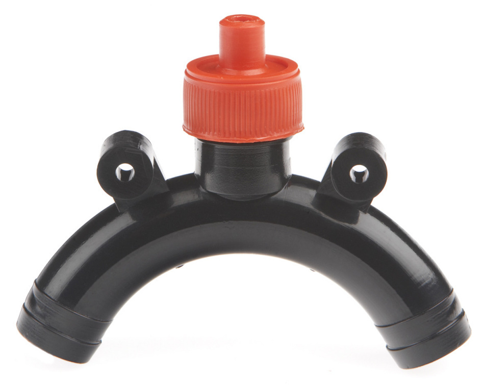

The 'vented top' in the top of a vented loop is a nipple with a threaded hole in it that's molded into the loop, into which an air valve is installed. The air valve is replaceable, the nipple isn't. So unless you put a plug in the nipple, there's no way to turn a vented loop into a sealed loop. No one makes such a plug.
The photo is one example of an air valve in a vented loop.
The air valve opens to let air into a line when liquid is being PULLED through it...that's how it breaks a siphon. It remains closed when liquid is being PUSHED through the line to prevent water from squirting out the top of the loop. Which explains why the vented loop has to be installed between the pump and the bowl...if it's between the thru-hull and the pump, it interferes with the pump's ability to prime, When installed on electric toilets that don't have a line connecting the pump to the bowl, an electric solenoid air valve that's connected to the flush button must be installed. The solenoid closes the air valve when the flush button is operated, opens it when the flush button is released.
