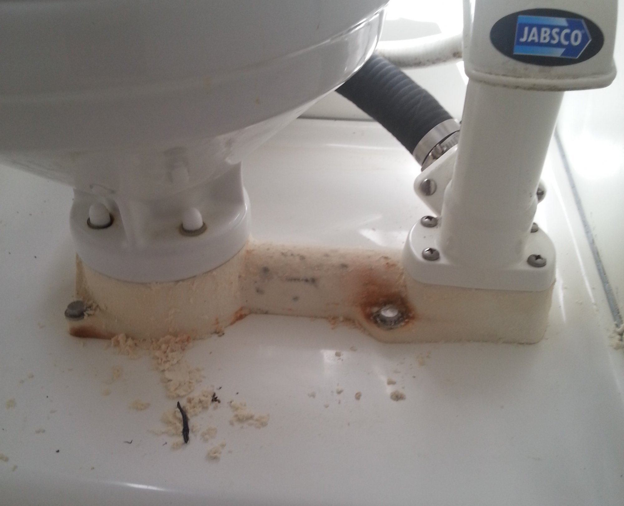

I have a 2004 Beneteau 311. The toilet attachment base (I'm not really sure what the proper term is so I've attached a photo) is going powdery and probably should be replaced; (I guess?). It's bolted to the somewhat raised head floor there is no access that I can see to get to the underside of the bolts does anyone know if Beneteau used nuts on the other other side or are the bolts screwed into a tapped metal plate?
I'm looking at the Defender catalog and I don't see where this part is even available nor does it seem to come with a new toilet, hopefully I'm mistaken and someone can set me straight.

Toilets are often lag bolted to the floor. Just remove the lag bolts.
Jabsco heads are inexpensive and the cost of rebuilding is relatively high. Replacing the head is probably a better option. If you go that route, consider an upgrade to a Raritan PHII. It is a much more robust head and pumps more efficiently. Search for posts by @Peggie Hall HeadMistress she recommends them (and I think there is a newer model).

All marine toilets including Jabsco mount using lag bolts...no nuts.
You could just replace the base..that would be the least expensive solution.Paul Campagna is Jabsco's toilet guru..his direct line is 978.282.5246
BUT...if the toilet is original or even more than about 5 years old you'd definitely want to replace the pump too. But if you're gonna have to remove the whole thing to replace the base and the pump, you have a perfect excuse to upgrade to the toilet that's been top-rated since it was introduced in 1982--the Raritan PHII. The newest version has a redesigned base that makes it a plug 'n' play replacement for your Jabsco...they've renamed it the PH SuperFlush Raritan PH SuperFlush Also available as a "Conversion" that lets you re-use your existing bowl, seat and lid. Cost isn't a lot less than the complete toilet, but without a bowl , shipping costs are a LOT lower. Check sbo.com to see if they have it, if not Defender does, with both standard (small) and household size bowls.

Thank you for the information. While I'm taking it out I may as well install a new Raritan PH Super Flush as I am getting some drain back from the holding tank and as Peggy said I need a new pump.
The inlet on the tank is at--or on--the top of the tank and tank contents can't jump. So what's running back to to toilet isn't likely to be from the tank unless it's full to overflowing or it only happens when the boat is heeled hard over on that tack. So what you're seeing is waste in the toilet discharge line that isn't making it INTO the tank. A new toilet won't solve that problem, 'cuz if you've only begun experiencing backflow recently, that's a strong indication of a blocked tank vent.
All tank vents have two main functions: to provide an escape for air displaced by incoming contents and provide a source of air to replace contents as they're pulled out. When air displaced by incoming waste cannot escape out the vent the tank becomes pressurized, creating increasing back pressure that prevents the toilet from flushing,
The two most common locations for a vent blockage are the vent thru-hull and the other end of the vent line--that end of the hose and the vent fitting on the tank. Start by cleaning out the thru-hull...use a screwdriver blade, ice pick--whatever works. If there's a screen in it, knock it out...screens cause more problems than they prevent. If that doesn't result in a spew out the vent, you'll need to relieve the pressure before removing the vent line from the tank to clean them out...so open the deck pumpout fitting VERY CAREFULLY with a hose at the ready. Be sure you're UPwind of it! Scrape out that end of the vent line and the vent fitting on the tank...replace the vent line.
As long as you're doing all this work, I recommend you replace the "vent" thru-hull with an open bulkhead or "mushroom" thru-hull. Not only will this allow a lot more air exchange via the vent, but you can prevent any future vent blockages by sticking a hose nozzle against it to backflush the vent line every time you wash the boat.
