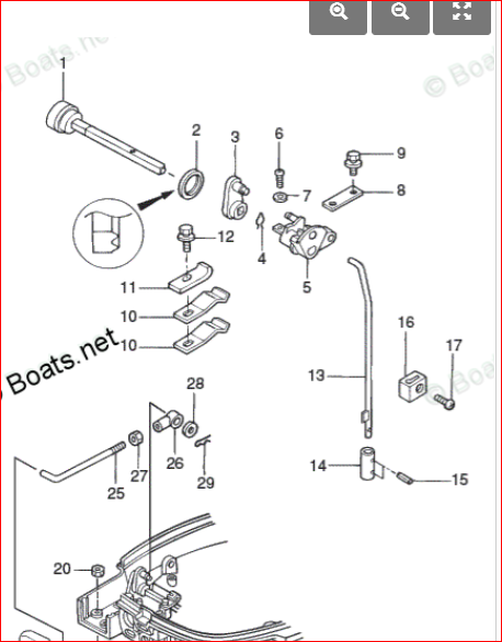

I'm not familiar specifically with Tohatsu's. But most small O/B's shift by using a mechanical linkage. To my way of thinking, it should come out of reverse immediately as the lever is moved to the middle neutral position. If you have a cable shifter controlling movement, it may not be adjusted correctly. If you're moving a lever on the engine something is not right (IMHO).
Has the lower unit been off to replace the impeller recently? It may be that the locking mechanism on the shift rod is slipping.
Item 16&17.

The lower unit hasn’t been off lately although did change the prop recently. I will definitely check that locking mechanism to see if it’s slipping or moving at all. Does it need to be in a certain location or just make sure it’s tightened down?

Usually the joining clamp is visible when the lower unit is unbolted, and dropped an inch or two (which is the travel of the shift lever and rod). If its sliding you should see witness marks on one of the shafts. The shift lever won't be straight up and down when in neutral.
