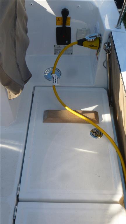

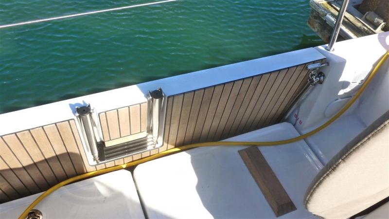

Here's another idea: I was on a new Jeanneau 349 yesterday (just happened to be next to us in our guest berth at another marina). Because the cockpit floor was dead flat, they installed these two big wooden blocks for foot support when the boat heeled. Personally I think it's an atrocious design, stupid tripping hazard, but you might be able to cobble something together on your foredeck where you think that your foot would slide out. Anything inboard of the toe rail would be MUCH easier to install, as I noted earlier.
