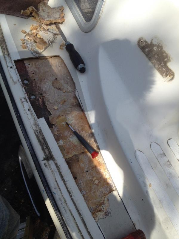

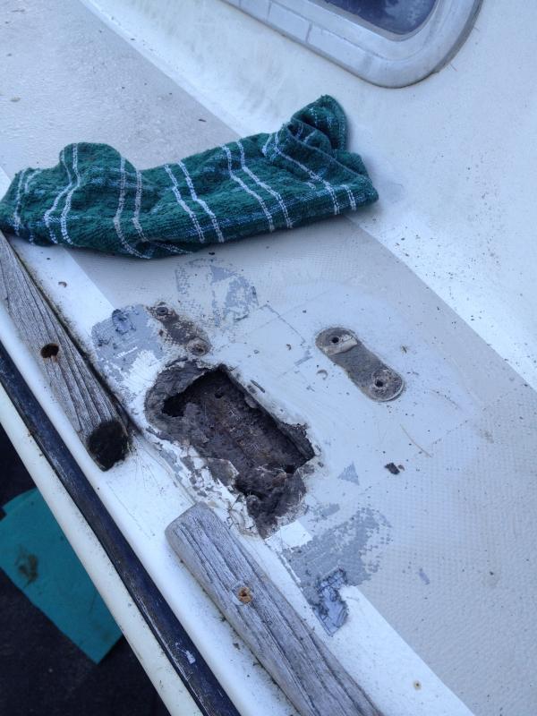

I haven't had time for an update lately - but I have removed some deck hardware and the toe rails - cut out the wet area of the deck and ended up with this for a hole:2014-08-17 15.03.50.jpg
There was a lot of good dry wood in the middle - the edges were wet - likely from the toe rail leaking - there was nothing under the stanchion base - completely rotted out.
If I can get some dry weather I will fill the hole - i have 1/4 marine plywood - I want the structural aspects of the marine ply under the stanchion base (if I decide to put them back up.) I had to remove everything from the inside of the boat - all foam, bunks, etc - I left the main bulkhead and mast brace - but everything else is out. Does anyone know what the brown gasket is and what to replace it with (see pic) 2014-08-17 17.54.03.jpg

If that brown gasket is just a trim piece to dress up the where the bulkhead meets the hull, someone on here recently showed how they used spare line as the trim piece. It came out pretty good.

I liked the rope idea for trim. You could also wrap rope with vinyl and use that. My wife found some flexible trim:
http://www.flexiblemillwork.com
It looks really nice. She said to look around and find good prices because it can be expensive. You can stain it and paint it too!
