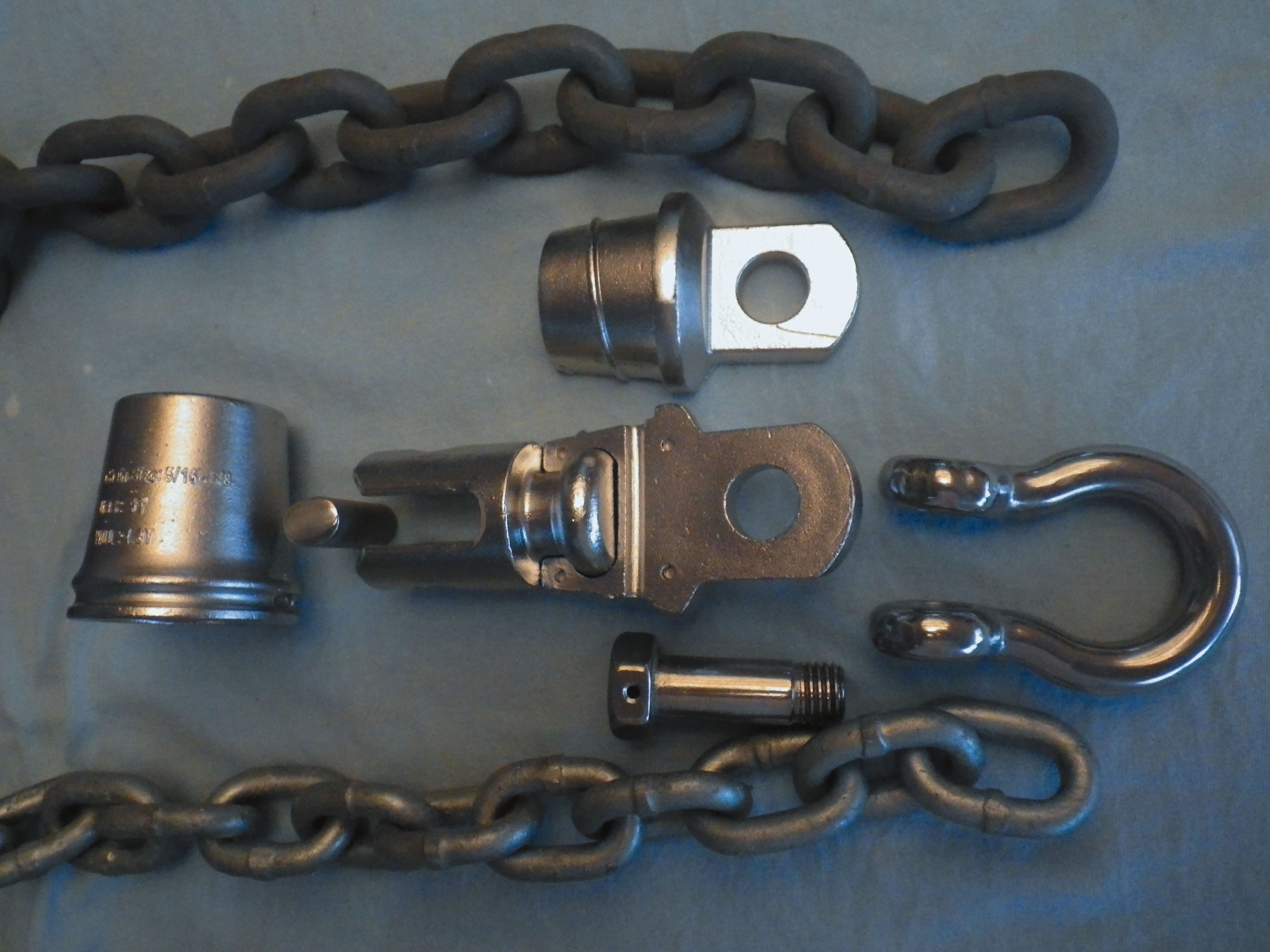

So I know the fears of the weakest link and I’ve always just said yea no way…… but I see the benefits and know of others that use them without issues.
We anchor whenever we are traveling….. 250 feet of 3/8bbb and rocna 25 (55lbs).
Hear the robustness of the mantis swivel is second to none…..
love to hear experience with to settle my nerves having this link.

I use the Mantus swivel. No relation to Mantus, just a happy customer. They aren't cheap. I did get mine at a discount at the Annapolis Boat show.
