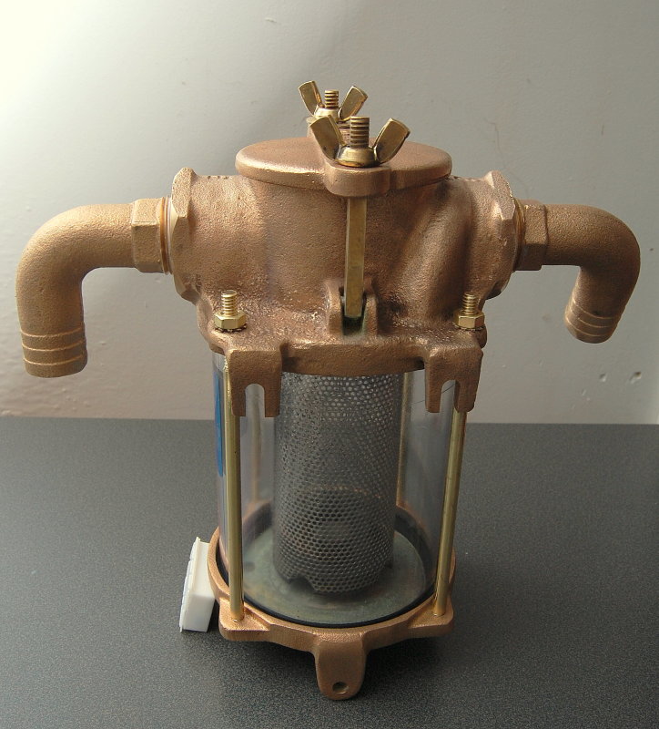

Watch the flea markets and eBay and you can often find the good old Perko or Groco sea strainers. The Perko's will outlast your hull and can be very easily rebuilt when needed..
Rebuilding a Perko Sea Strainer (LINK)
thanks MS for the advice..... i do like the old bronze stuff...it cleans up so well in my bead blaster and comes out looking like new again....i was lucky enough to find one down in Texas about 5 or 6 weeks ago in antisipation of this for my boat for $30.00 cash...with all i am doing to put this boat up to bristol ....i need all the advice i can get and the sweet deals too (lol)....
