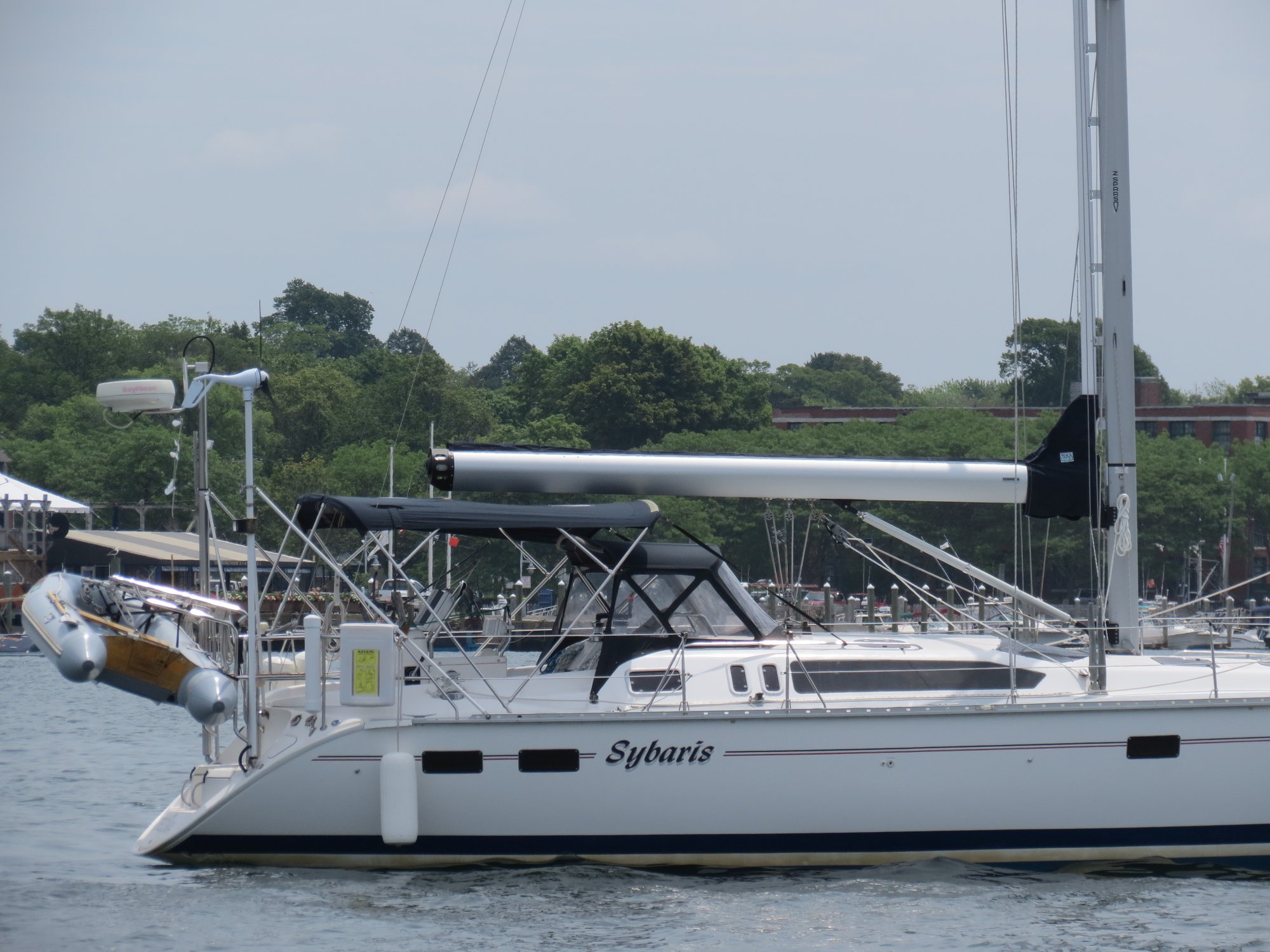

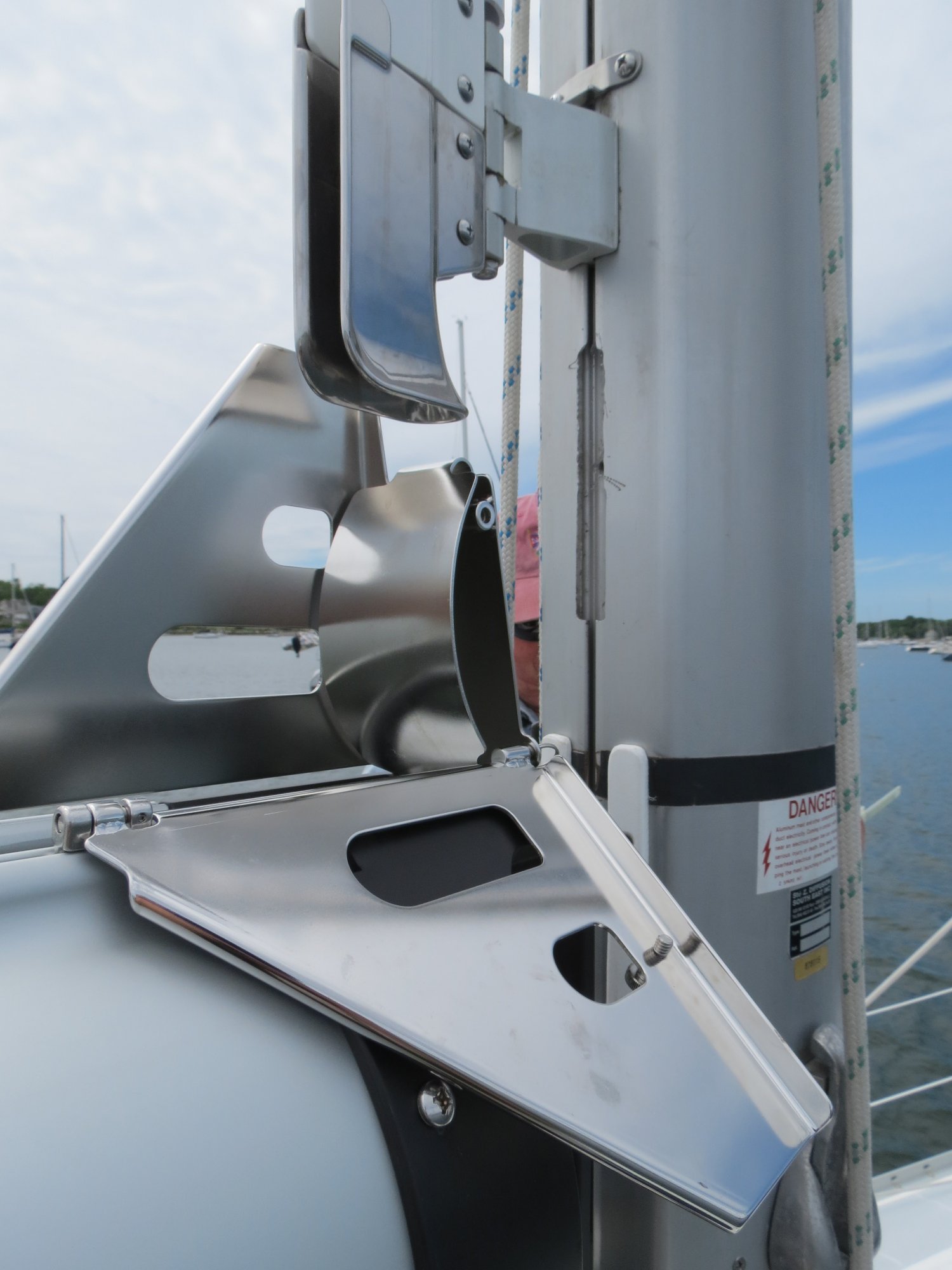

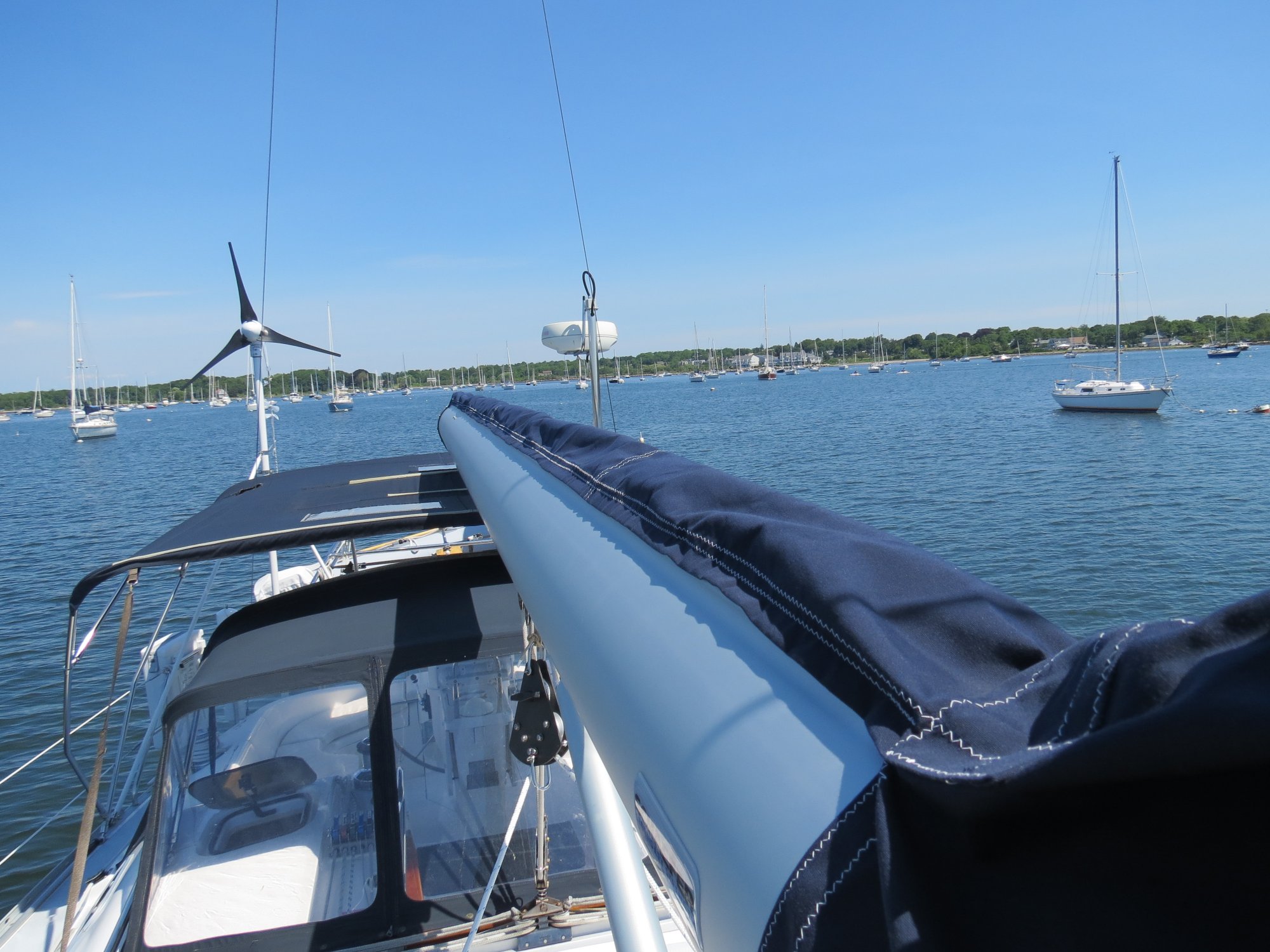

But I did convert my standard boom to a Schaefer Boom Furling about 5 years ago. My only regret is not converting 20 years ago.
If you have a choice, and you probably don't unless you buy a conventional system and then have a boom furler installed yourself, choose a boom furling system over a mast furling system. Of the two major furling systems available, the Leisure Furl and the Schaefer, both will offer the advantages of full battens, easy reefing at many convenient points (not infinite though), and should a jam develop you can drop the sail to the deck instead of dealing with a flogging half-in, half-out disaster. The sail cover just slides and covers the boom opening. This is super simple on the Leisure Furl and almost as easy with the Schaefer. My Schaefer cover comes off in under 2 minutes and goes on in under 4 minutes. And you don't need to climb over a bimini to do this.
After careful research, I chose the Schaefer system although it was a few thousand bucks more expensive. I saw the additional Schaefer advantages of reefing 45-60 degrees off the wind. It has an articulating sail track that rotates with the boom so the sail always drops straight into the boom with no bending. The sail track is also designed to eliminate sail jamming by taking the load off the sail luff.
The only downside I can see for either system is that you need an electric halyard winch to raise and lower the sail. That could be an additional 4K if you don't already have one.

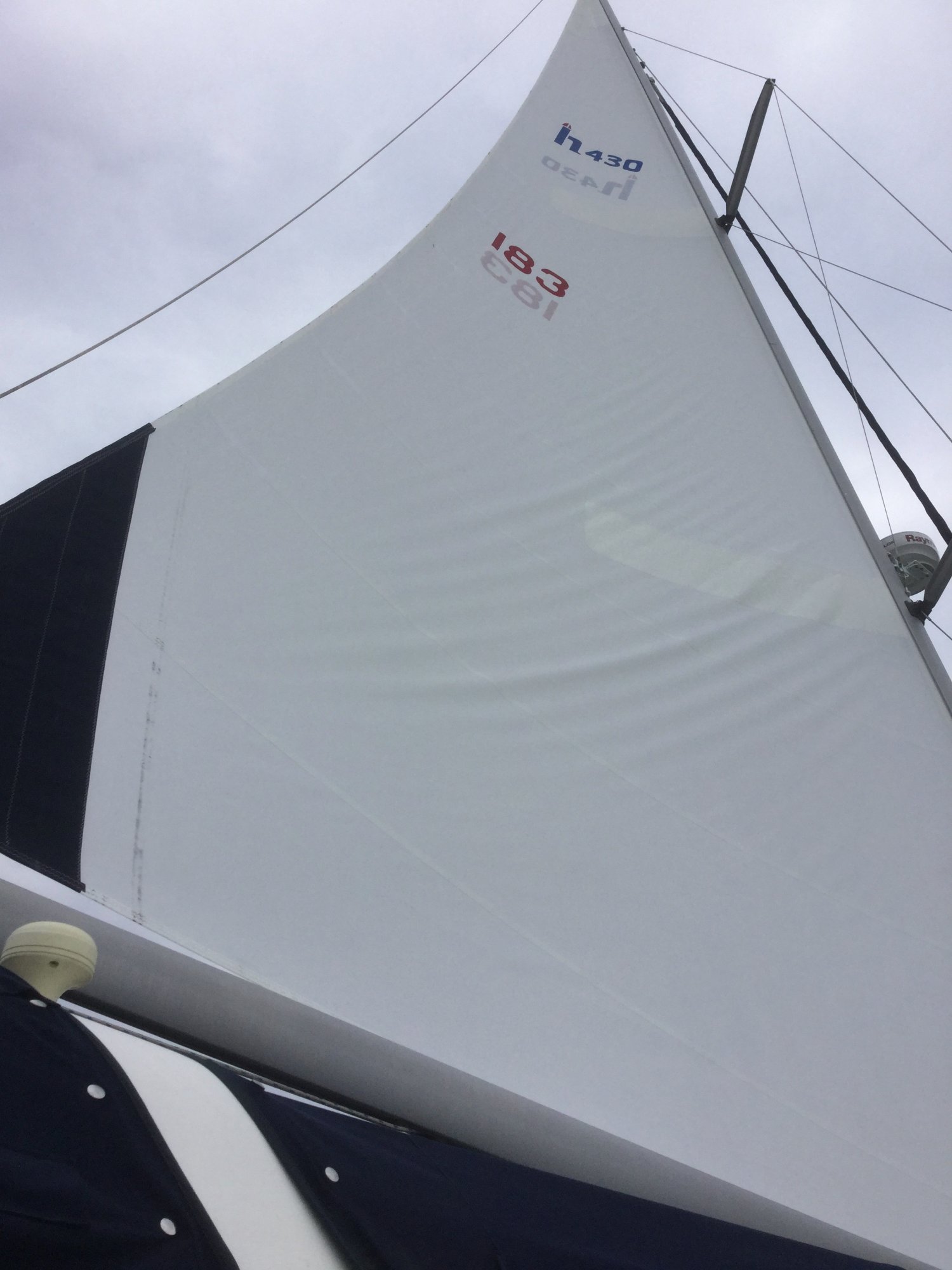

This is Luff part of a Main Sail sewn in by the Sail Loft. My Sail Maker came with samples to see which size cord he needed for my In-Mast Foil by ZSpars.
The Halyard runs inside the slotted Aluminum Foil or the spindle that your main wraps around.
______-
Inmast furlers do not jam any more than boats run aground; OPERATORS jam them!
We bought our boat and the in-mast was a new mechanism.
Guess what?
We, the Operators, jammed it.:angry:
Later, we realized our boat's main was OEM and 16 yrs old. It had stretched out near the Clew. Too much extra sail [at the foot] was being forced [jammed] into the mast, by the Operators.
Our new Main goes in and out, smooth as Silk, by trained Operators of the mechanism.:pimp:
Happy sailboaters now...
Jim...
PS: My ICON picture show how much extra sail we had so we didn't jam it, and our new main was on order then.
