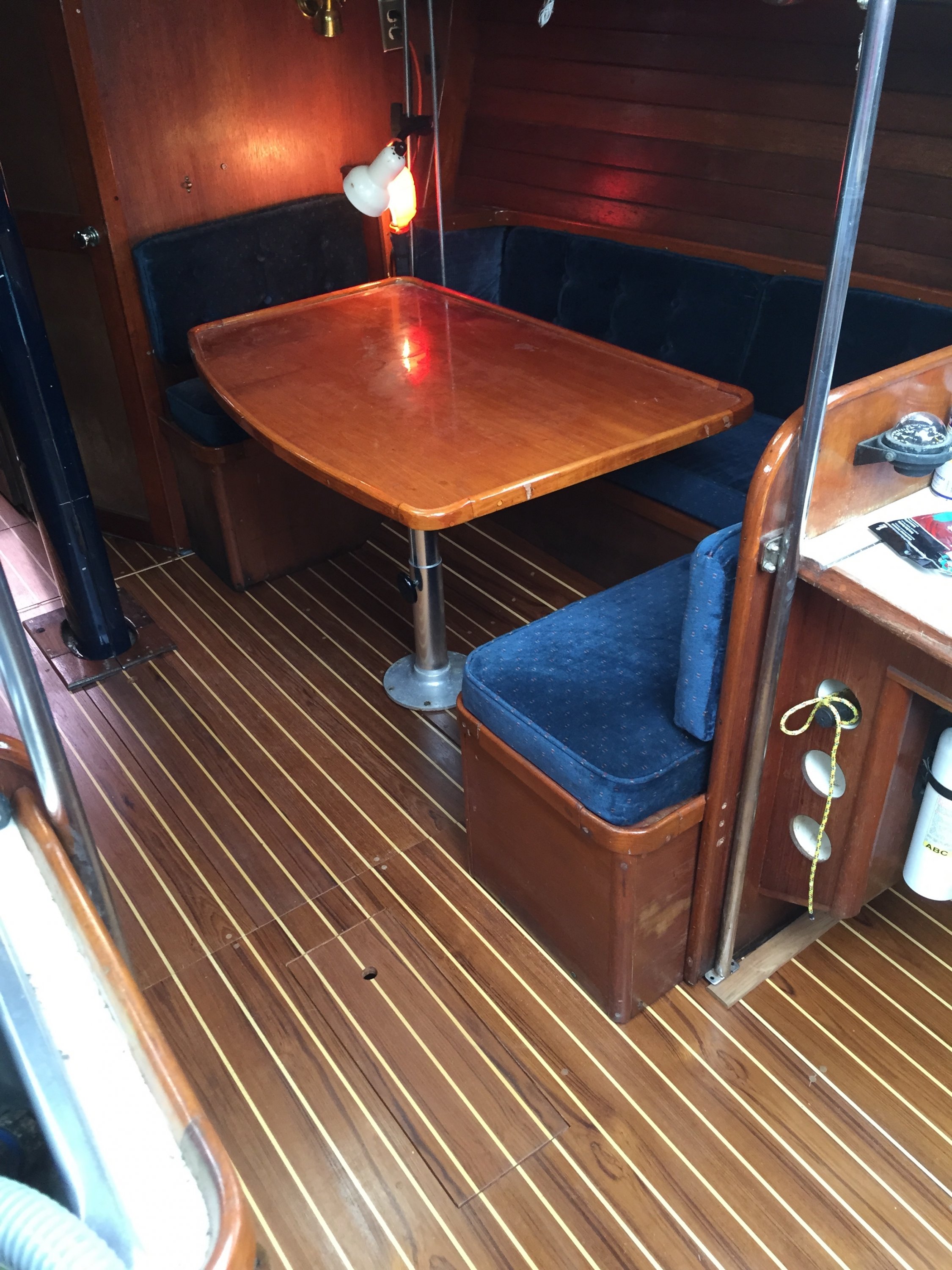

Going to replace and refinish some teak on the boat and am about ready to install the teak plugs.
My plan was/is to coat the plugs with varnish, pound them in gently and then use a wood chisel and/or sandpaper to bring the top flush with the surrounding wood.
Is that a good plan? Any tips would be appreciated. Thanks.
You are correct about the procedure. I replaced an entire cabin sole last year in my previous boat and bunged every countersunk screw head with a teak bung. As I had varnished all of the wood before installation I did not additionally varnish the bungs. Oddly they look as if they are varnished even without a coating. If you want to take that extra step I suggest that you use an artist's small paintbrush to do the job so that it doesn't mess up the varnish around the bung. The entire bunging thing goes very quickly especially if your chisel is sharp. If you're careful the chisel will flatten the teak plug perfectly and you won't need to sand it at all.
I've attached a photo of the completed floor project. The hardest part of that one was matching the white stripes from multiple pieces of teak and holly plywood. See if you can find the bung spots.
