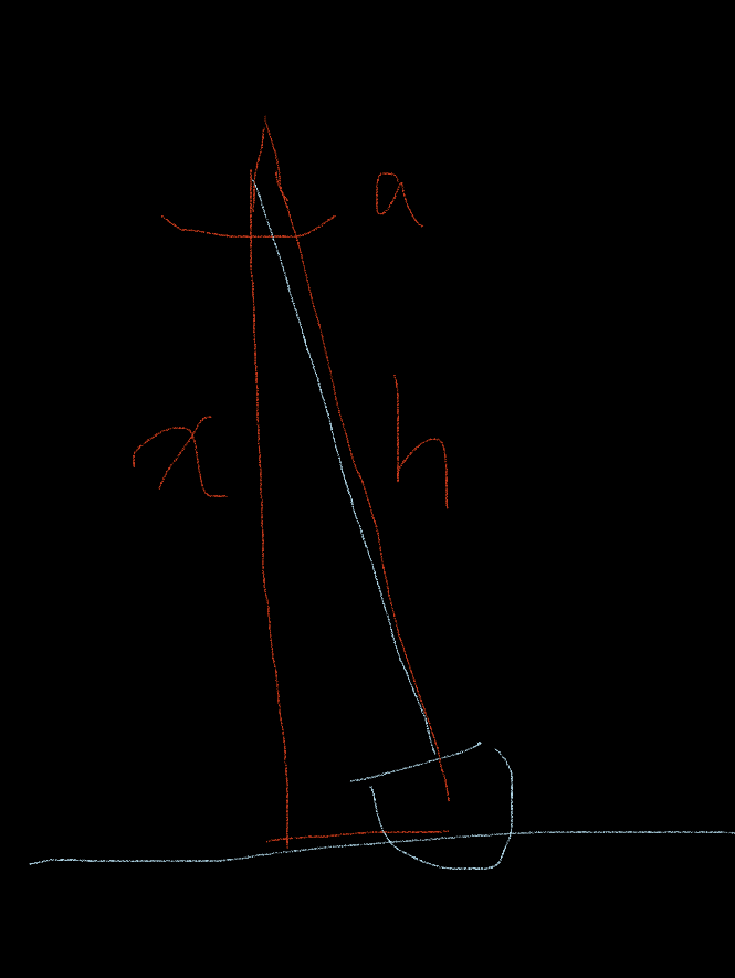

The geometry part isn’t so hard -
When you induce heel you’re making a right triangle, where the mast height is the hypotenuse and the heel angle is adjacent to the net height.
The cosine function tells us the net height (x) is 65 times the Cosine of the heel angle.
To solve for heel angle you need to reverse the equation: angle = inverse cosine (63/65).
By that math the angle needed would be 14.25 degrees.
The trickier part is knowing whether the model’s approximations are accurate. For example, does the boat really pivot right around the point where mast would intersect the water? Does the hull shape change the buoyancy either up or down making that point higher or lower?
