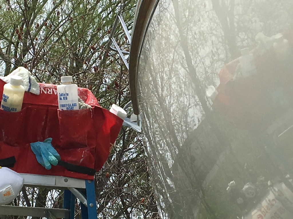

I've been using the Collinite products for years and have not had any issues with paint not adhering to the hull. Don't intentionally put the wax or cleaner on the hull below the waterline, just don't worry about a few over runs. Just wipe them off.
Usually I wash the topsides with Dawn, then use the Collinite Cleaner and then Collinite liquid wax. Every few years I will use a buffer and a polishing compound to remove any oxidation the cleaner didn't get.
This is a 25 year old hull, cleaned and waxed with Collinite and buffed out with a buffer.
