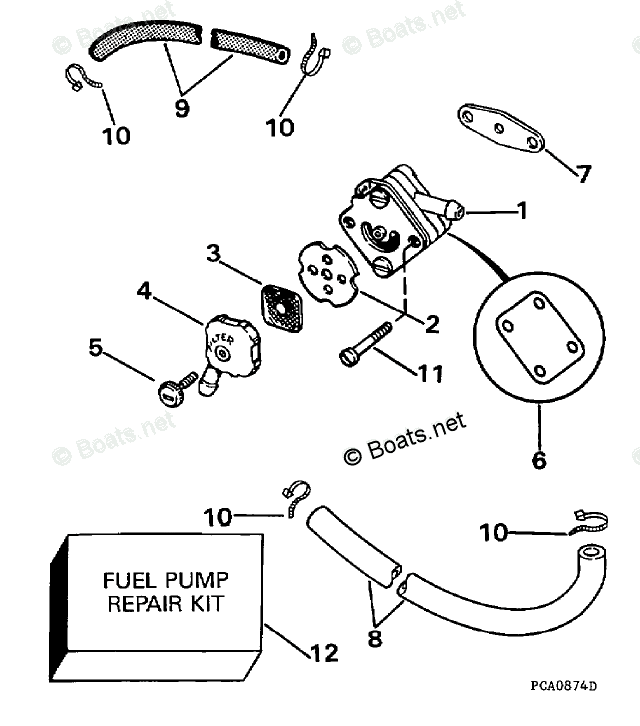

Last fall while "trying " to bring our Oday 25 in from it's mooring ,I couldn't get the outboard to start . The fuel pump cracked and sprayed gas every time I pulled on the rope .. Go figure .
It's the third fuel pump in four years .

Richard , by fuel pump I'm refering to the actual fuel pump mounted on the side of the motor . The plastic fittings for the hoses break off
