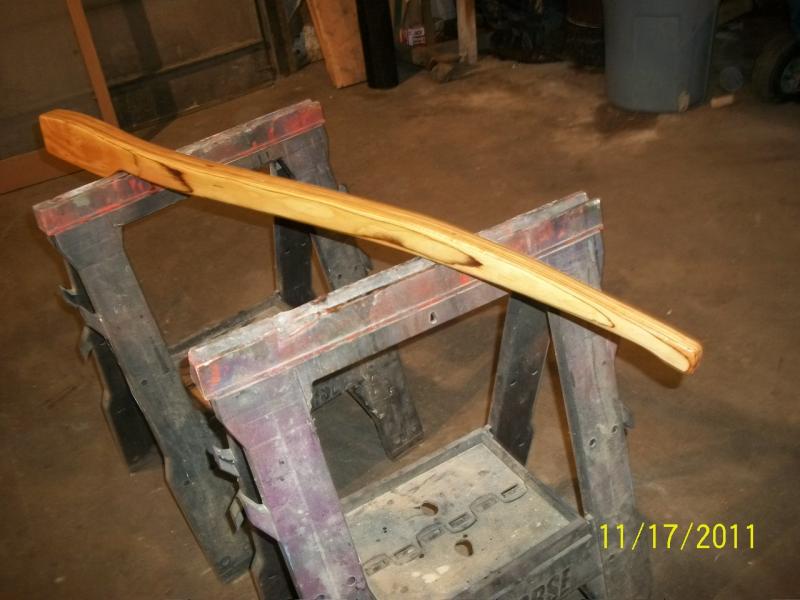

A few years ago I found myself laminating up a new tiller from scratch. While building it I was considering this subject.
My solution was to mill a /4" slot in the bottom of the tiller about 2/3 the thickness and within about 8 inches of the hand-end. I then cross-drilled the slot for a length of line to pass through. the location of the cross-drilled hole is critical, with a little over 1/4" of slot depth remaining over the drilled hole.
A 1/4" stainless eyebolt was fitted into the slot and a line passed through the drilled hole and eyebolt. This is where cross drilled hole location is critical. You want the eyebolt to go up in the slot enough to let the line slide easily when the eyebolt is "bottomed" in the milled slot. A
A large plastic knurled knob with 1/4" female threads was then screwed onto the eyebolt.
When the knob was tightened it pulled the eyebolt down, creating a clutch-like "jam" on the line. You could either lock the tiller tight or allow minor adjustment with the knob...
I really liked the design as it was robust, simple, and basically totally contained. No tacky bolt-on parts to mar the beauty of my homemade tiller either...
