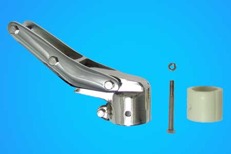

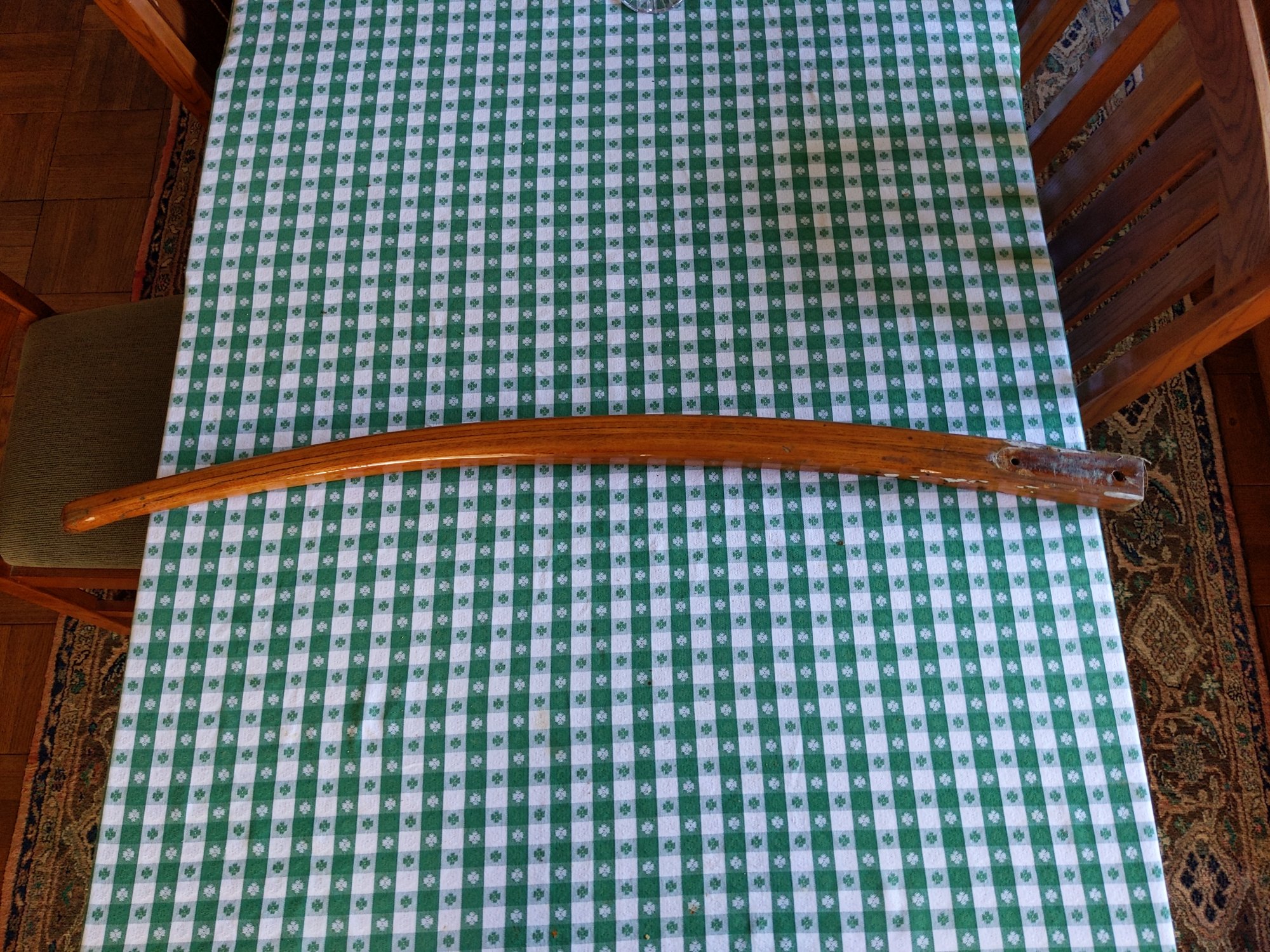

Here's what the factory pieces look like. The replacements are really expensive from Catalina Direct (the factory may be cheaper) $195 for wooden tiller, $850 for tiller head casting!!!! This fact may have driven the previous owner to come up with his own solution. Just sayin'. I looked on this website's parts list and they sell the tiller for $139.

That's not a Cat 27 tiller. It looks more like a C 30. Too much curve. The C27 is straighter at the base. Get some cardboard to make templates and start designing. Do a search for "small boat tillers" for ideas and dimensions.
