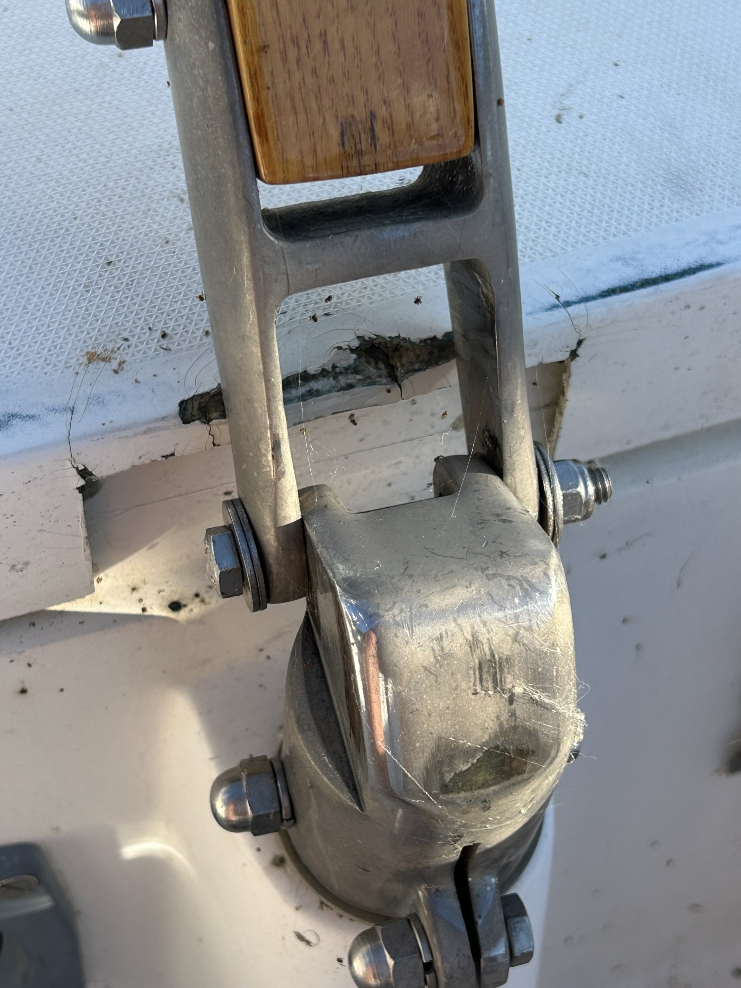

Tiller mount damages fiberglass
May 7, 2023
85
catalina 27 lake st clair
See photo. It seems like my boat is missing a piece that keeps the tiller mount from hitting the
8,008
I've seen stainless chafe guards used in areas where sheets have worn through the gel coat - not something very unusual in older boats. I would think that would work there. You might need to do come repair work first.
14,021
This is when the tiller is in the stowed position?
To answer your question, probably not. However you could fabricate a piece of wood or some plastic like Starboard to protect the glass.
Sep 24, 2018
4,530
Catalina 30 MKIII Chicago
I would use some L channel plastic. Preferably with UV inhibitors built in. It would hide the damage
Mar 6, 2008
1,498
Cut the fiberglass back such that the tiller does not rest on it when laying aft. You can strengthen the edge by glassing several layers of glass from underside and painting.
