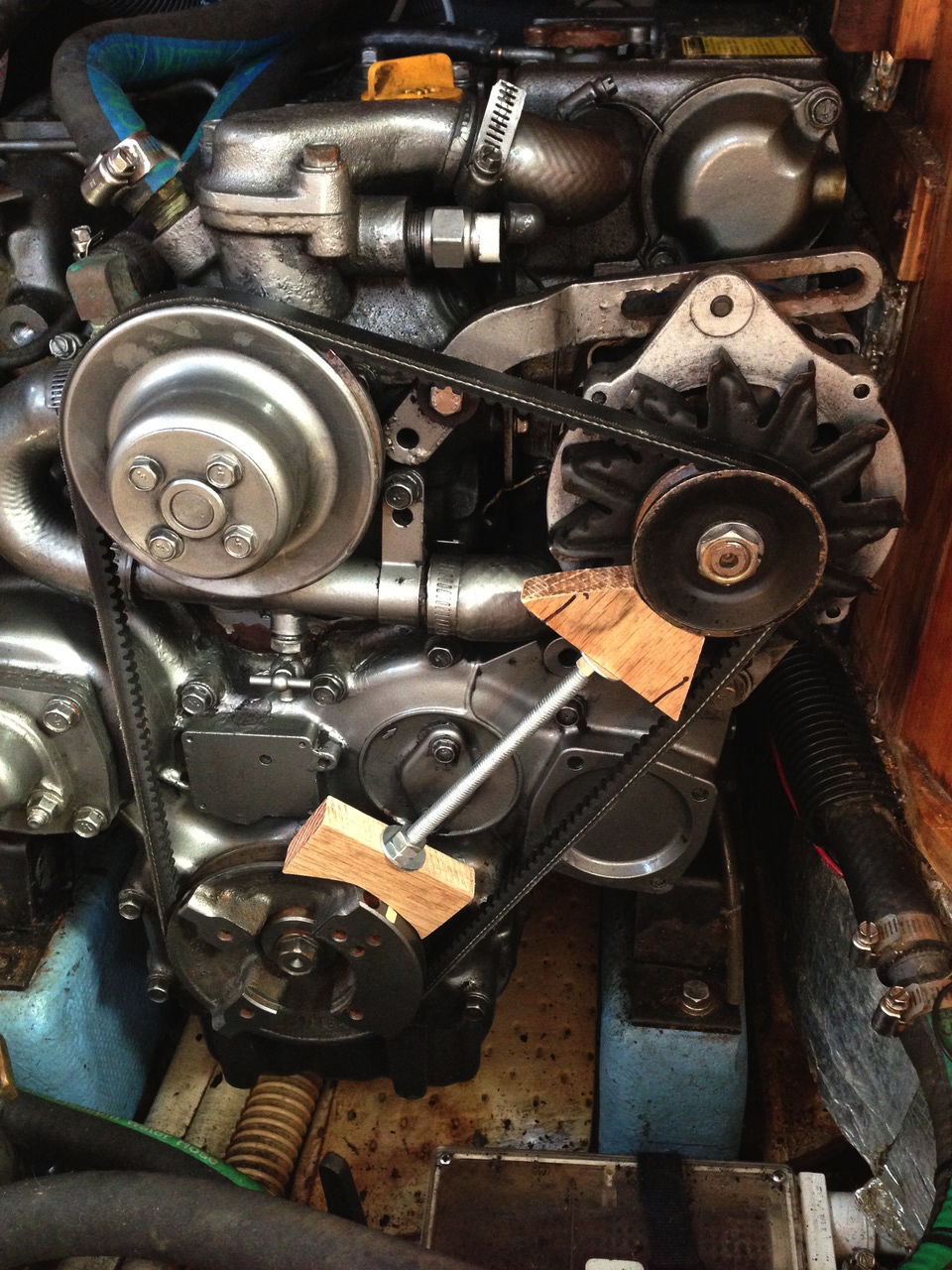

Have a few pieces of oak or other hardwood lying around? A piece o all thread and a few nuts and washers? Make your own custom belt tensioner.
This Lochner guy seems to know some useful stuff! ;-) I just replaced my alternator belt yesterday and came here looking for a tensioning solution. This wood and threaded rod tensioner is easier for me than modifying a turnbuckle. I'll make one this week! I'm also going to change my alternator belt when it has less signs of wear in the future. The old (and cracked) belt just brought me through 2 hours of 20 knots on the nose and nasty chop. The whole engine compartment and lazarette are full of black dust. I'm grateful for its service, but sure would not have been happy if it had failed at that time.

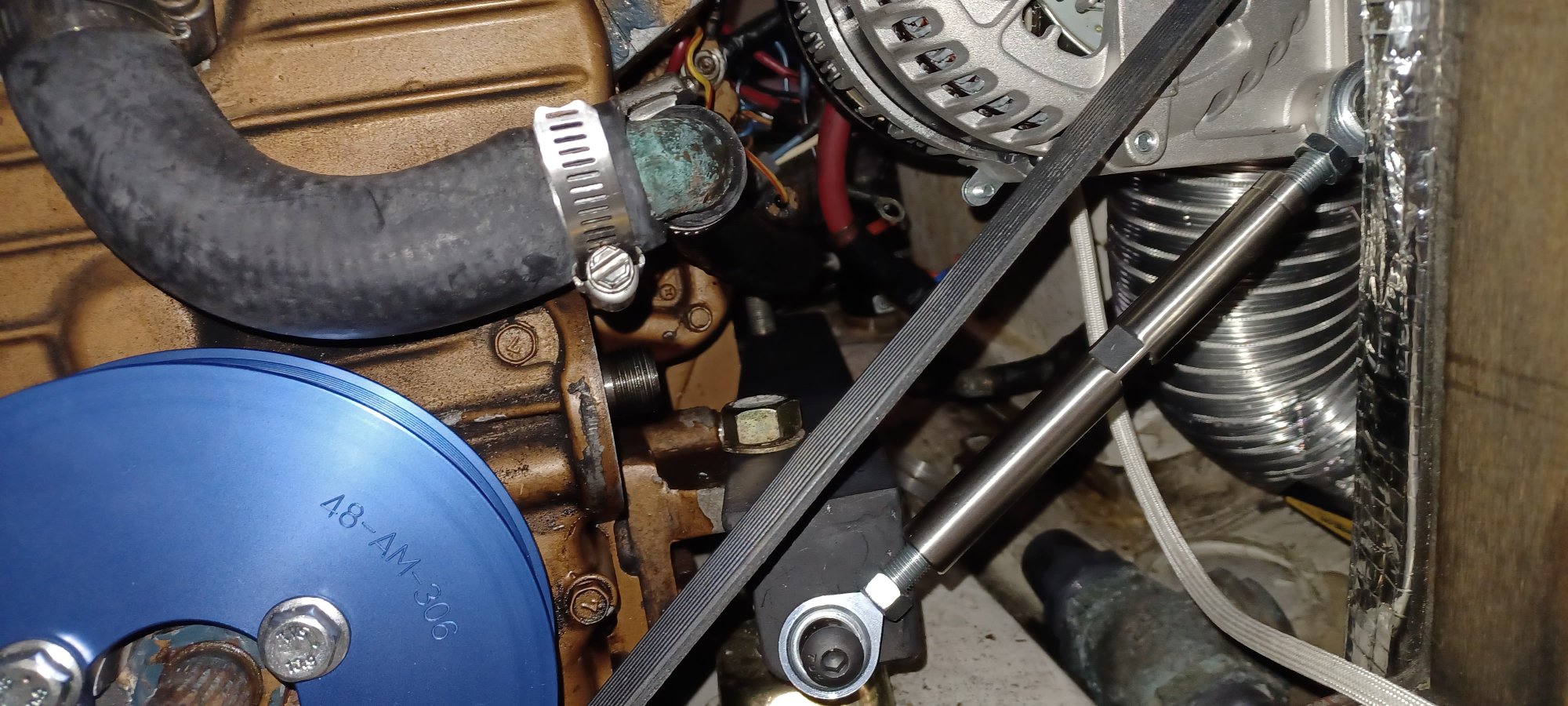

I think ultimately something like this is what I'll need to do because I've found that even when I do finally get the right tension on the belt and tighten down the bolt on the alt bracket and even put some lock-tite blue on it, the vibration from the engine loosens again after a few weeks.
I ran into the same problem when I went with the serpentine belt kit for my high-output alternator. The Engineer in me also struggled with the geometry of the tensioner. I ended up making a ne tensioner support out of a piece of 2"x2"x1/8" angle and this got the new Heim tensioner at 90º to the alternator pivot bolt. It is mounted to the motor mount bolts over the engine brackets.
