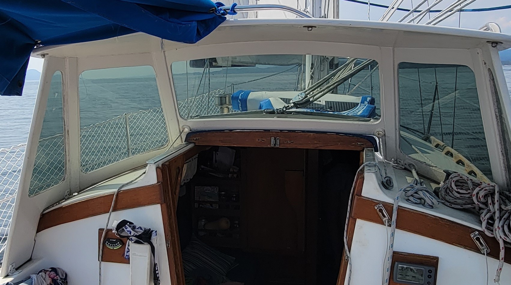

I haven't but my first thought would be, since the cleats are on opposite side of the companionway, how do you avoid the line getting in the way of entering the cabin? I installed Spinlock XPR cleats positioned so I can flick the line to cleat and unclear. I can do it from the helm if necessary.

Sorry i dont have any better pictures to hand. You can see the horn cleats and traveller lines either side of the hatch rails.
And please excuse the luffing genoa and messy halyard storage - this picture was taken before i knew any better!

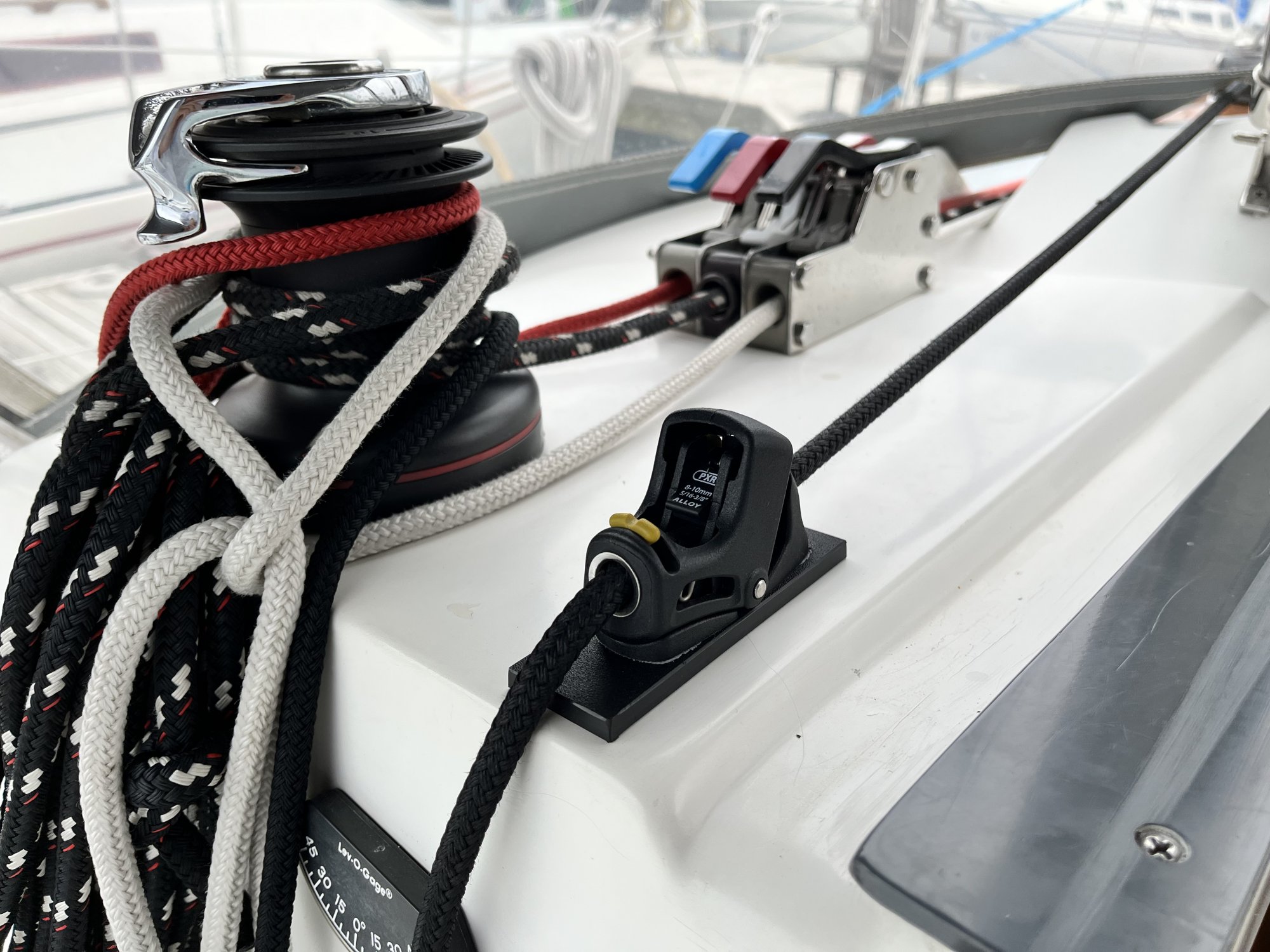

Oh, I agree, those horn cleats have to go. I find the Spinlock PXR cam cleats are much easier to use than regular cam cleats which require slight unloading to un cleat. A flick of the wrist is all that is needed with the PXRs.

There are methods to have a single line traveller, however they come with their own set of problems. They work best when the traveller is in the middle of the cockpit. In your application, they won't really work well, because as @Ward H notes, there is no convenient place for the traveller line to run without getting in the way.
