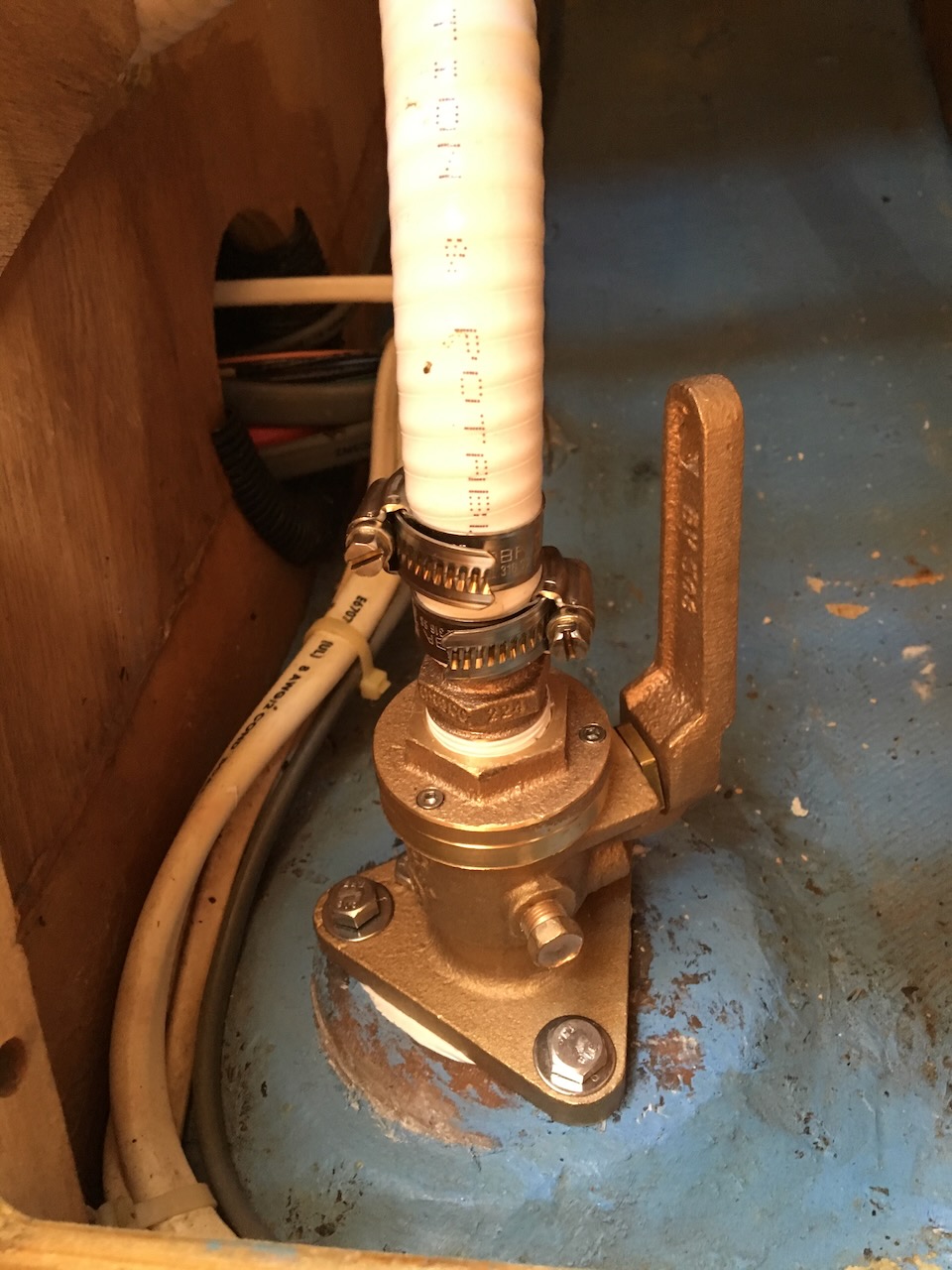

But @dlochner , does your boat have flanged thru-hulls or no ?
Yes. Groco Flanged Ball valves. Original from the factory. Unfortunately they were not installed in photogenic positions. Here's one for the head sink, the most easily accessible one.
I did replace one valve because a seal had begun to weep. It was not going to be a catastrophic failure, it just an annoyance. It leaked about a gallon a year if that. It was accessible so I just kept it closed except when being used.

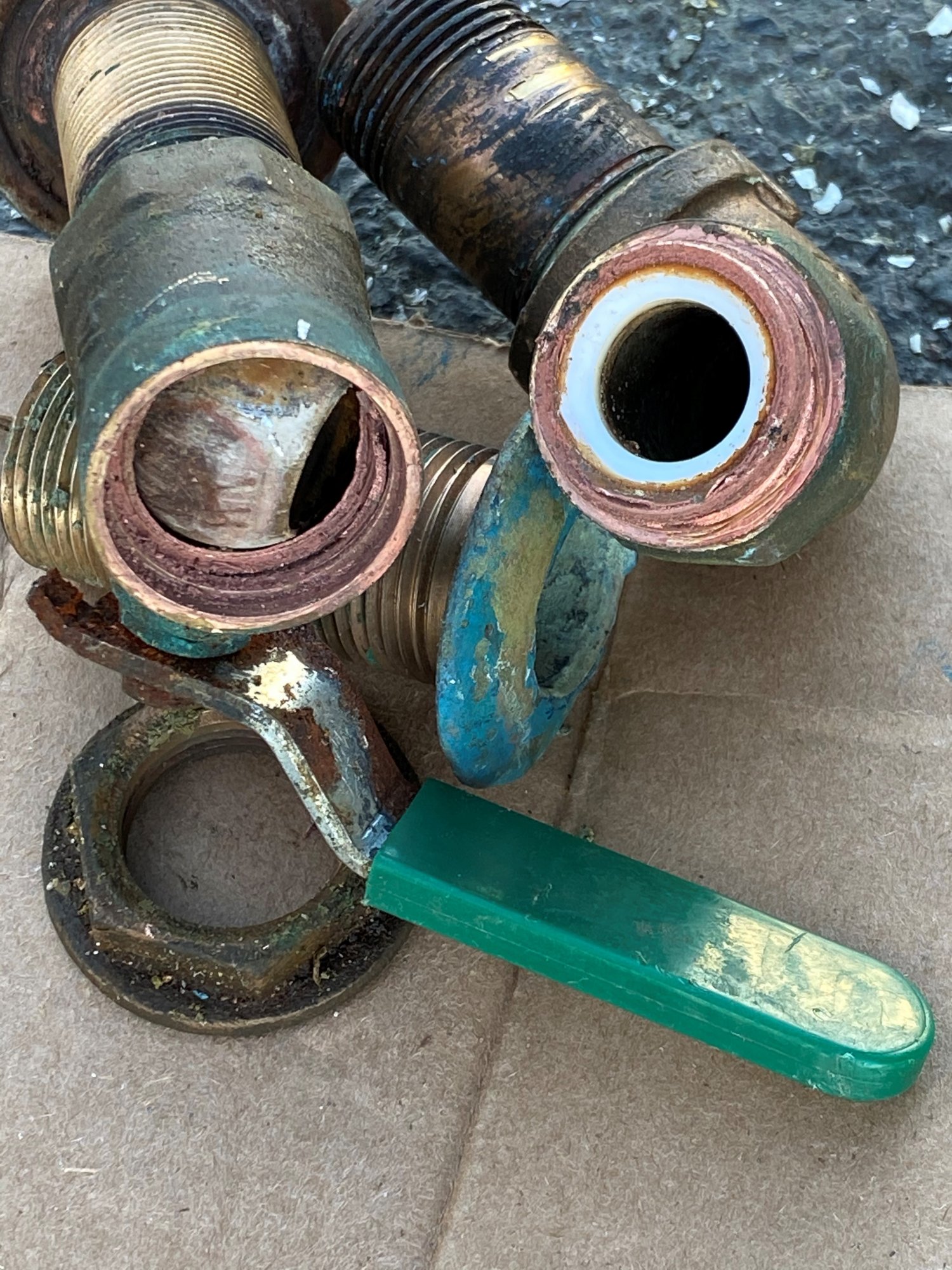

My example: The raw water seacock on my boat, age unknown at time of purchase. Seacock worked with out need for force and was serviceable right up to the point when I removed it.
Attempting to remove the valve from the thru hull fitting, the valve broke in to two pieces (as seen in the image). The pink metal shows that the valve had experienced galvanic corrosion from the inside.
Regular inspection and control of galvanic corrosion aboard your boat is critical to continued safe use. If you do not know the age of your valves or their quality, it may be time to replace them.
