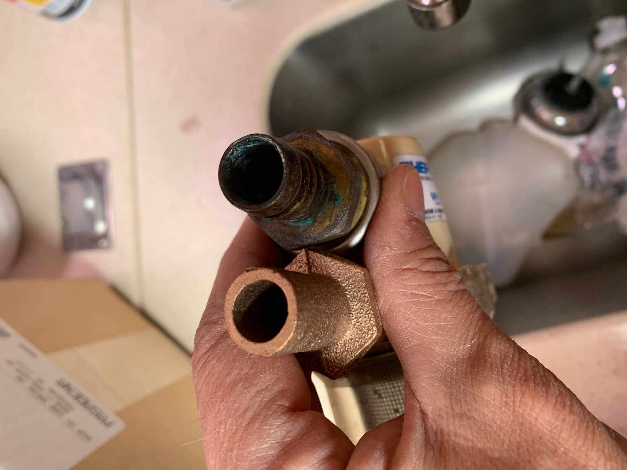

Just for interest sake: here's the difference between the old brass fitting (5/8" hose barb to 1/2" MPT) used on the outlet of the strainer and a new bronze fitting by Buck Algonquin. BTW: this was pretty much the only bronze fitting I could find for these in/out sizes. The difference in thickness on the hose barb end is probably much more than it is on the MPT side.
