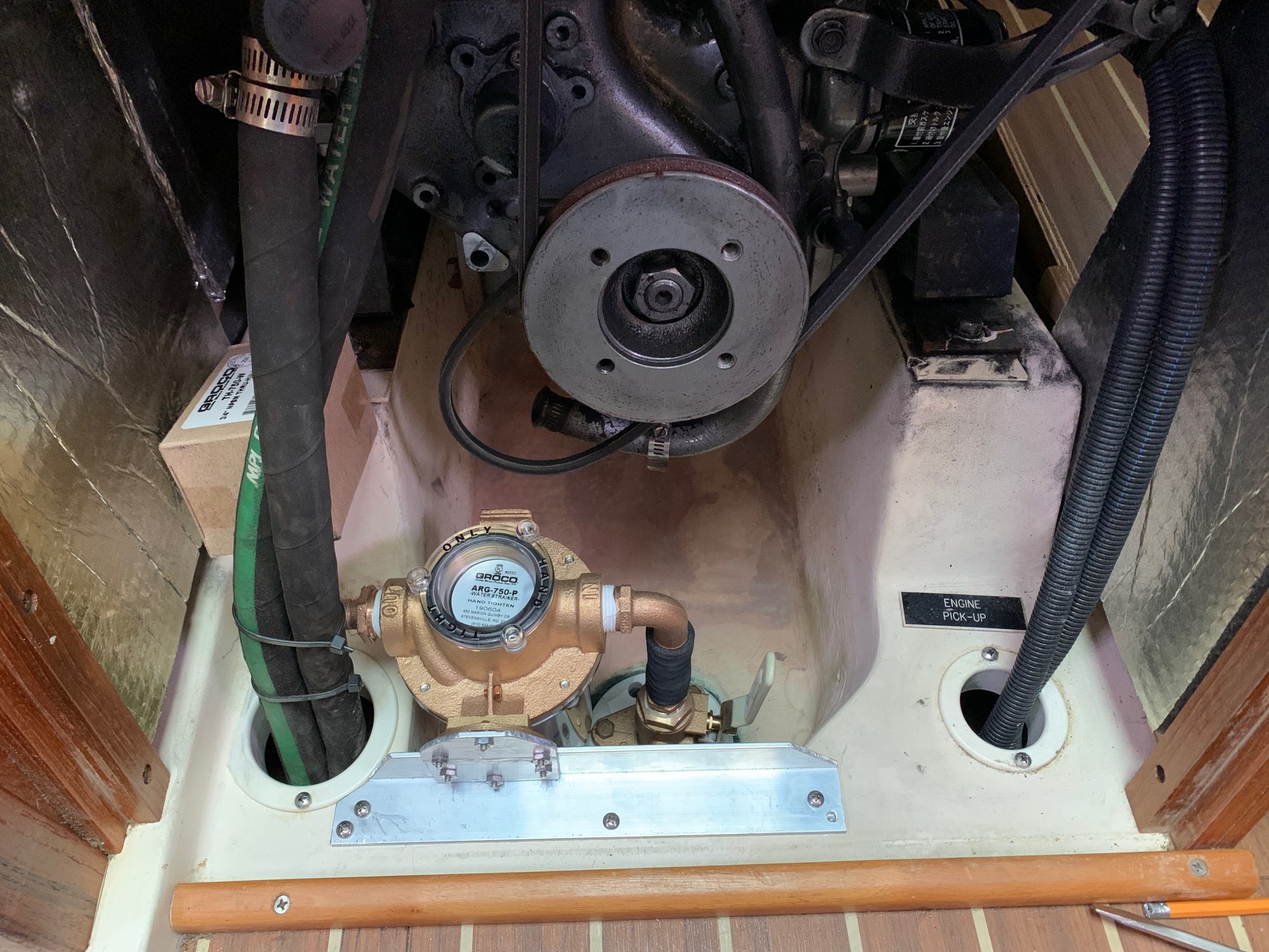

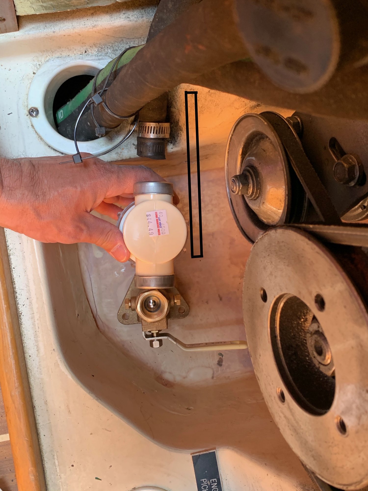

Yesterday, I played around with how to mount/orient the new strainer. On the one hand, I have "lots" of room and good access. On the other hand, using bronze 90 degree elbows, you quickly run out of room. My first thought was to mount the strainer to the side of the engine pan, b/c it's a good solid location and I have plenty of room. But the hose routing may be awkward: lots of 90 degree bends in a short space. My second thought is to mount it roughly where the old strainer was located, but fashion a mounting bracket which projects out into the pan as drawn onto the next photo (Here, I'm holding the Sherwood strainer, which I've since returned and ordered a Groco ARG-750):
This location would be very easy w.r.t. hose routing, but has the disadvantage that it involves a weird cantilevered mounting bracket projecting out into the engine pan. If I use very stiff steel (something like square tubing w/ holes, or an L angle), it would work, but is still a bit weird.
My third thought is to go back to my first thought, and see if I can just mount it on the front of the engine pan (the left side of the photo) and see if I can make the hose routing work. Or possibly on the starboard side (top of photo). The head of the strainer would be considerably above the top of the engine pan, but that first run of hose from the seacock to the strainer would be very tight. Leaning towards trying to make this work to avoid the odd cantilevered bracket.
14,187
It is best to have the strainer below the water line. That will make it easier for the pump and reduce the time it runs dry at launch. If you do mount the strainer above the waterline, add water to strainer and fill the intake hose with water before starting the engine.
Locating the filter higher may give you more options. Sweeping turns with hose allows better water flow than 90° elbows.

Any of these locations are without a doubt below the waterline. The thru-hull is at the hull, and the strainer will be at most a couple of inches above the hull.

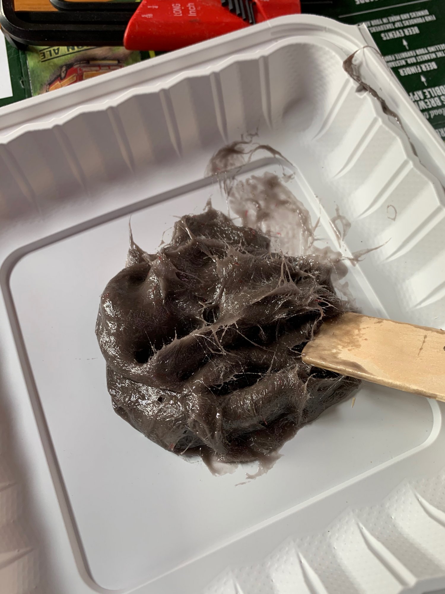

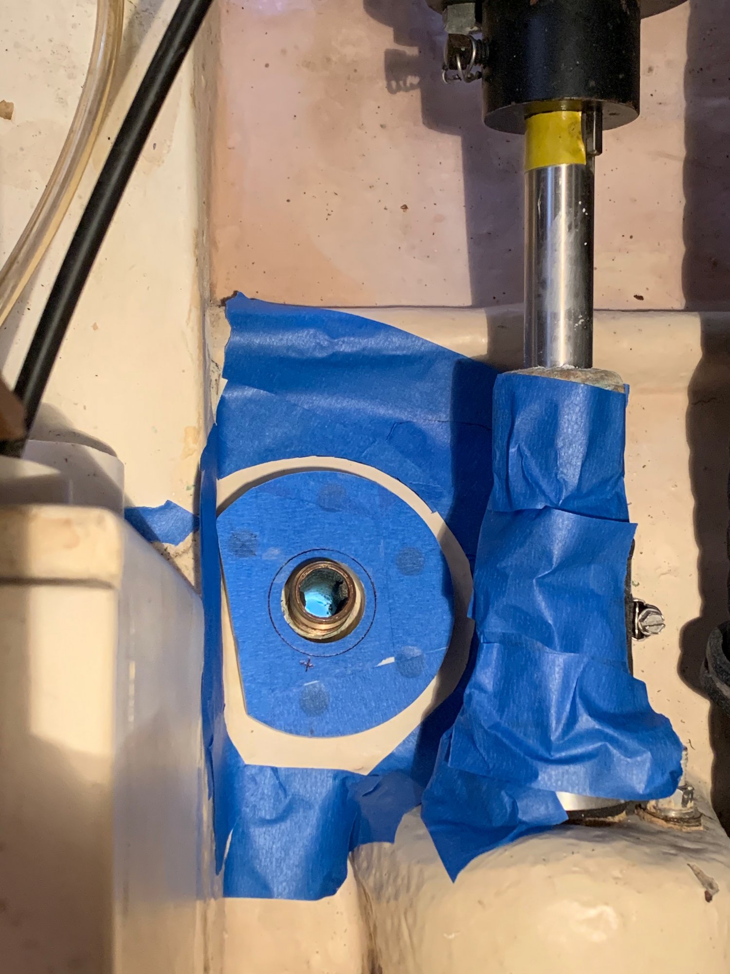

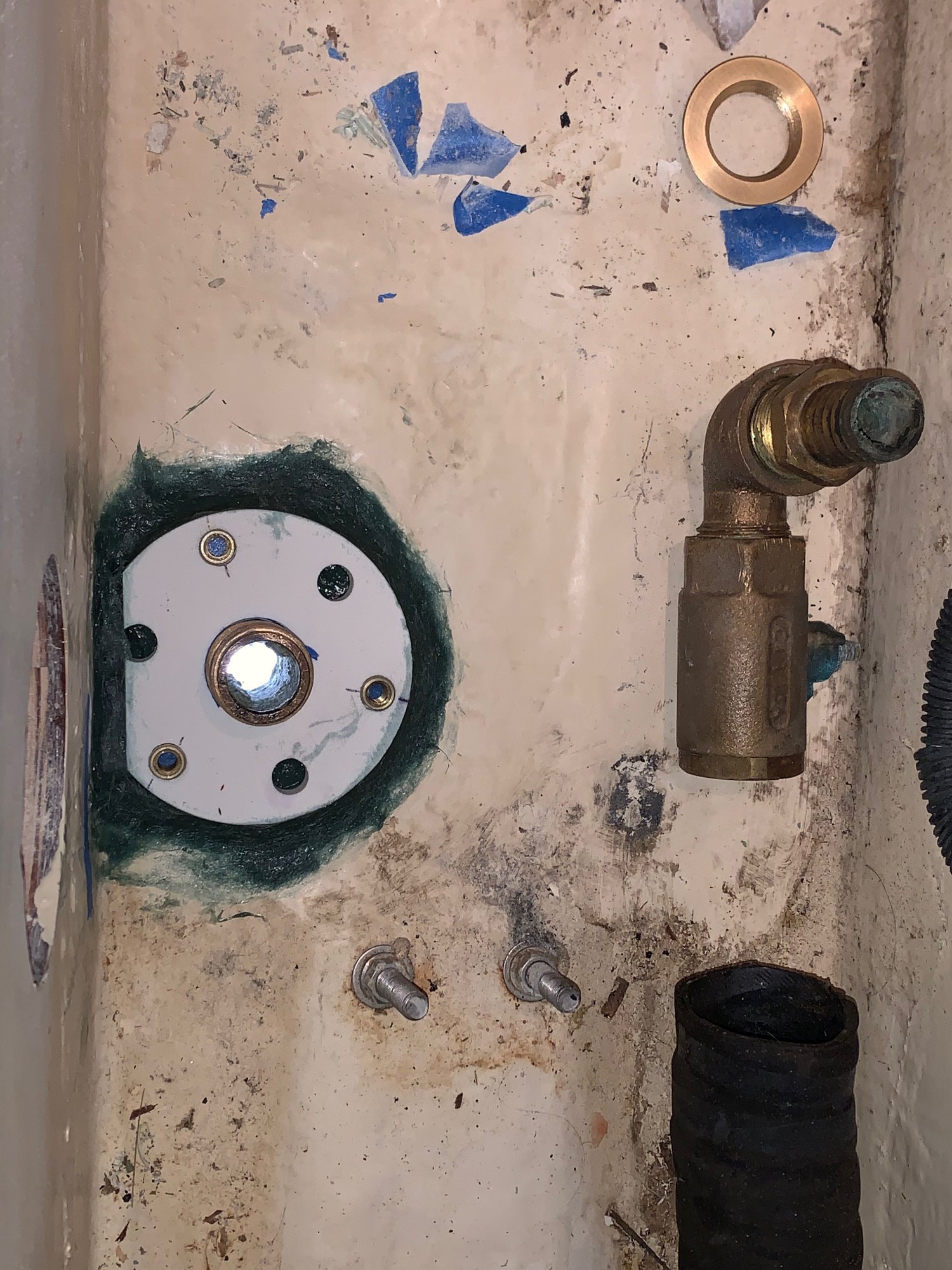

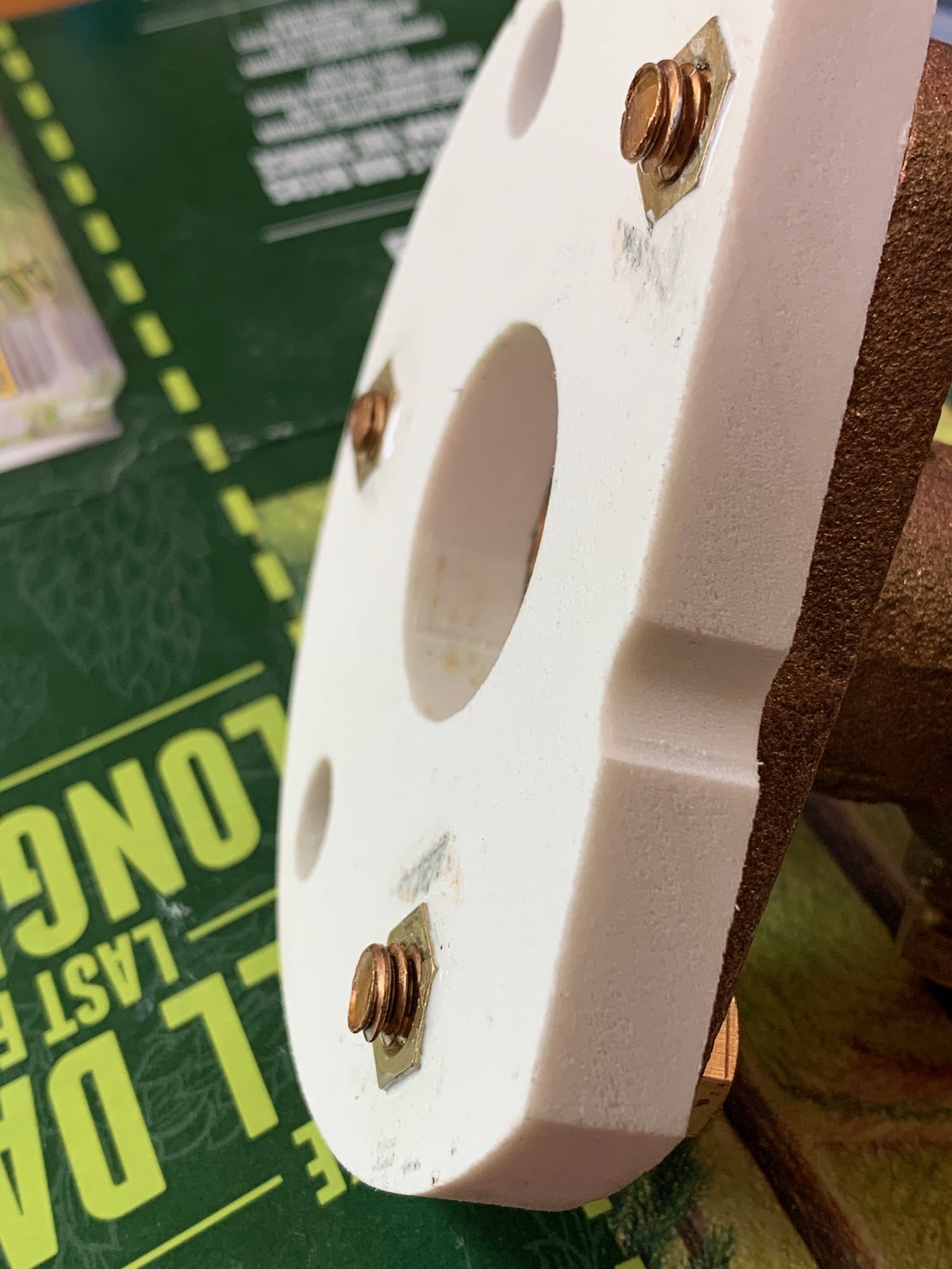

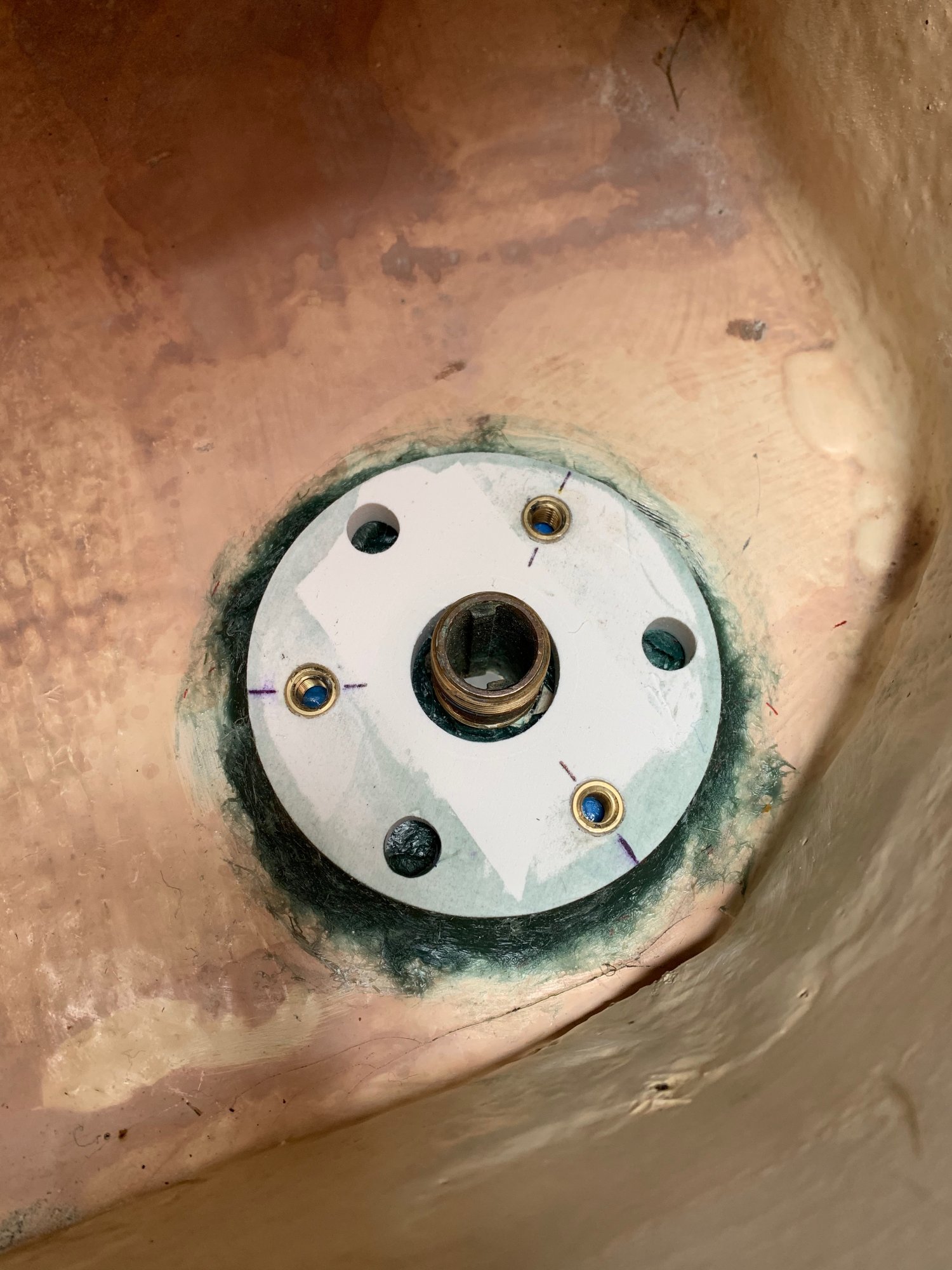

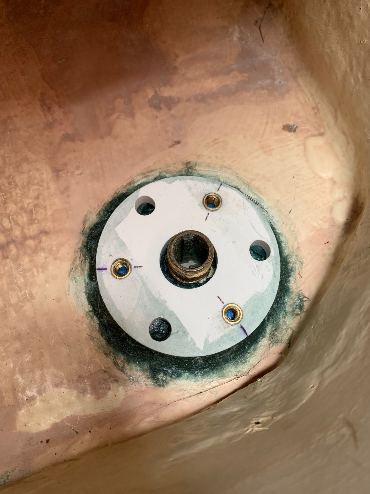

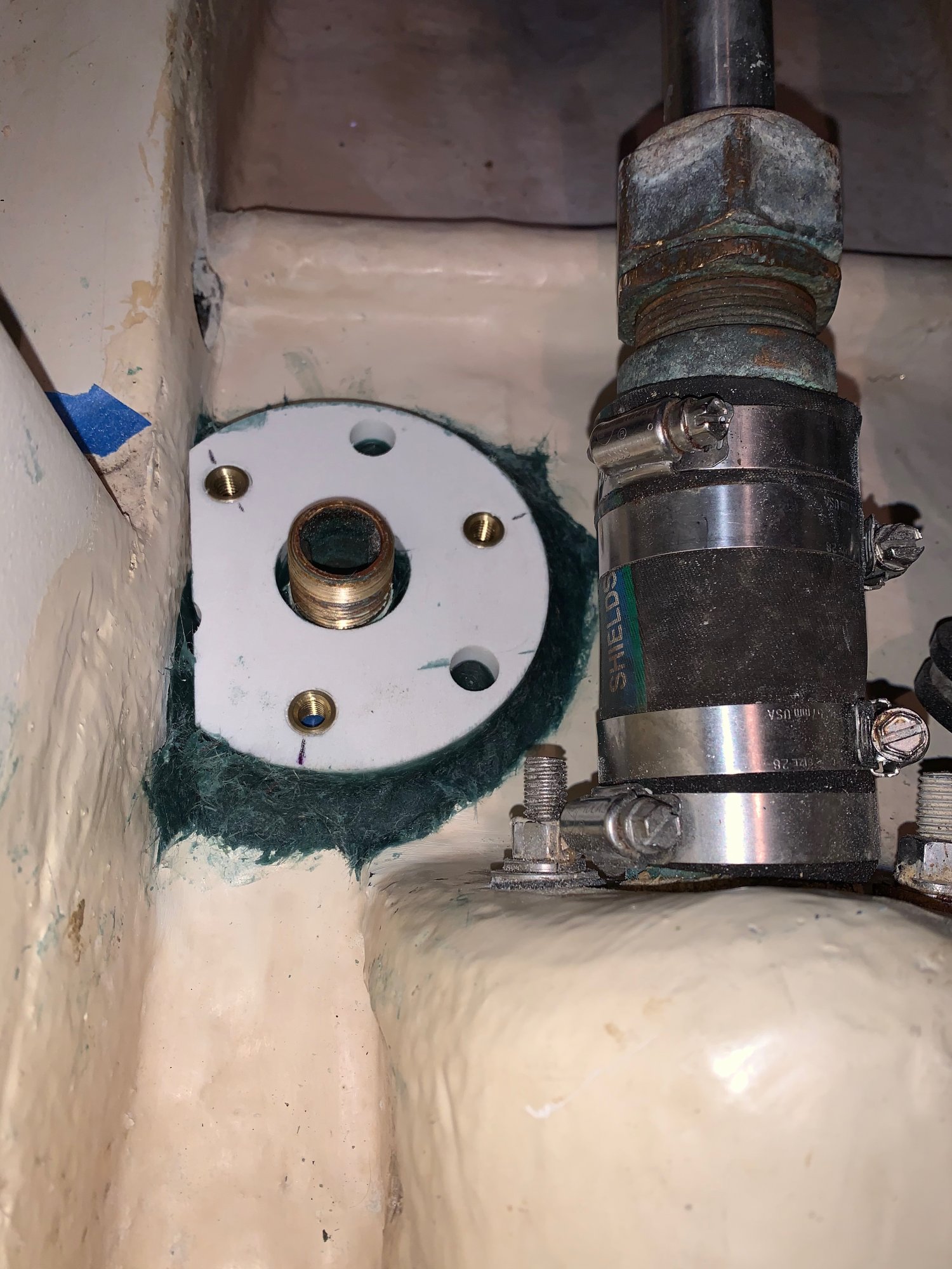

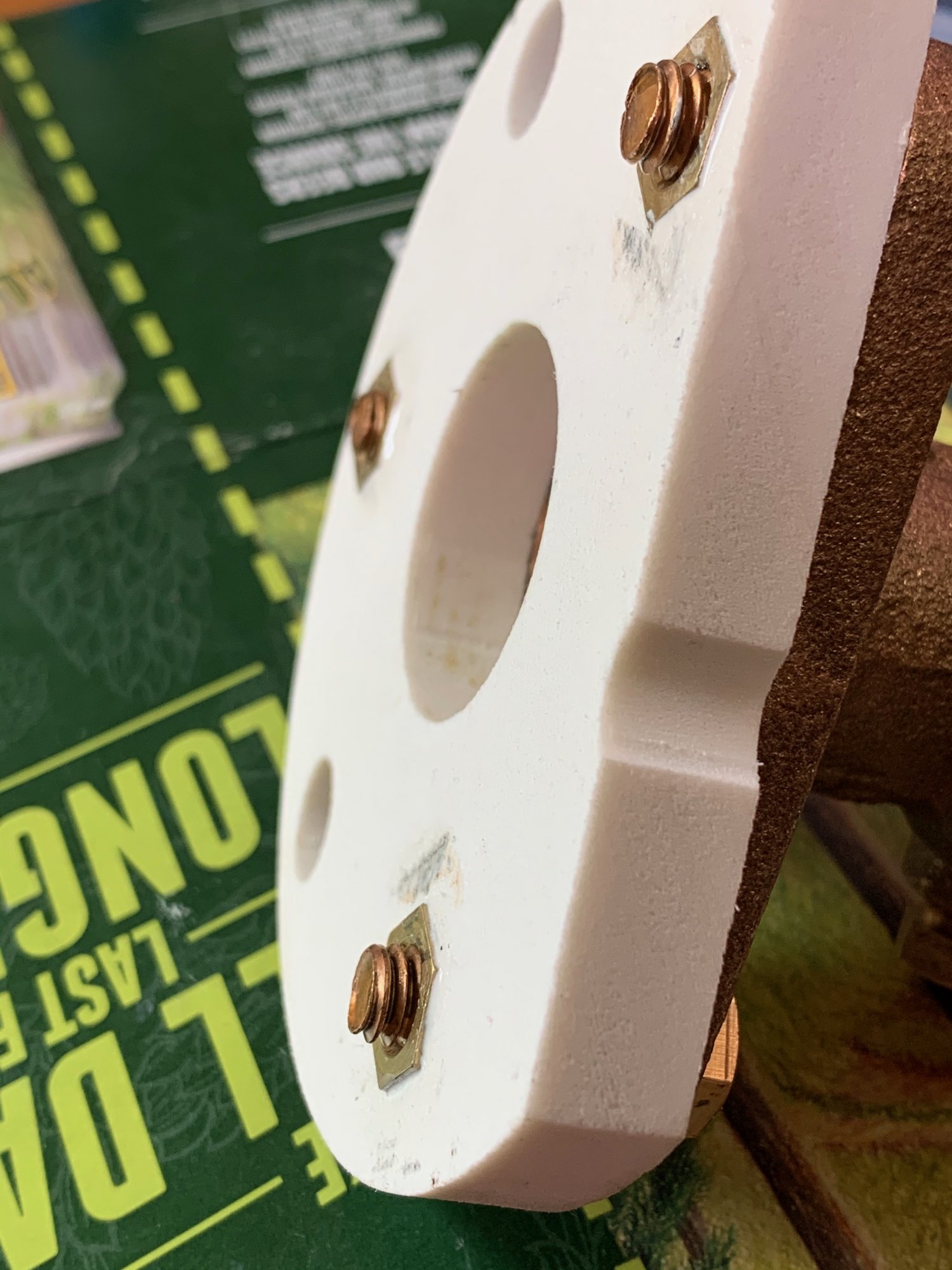

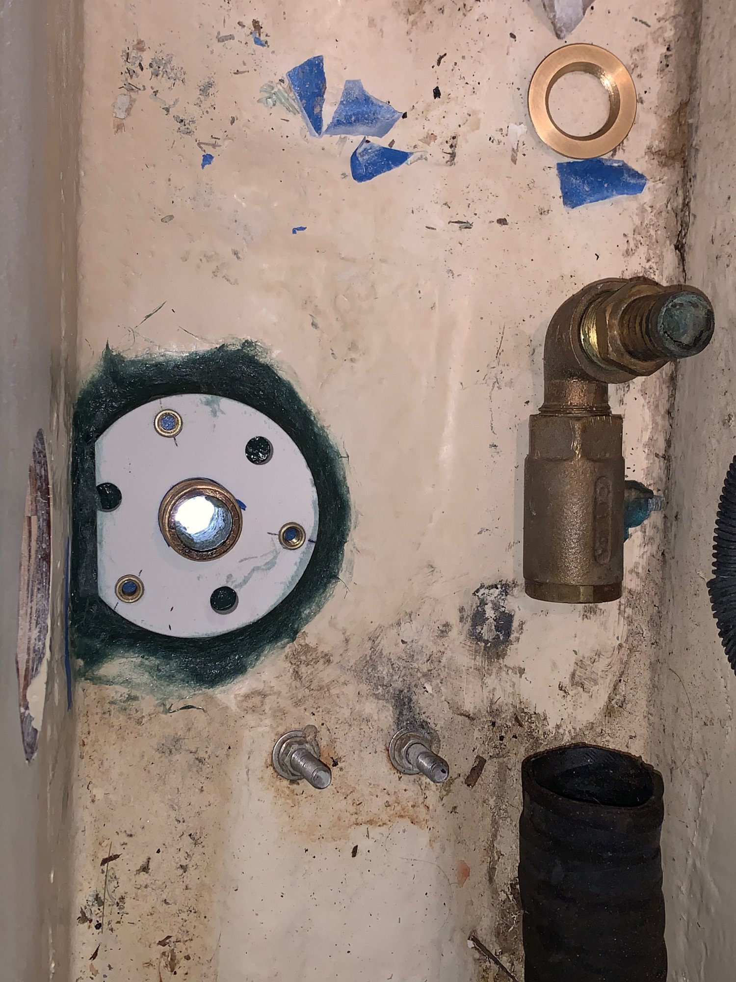

So fiberglassing the backing blocks is done. I epoxied the brass threaded inserts into all the backing blocks first. Here they are dry-fitted to the seacocks, showing how much bolt I need to cut off. I put small bits of tape on the underside of the inserts, to keep the fiberglass out, and then masked off the whole area before fiberglassing. The third picture is one of the (three) finished backing blocks. As you can see, I left the old ones in for now, as an aid to trying to keep the block perp to the thru-hull. Except for that part, this is exactly the same method as in Mainesail's article Replacing Thru-Hulls and Seacocks - Marine How To.

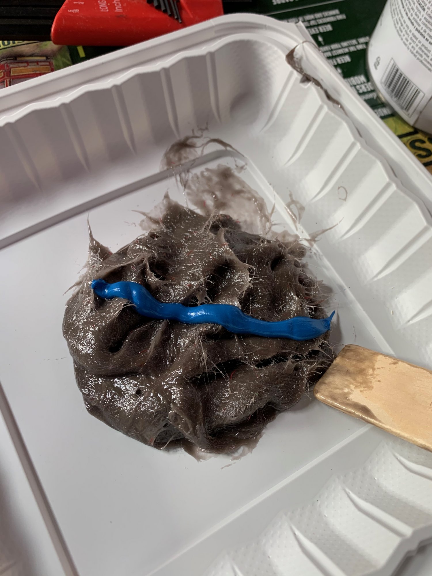

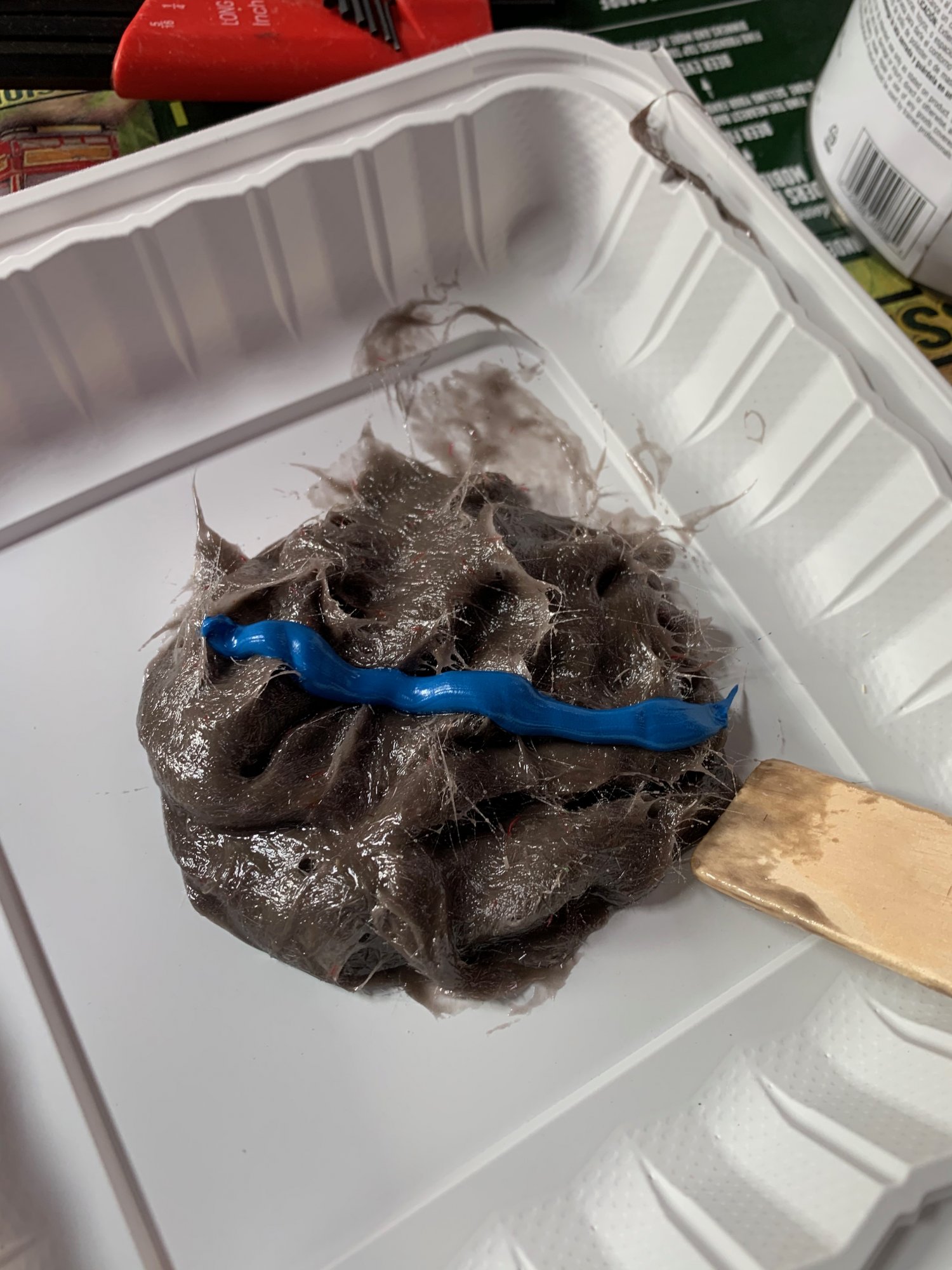

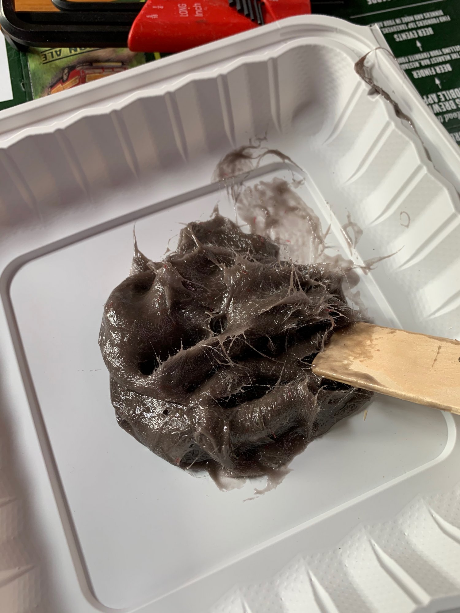

I've never done fiberglass before, so I was a bit surprised at how fast it sets up. It's really sensitive to how much hardener you add:
14,187
Did you use epoxy resin or polyester resin?
Polyester resin will set up faster with more hardener (catalyst) and with higher temperatures. Epoxy resin is very sensitive to the resin/hardener ratio. Adding more hardener will not yield a faster cure, but will yield a weaker cure. Warmer temperatures will cause epoxy to set up faster.

I really don't know a thing about fiberglass, so I used Evercoat Kitty Hair as mentioned in the Mainesail article. It is apparently a polyester resin mixed with long glass fibers. It's pretty gnarly stuff: not too hard to mix, but you really have to work quickly. I was getting a max of 4-5 minutes of working time after mixing it with a small (throwaway) paddle for less than a minute. It was maybe 62 degrees out. Once it starts to set up, you pretty much have to stop working. If I had to do it over again, I might use one of the products with shorter fibers (Glass-lite, from the same maker).
The first one I did, I barely got the backing block on and screwed down, and when I tried to smear the extra around the edge of the block, it was setting up too much. So I had to mix a second batch, which I used just to feather around the perimeter. With the 2nd and 3rd blocks, I knew I had to work fast, and I managed to get it all done before it set up, peeled off the protective masking tape really quickly, and gave it one more smoothing with my gloved fingers. All in all, it went better than I could have feared. I won't be able to tell to what extent I messed up on keeping them perpendicular to the thru-hulls until I take the old ones off and try to dry fit the new ones, but I think it will work out ok.
In any case, they sure as heck aren't coming off any time soon. I think I'll try to sand and gelcoat the blue part, b/c it's all full of nasty fibers that want to embed themselves in the unwary hand. Here are the other 2. For 2 of the 3 (the 2 I trimmed), I had to be extremely strategic about how the fitting sits so that I'll be able to close the seacock without interference. (BTW: the part underneath the fiberglass was very clean and roughed up. It's just the rest of the bilge that looks filthy...)

The new strainer bracket is done and more-or-less installed:
Yeah: there are no hose clamps yet, the raw water pump isn't reinstalled, and I still need to glue down (4200) the seacocks and thru-hulls. I think the new sea strainer is probably a bit of over-kill for a 2GM20F (the 3/4" thru-hull and strainer fitting necks down to a 5/8" hose to go into the raw water pump). But it should be much easier to clean out, and safer than the plastic Sherwood strainer hanging off a pipe from the old factory thru-hull (shown in #20 of this thread). I had the new bracket all pre-drilled and ready to go, and thought I'd just be able to drill pilot holes in the fiberglass and put in (essentially) wood screws, which is mostly what the builder used. The first screw twisted in half in the pilot hole (see lower RHS of bracket). I had to go the the store for a tap set, and tap threads in the rest of the holes. Who knew fiberglass was that hard?

I don't see any signs of foam in the holes (thank God), and the 3 thru-hulls I'm replacing are already pretty much all done but the 4200. If you look in the pictures, I'm using the Groco flanged seacocks. I did consider using the separate flanged base plus ball valve, but decided that the 1-piece looked more solid. I strongly suspect that Hell will be freezing over before I ever replace these 3 again. The galley and head sink thru-hulls still date back to 1 or 2 years after we bought the boat, but they aren't located where the plywood backing plates ever get wet, so they're in good shape.
