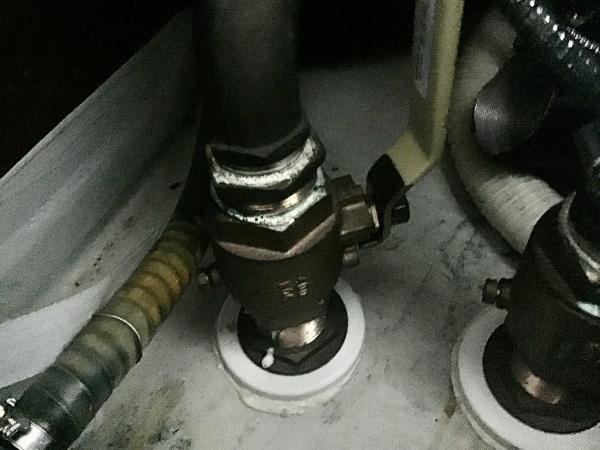

Okay, I’ve read through Mainsails seacock primer. There’s a lot of talk about flanged seacocks and thread mismatches. That is all good info but I’d like to swing this conversation over to a First-Time-thru-hull-analysis for a capable boater who has never dealt with them before. More general info if possible. I won’t use Teflon. :p
I have an 87 mkII with very likely original Maralon thru hullls. The Maralon 850 series ball valves may or may not be original. All the ball valves work currently. So, specifically asking about my Cat30 with Maralon hardware:
1 - do I need to change the thru hulls at any point???? And WHEN exactly is that point? There doesn’t seem to be much guidance for Maralon. Are they good forever?
2 - there are no visible backing plates on the existing thru hulls. Just the built up glass bump that is part of the boat. Is that bad? Do I need to take action next haul?
3 - if I do decide to refit thru hulls and valves, I feel like Maralon is a great choice. The newer 93 series from forespar look great. Hayden has provided some great input about those. Is there any other consideration?
4 - lastly, what about the other “holes”? Two sensors and the direct pump head hole? Those are all different. The main 4 I have are: engine, macerator, galley sink, head sink. Those are all the same. Should I ignore the others?

I will try to answer but this is just my opinion. and your mileage may vary. FWIW, on my 88 the 850 ball valve was OEM.
1. The Marelon tech says they are good forever. (Of course, that was the same guy who told me to use Teflon tape.:kick:) I know that other types of plastic get brittle over time. Couple that with the fact that the OEM install used bear thru-hulls without backing or flanged seacocks I just at my last haulout i decided that it was time for me to change them. I only need to haul every 8-9 years, so it was now or another decade.
2. There are no backing plates on the C30 Mk2 and the mound that you see is not any thicker than the rest of the hull. It is the result of the large countersink that is cast into the hull. I cut out backing plates from some marine ply I had on hand, coated them with epoxy resin and attached them over the hump with thickened epoxy resin.
3. The factory recess is a challenge because the flush mount recess doesn't have the large flange that was on the OEM. I could have built up the hole on the outside but that would have required a lot of grinding for a proper bevel and then filling with many layers of glass. Instead, I mounted the mushroom head in the bottom of the recess. The top of it was just about flush with the surface of the hull. that leaves a donut recess around the mushroom. I filled that recess with pre-thickened G-flex epoxy which I had on hand for filling the small Catalina smile, so I filled it with that. It could also be filled with an underwater fairing compound.
I replaced all four with the series 93.

Backing plates are for the purpose of providing a reinforced base for the flange to lever again. Given that, the thru-hull with a non-flanged ball valve will not benifit from adding a backing plate. The difference between the OEM installation and any type of flanged seacock is in how the load it placed on the thru-hull fitting. In the OEM thru-hull with ball valve, a sideways load to the top of the valve will BEND the thru-hull. The same load on a flanged seacock will not bend the thru-hull, it will PULL on the thru-hull and push down on the flange and backing plate. In engineering speak, the flange creates a moment couple with equal and opposite tension and compression forces.
The ball valve bends the pipe section of the thru-hull and that is the weakness. pipes are much much stronger in tension then they are in bending so any flanged seacock will be much stronger than any ball valve.
As to the question of whether YOU need to change to get the increased strength, only you can answer that question.
