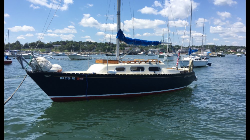

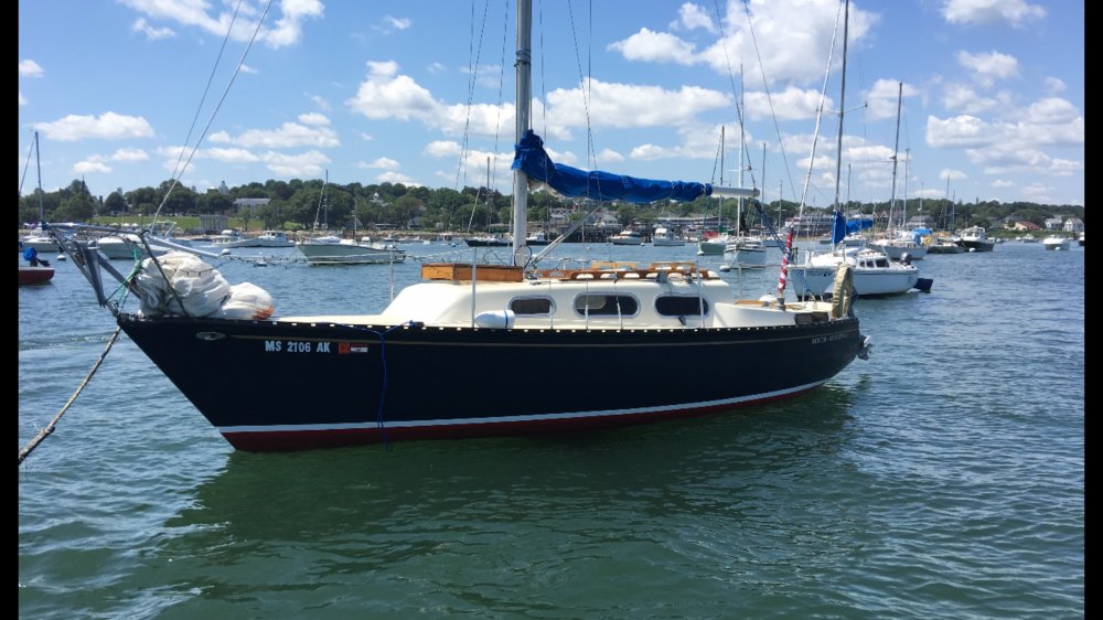

Not a large sailboat 25' however not a daysailor either. 5000lbs and the wind needs to be in your favor. If you miss the trailer (hauler from Brownell) you're out of luck.
