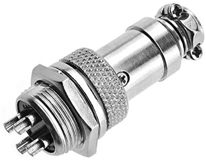

I'm probably being stupid, but how do you conect the wires to these? I see them on many connectors of this type. These are NOT the plug pins, these are the ones the wires connect to. The plug separates near the knurled ring.
Aug 10, 2020
611
Catalina, Hunter C25 3559 Rocky Mount

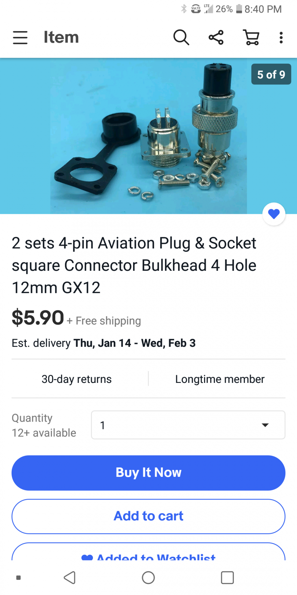

I assumed solder? I'm really not sure.... I had nothing to go off of originally and found the one pictured on ebay searching for "4 pin bulkhead connector".

Those are solder cups. The wire is inserted, heated on the long side of the cup and apply solder to the bare wire.
Thanks, thought so, just never used them.
The problem, then, is that that they cannot comply with ABYC (solder cannot be the sole means of retention). This is, of course, a voluntary standard.
Nov 30, 2020
79
Macgregor 22 Dania, FL
So put a cable clamp next to the socket. Now you have two means of retention. Besides, there are solder joints made during the Roman Empire that are still good today.
24,775
The item in the image has a cable clamp for a 4 wire single line. That gives you 3 power leads and a common ground running up the mast. You would need to look inside the pictured connector to see if there are individual wire clamps in addition to the soldered end, for each wire to meet the ABYC requirement.
