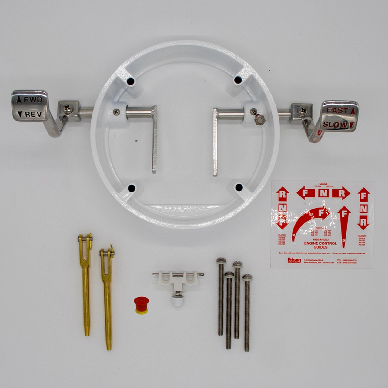

the throttle brake on my edson pedestal has worn out, so the throttle lever doesn't stay in place. is there anything i can do about that?

I am not sure how your's is, but on mine there is an adjusting screw just below the compass and on the lever of the shaft itself to apply more friction.

thanks! mine has that as well, but it's tightened as far as it ca go and no result.

You can get a longer plastic or BRASS screw or
a brass stud w/nuts to hopefully solve the problem.
Don't use steel, it will wear out the throttle shaft.:yikes:
