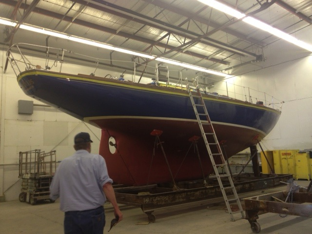

I have a fixed 3 blade on our boat, which is very similar to your underwater shape. The PO removed the 2 blade for this one. We run a 15x10, which is also known as the proverbial "dragging a bucket through the water", although we rtaced successfully from 1999 to 2006. That bucket has propelled us from 18 years in SF to up here to BC in 2016 and through the Gulf & San Juan Islands for the last four. You will undoubtedly get skippers touting their adjustable blade props, as well as the pros & cons of each. Good luck, happy choice making.
