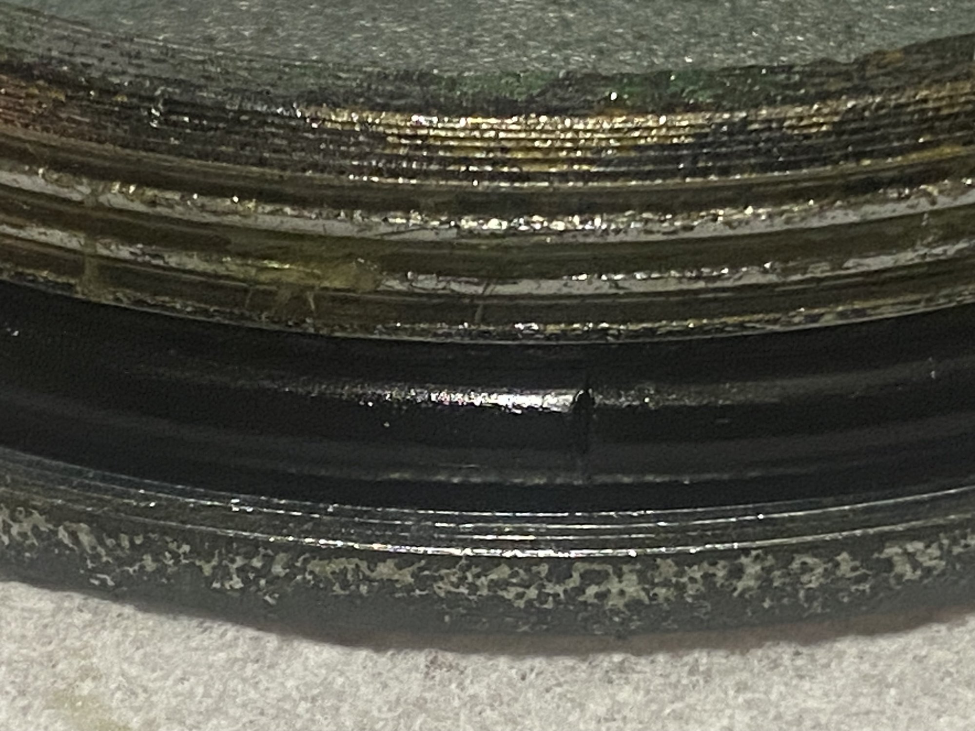

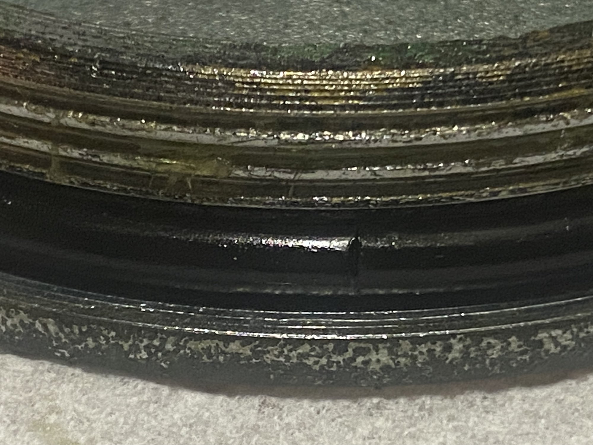

Thanks for the tip on making O-rings/Gaskets.Hard to say what the parent material is. Possibly aluminum.
At any rate, I'd use a fine steel wire brush to clean all of the threads taking great care you only brush with the threads. Lubricate with grease after the threads screw in easily. The lids also come with a gasket which cannot be purchased separately. This serves to keep the threads clean and water out of the other side. When making your own gaskets, see here:

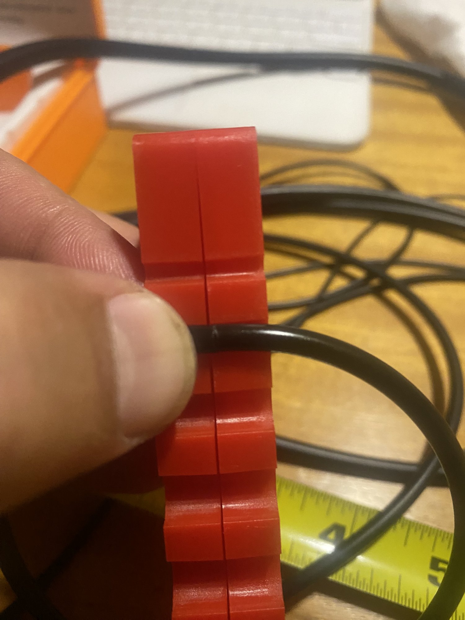

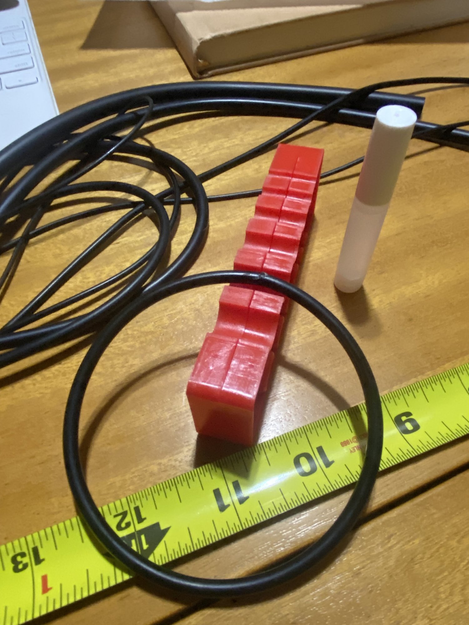

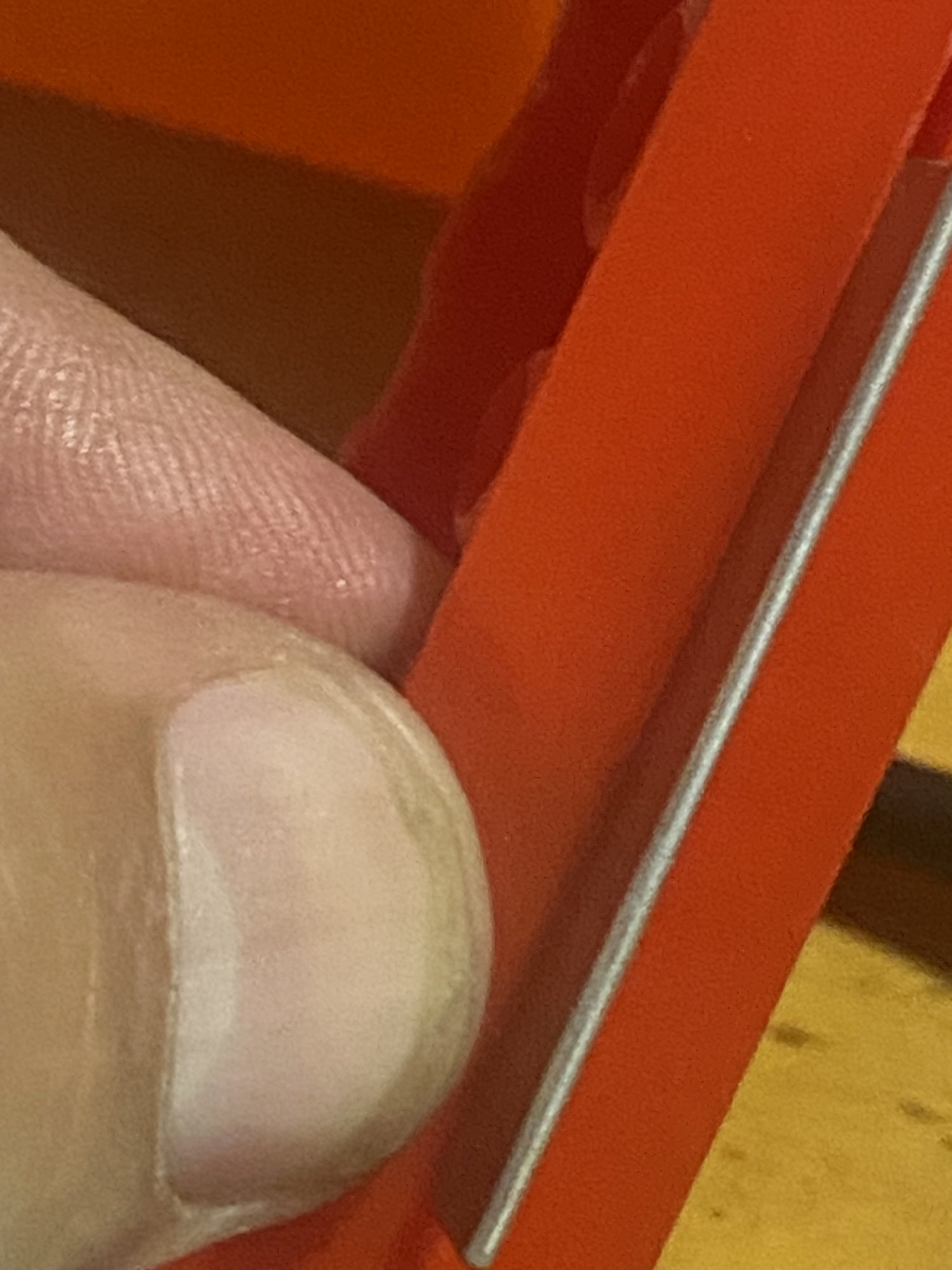

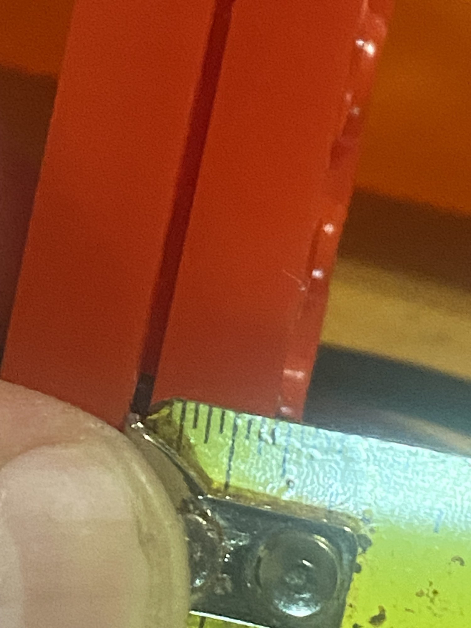

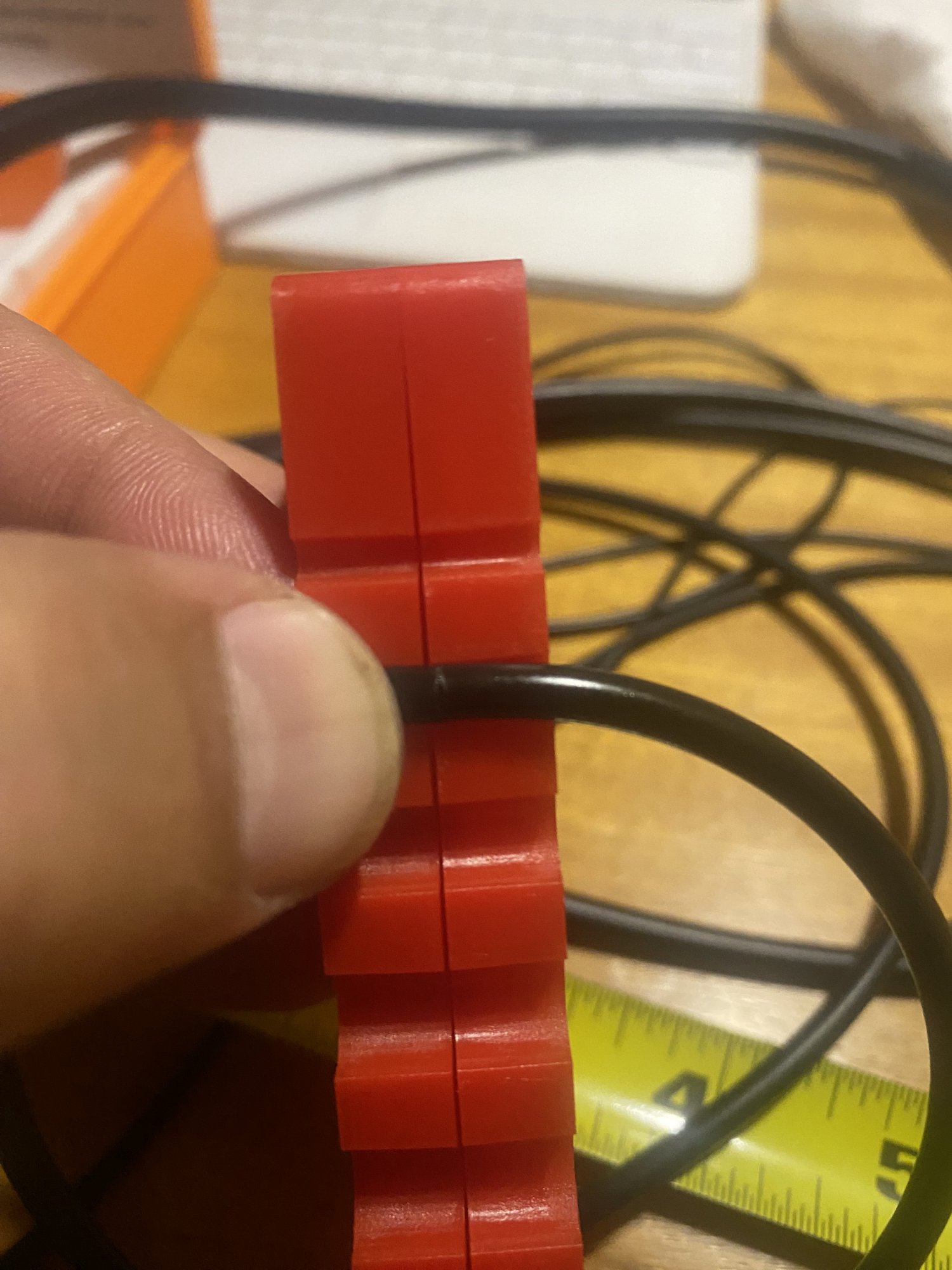

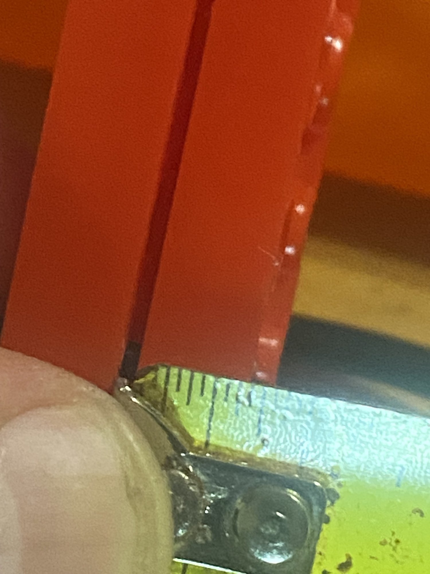

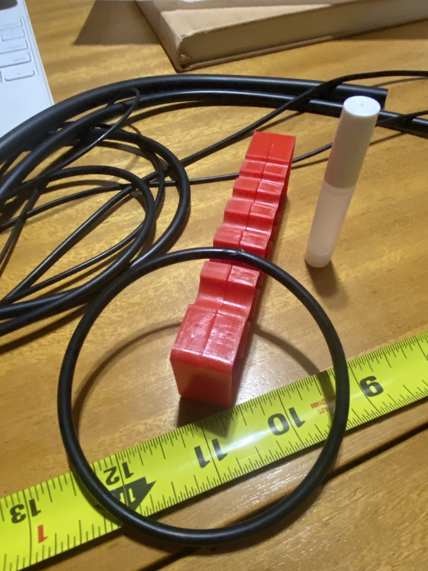

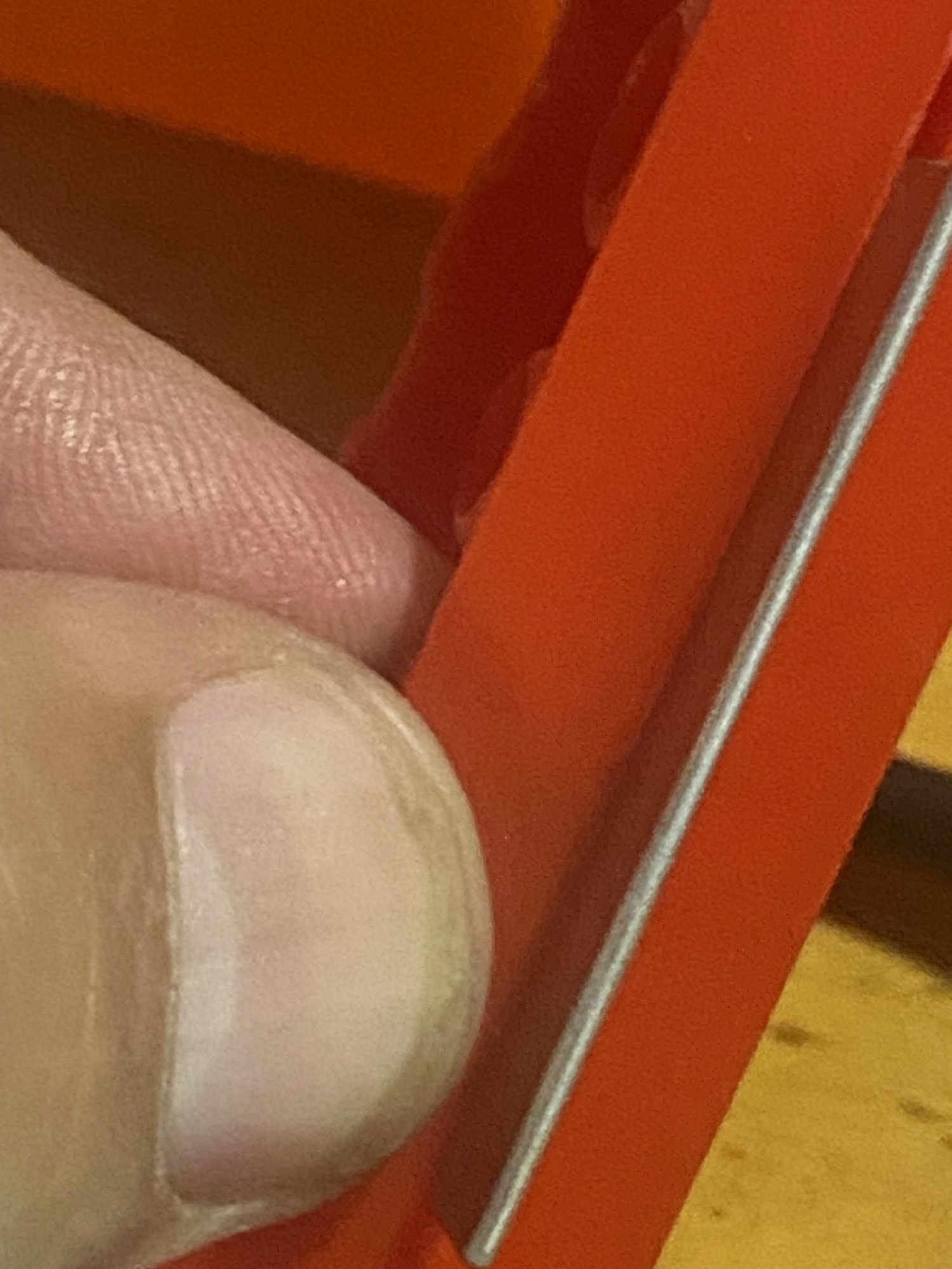

I used this kit
Worked nicely for making two.
Thanks again.
