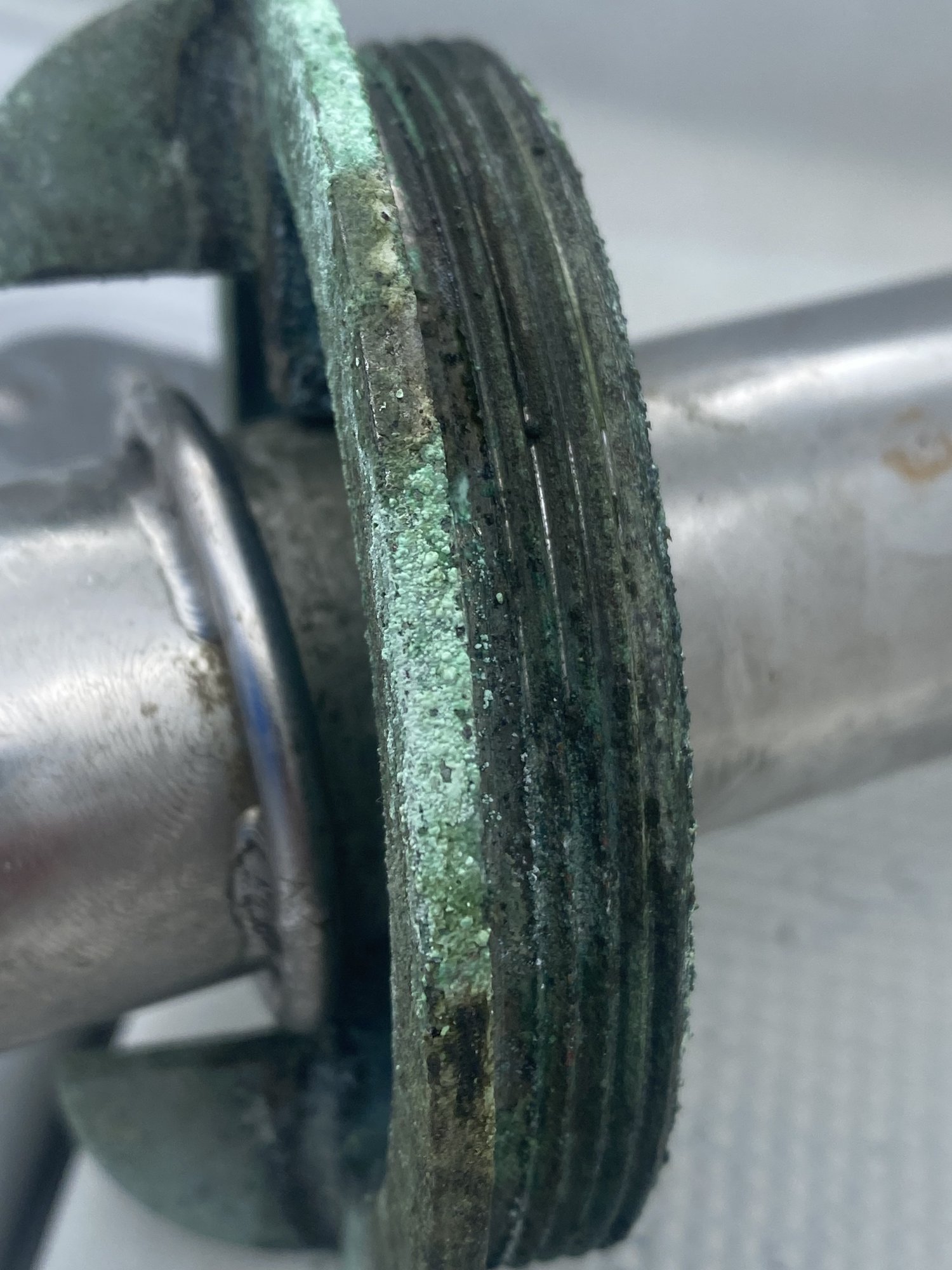

Hi All,
Hope you are doing well.

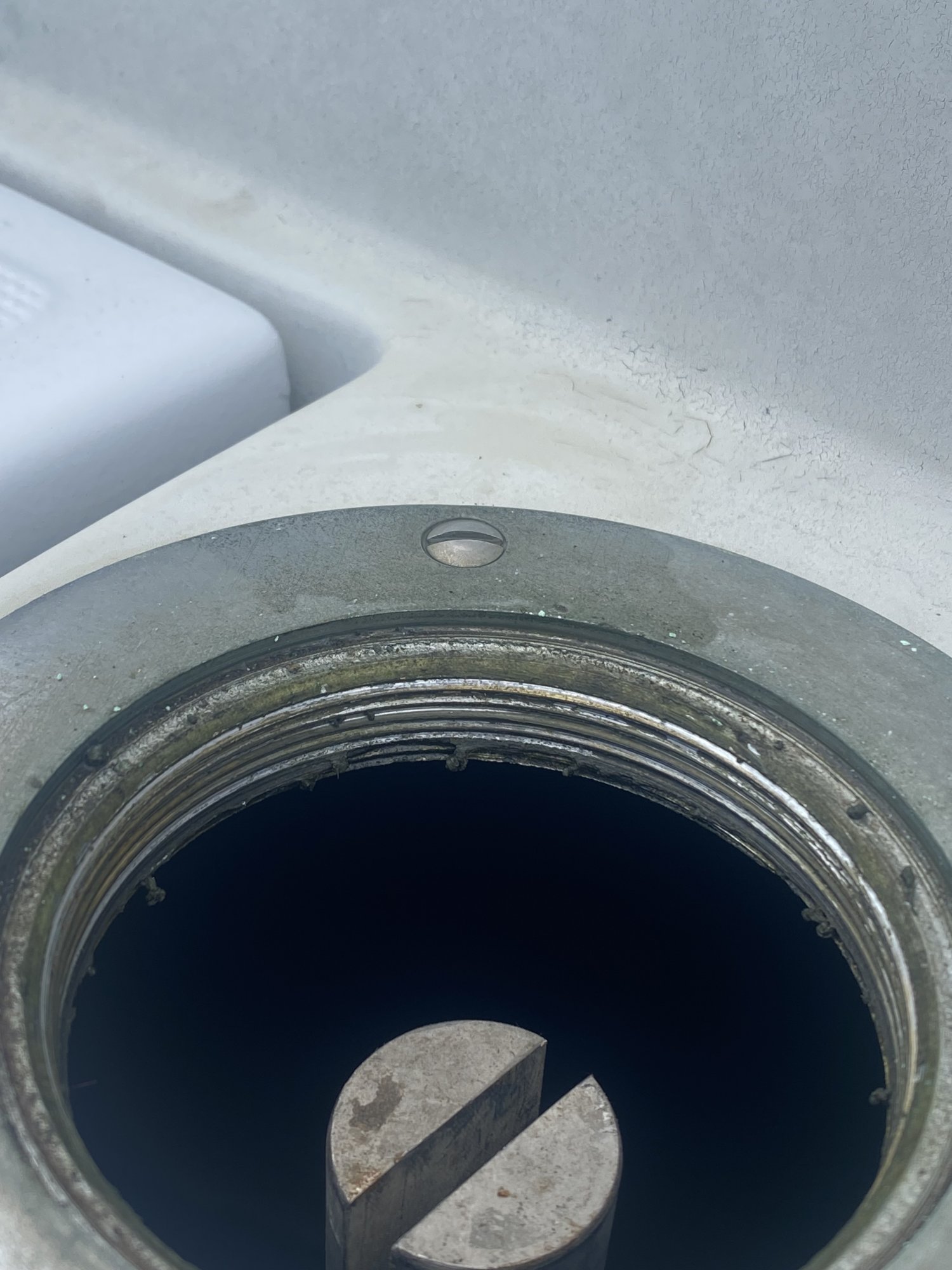

My sailboat a 1975 Dufour 34 is steered using the ship's wheel, I found the emergency tiller for it today.
I tried removing the lid and installing it but the threads were barely moving. I had to get my tools out.
I'd like for it to be more smooth in case I need to switch to tiller in a hurry.
My question is what would you recommend to do there.
I assume.
1. Apply some sort of product to help dissolve old material on the threads ?
2. Clean the threads with a brush {which type of metal to use } ?
3. Clean with soap.
4. Dry.
5. Apply product X on threads every Y days.
6. Maybe apply second product Z ?
Let me know what you would do please.
Thank you

Try using mineral spirits to clean the grease off the threads. Use a brass brush or a nylon detailing brush, these look like big tooth brushes. Apply some grease, marine bearing grease would work or red grease. Just enough to lubricate the threads too much and it will attract junk. Inspect annually and repeat as necessary.

Hard to say what the parent material is. Possibly aluminum.
At any rate, I'd use a fine steel wire brush to clean all of the threads taking great care you only brush with the threads. Lubricate with grease after the threads screw in easily. The lids also come with a gasket which cannot be purchased separately. This serves to keep the threads clean and water out of the other side. When making your own gaskets, see here:

Ok,
Mineral spirits it is.
I checked and brass brush is more gentle than steel wire, so I'll go with that.
Brush in the thread direction.
Ok, so marine grease I assume is better
red grease would be regular ?
The boat owner next door said to use LANcote, I looked at his and it looked too much like wax consistency ? might just be cold in the bay area for it. {Lanolin based product}.
I assume in that case I should stick with the chemical based grease ?
Thanks for the idea on the gaskets, I guess I need to add make my own gasket. Assuming those parts had gaskets.

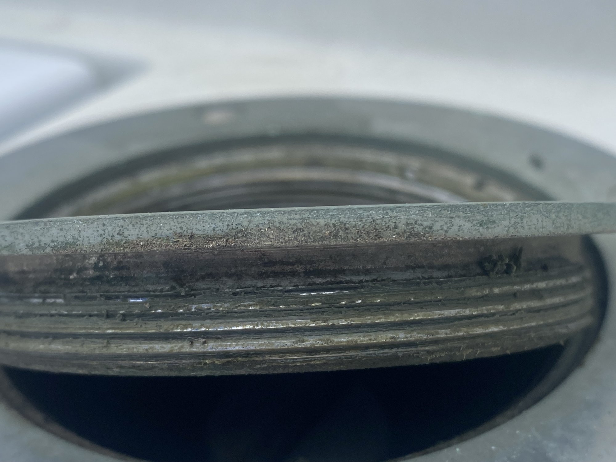

That thing looks like it has not been removed in a very long time. I suggest cleaning with a wire wheel on a grinder if you have one or a wire brush of any type. Since we are only talking about a cover that does not need to be watertight and the threads are likely already damaged by the lack of regular cleaning. Neither of those cleaning methods will damage the threads, they may even loosen the thread slightly and prevent this from happening again. There is a product that is like WD40 that goes on wet and dries without leaving any sticky residue like grease that will attract a lot of junk that will eventually bind up the threads again. WD makes a version of this that can be had at most places that sell lubricants. The original name for this stuff was called Dryslide. This stuff can also be used on sail slugs and canvas zippers.

Alright.
Mineral Spiritis did the trick as far as cleaning the old material off. {Old material was Lancote}.
The Brass brushes were fine on my other threads.

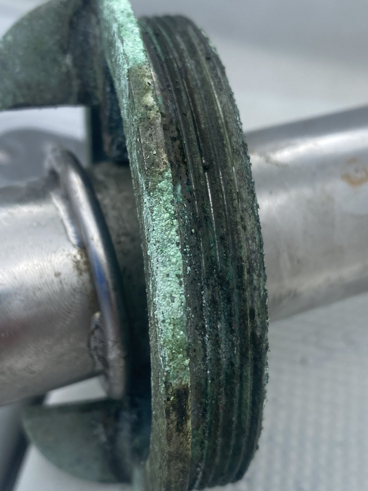

This thread has some corrosion on Image 0020, which is my spare tiller. So that one benefited from steel bristles.
If your threads on the boat are in bad condition or you are in a hurry. It would be better to get wire wheels as cagreen75 suggested as there is less room to move the brush in the direction of the threads. I was in no hurry.
To test which lubricant.
On half
I applied Lancote - maybe mine is old or the bay is too cold right now it was very sticky, like candle wax, they were hard to turn without the tool.
On the other half
I applied Quicksilver Marine grease - the items turned a lot more easily, it was also easier to work with and cheaper.
so
I personally like the Marine Grease better, so I cleaned the others again and put grease on all.
I ordered a Buna-N O ring splicing kit
and will try to make an o-ring for the cap which is 0019 there and the emergency tiller 0020
there is a groove there so I assume in 1975 it had an O ring.
0018 is the rudder
0019 is the Cap that covers it when you use the wheel
0020 is the emergency tiller you connect.
