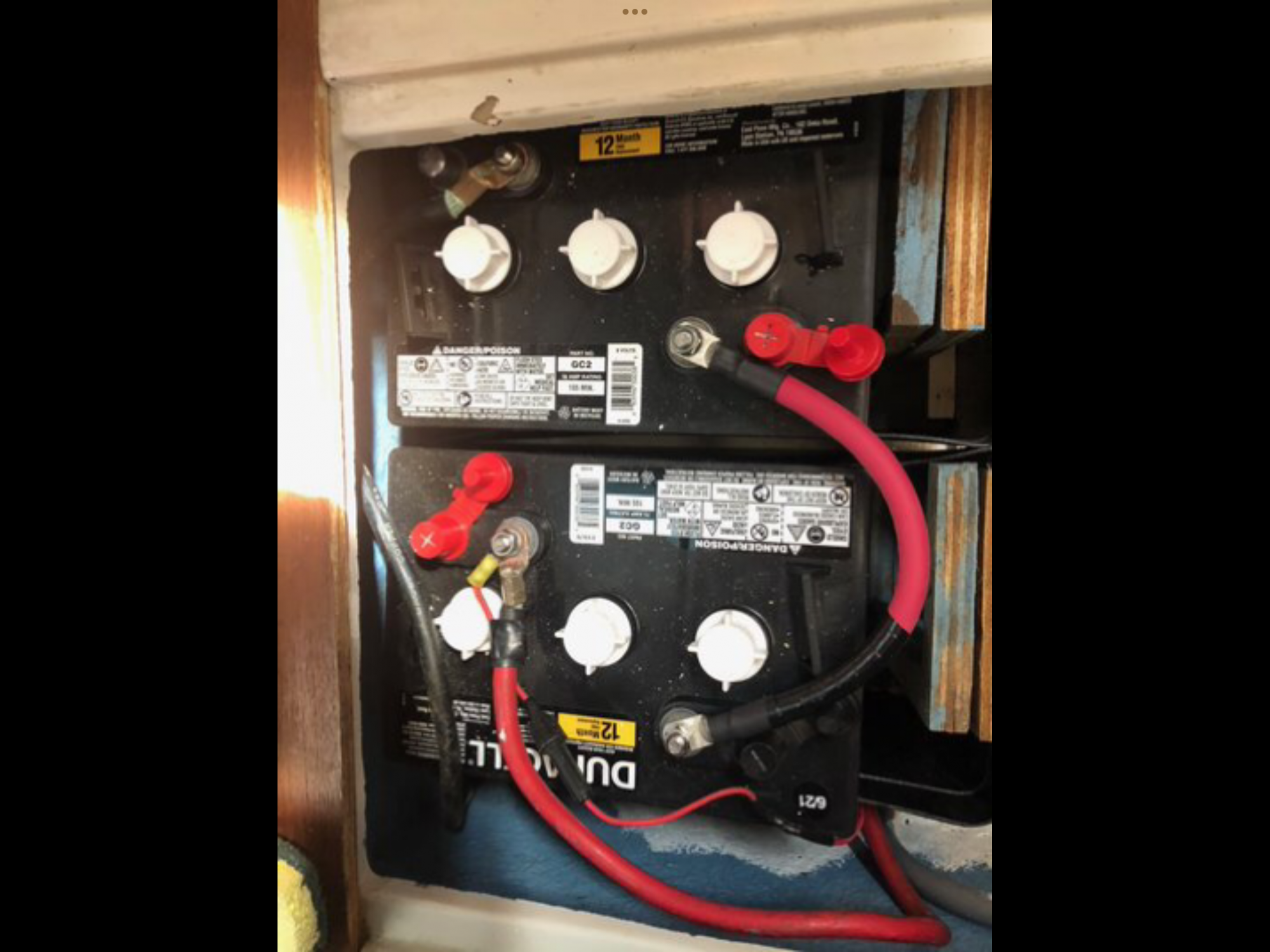

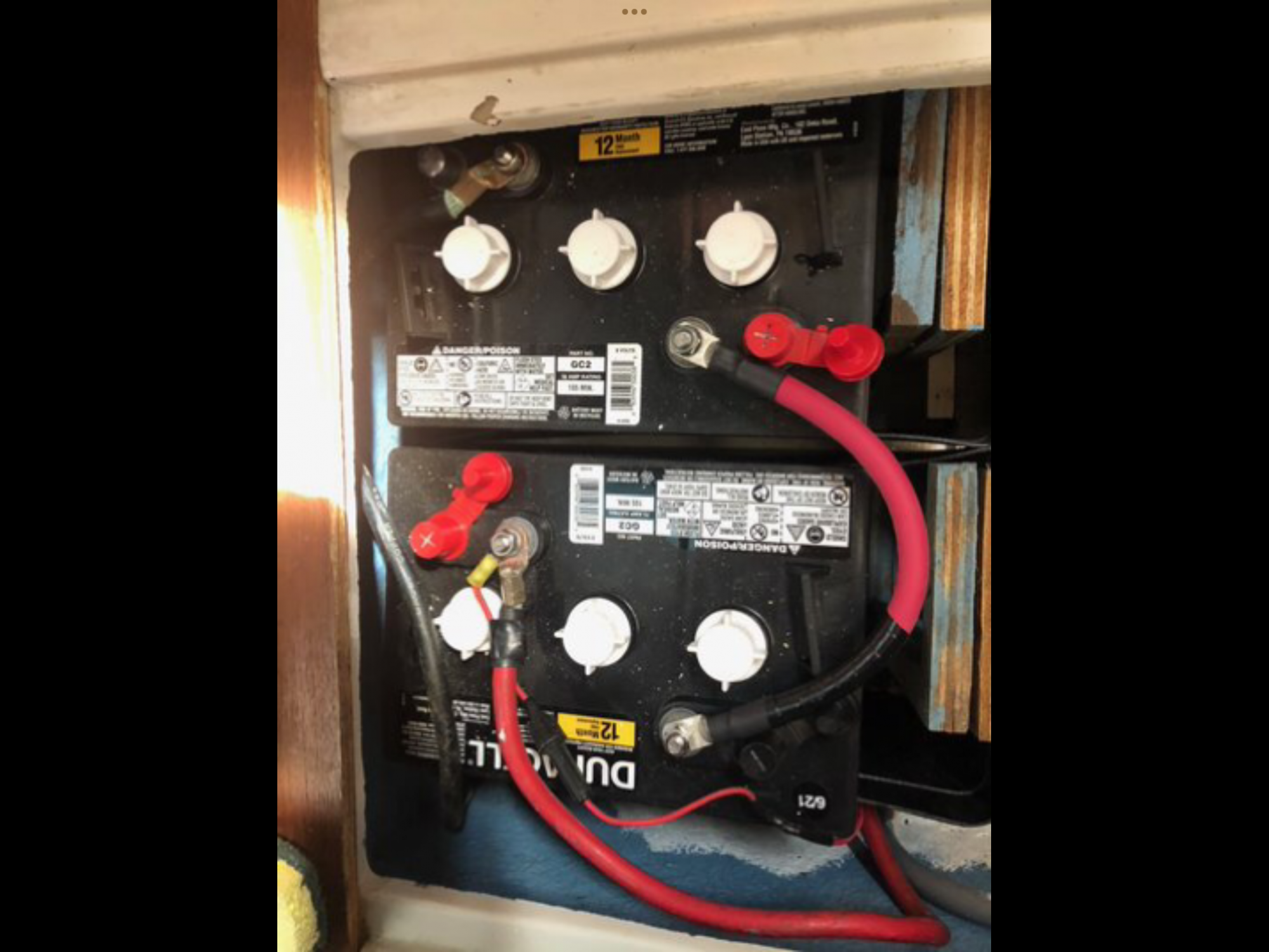

I got 2) 6-volt golf cart batteries (Duracell’s) at Sam’s Club a few years ago and installed them as my house bank (215AH total).
They have held up well for my needs… day sailing and a few 2-3day outings on the hook.
I don’t even have a separate starter battery for my 2GM20F (Yet).
Greg
Likes: Ward H

I am pretty sure Duracell 6volt batteries are East Penn/deka which are fairly decent quality for flooded type. And a great price!
Greg
Likes: Ward H

I think the 12v are/were made by East Penn. The 6v batteries in Greg's photo don't have the right caps for an East Penn battery. East Penn uses a battery cap that removes all 3 caps at once. These are Deka Batteries, definitely made by East Penn.
The connected caps and posts look just like my Duracell Ultra BCI GC2 Deep Cycles I bought from Batteries Plus. From Maine Sail's post I always believed they were made by East Penn. Installed them in 2018 and they appear to be still going strong.
