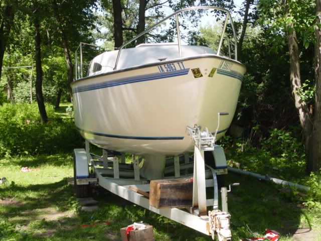

At the time I bought my boat, I was such a novice, I had only read about these type boats and really did not understand what they were. Honestly, I thought they swung side to side so they would always be pointed down vertically.
By sheer luck, I ended up buying a boat primarily because it was Cheap and ending up with a really good boat with a shoal draft fixed keel. It only extends down about 14 inches or so and the boat has a shallow draft of only 28". It does take a bit of finagling to get it launched, but so far nothing dramatic. Usually off the trailer at a ramp or with the help of a tractor at a Marina.
My friend Dave and I and our SWAMBO's:D sailed a ComPac in the Keys (23') it has a similar keel and sailed just like my boat.
For all you novice shoppers, You might want to look for shoal draft boats. They seem to be very solid and forgiving.
Here is mine
I think the keel slug (lead) weighs in around 1400 - 1600 lbs.
