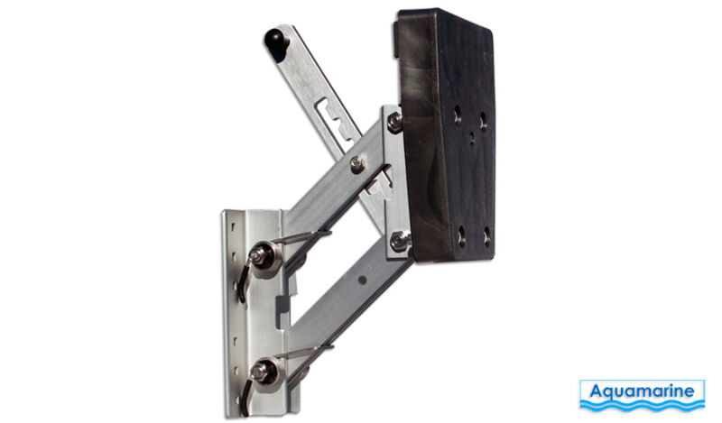

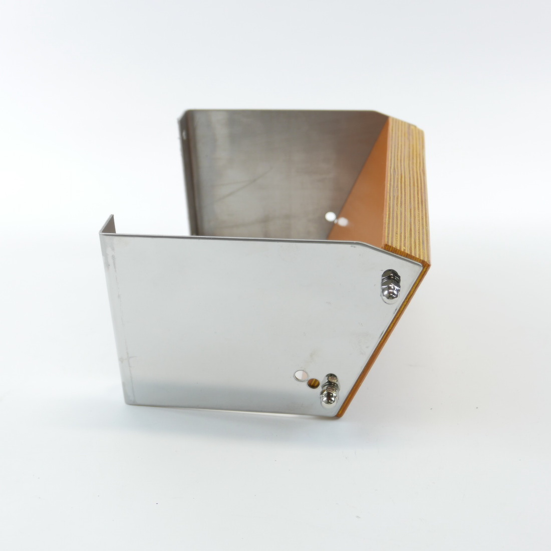

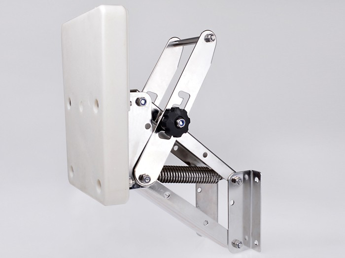

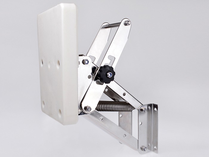

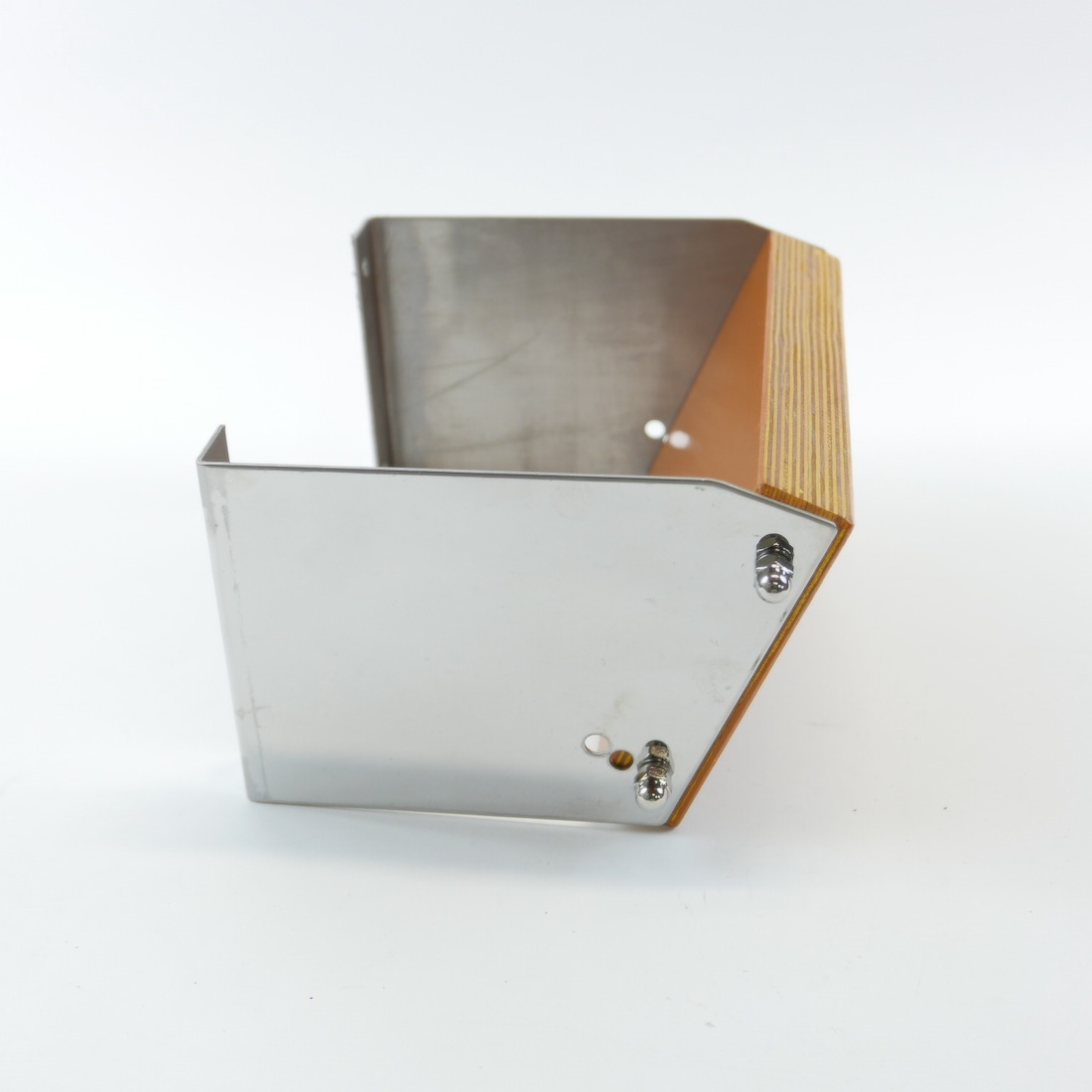

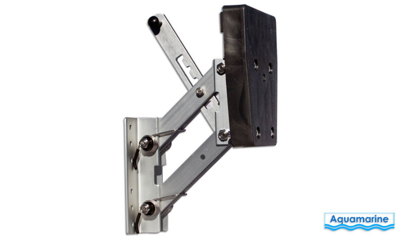

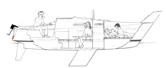

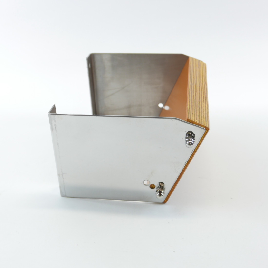

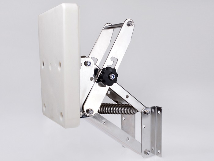

It is certainly possible to attach a motor mount to a Hunter 25. I would suspect the racer folk would look aghast a such a proposal. Extra weight means slower times. You could go with a fixed mount or one of the spring loaded adjustable units.
With the shape of the Hunter stern you likely will need a Long Shaft outboard. Setting it up for a marina access with a 2-4hp outboard should be relatively easy.

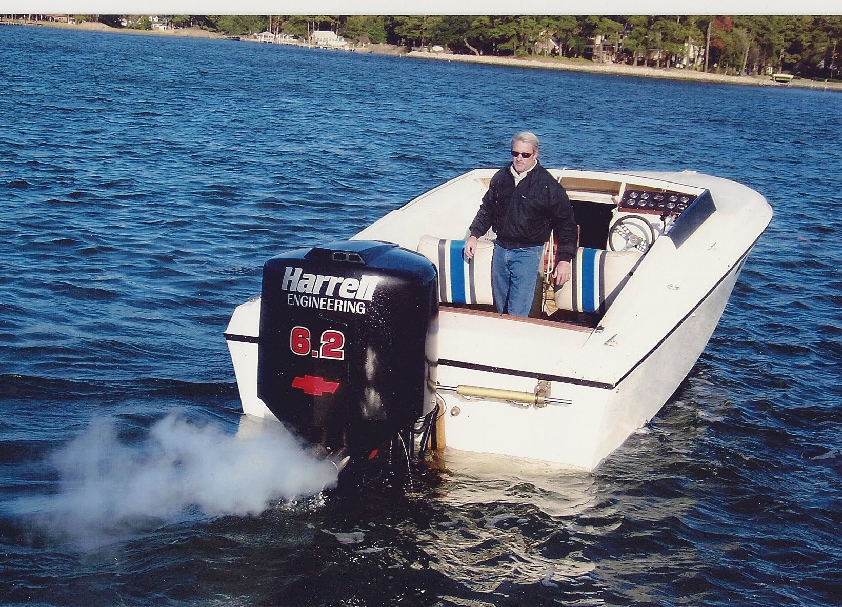

I am assuming your not considering a Chevy Big Block Outboard...
Jan 4, 2006
7,606
And why not ? If a little bit's good, a whole lot has got to be better :biggrin:.

Am I missing something? Is this what you are trying to do?
If so, go for it. The brackets are a few hunderd dollars and you can get a nice Tohatsu 6 sailpro with a 25" lower unit... and 6A alternator for a little under $2000.
I would through bolt something like what @jssailem listed in post #2 into your transom with a sturdy backing plate of SS. just get one with the longest arms you can find so you can lift it avove the aft sheer when not in use.. and that would allow you to tilt it up so you don't drag the prop when heeling hard.

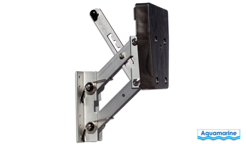

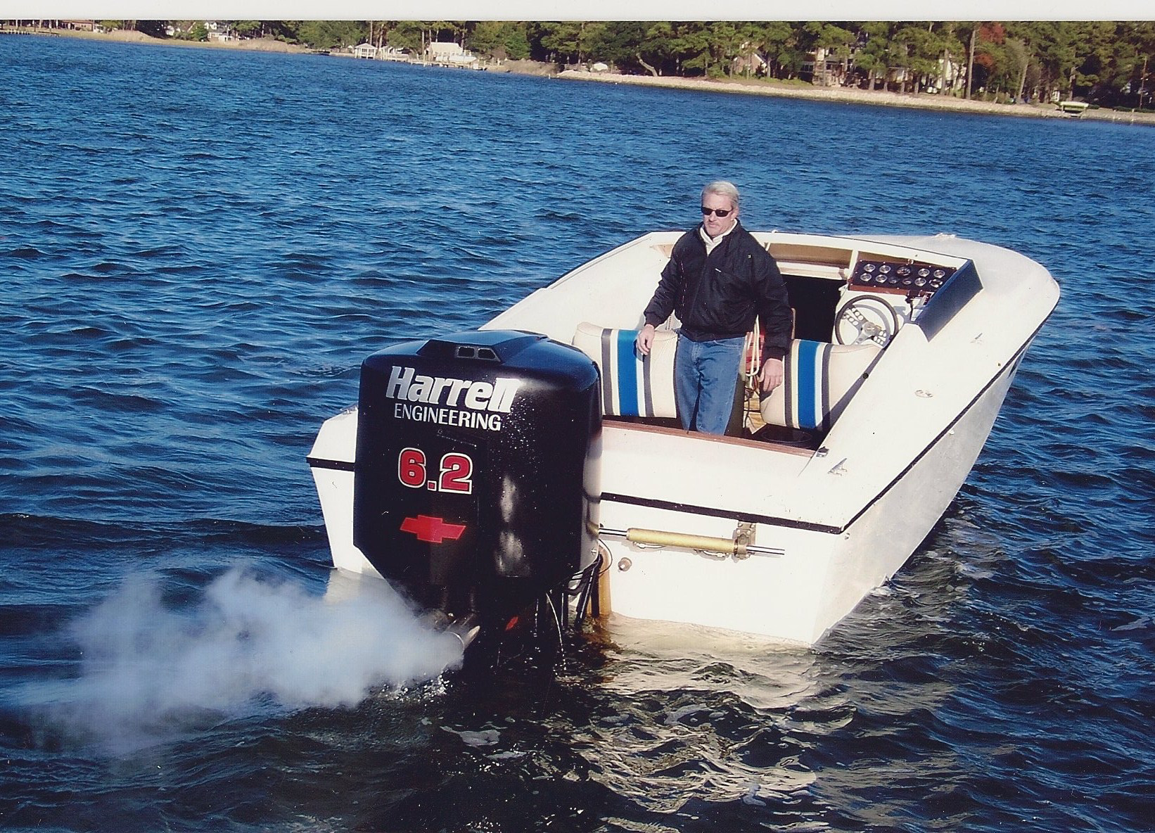

View attachment 200674 View attachment 200672 View attachment 200673
