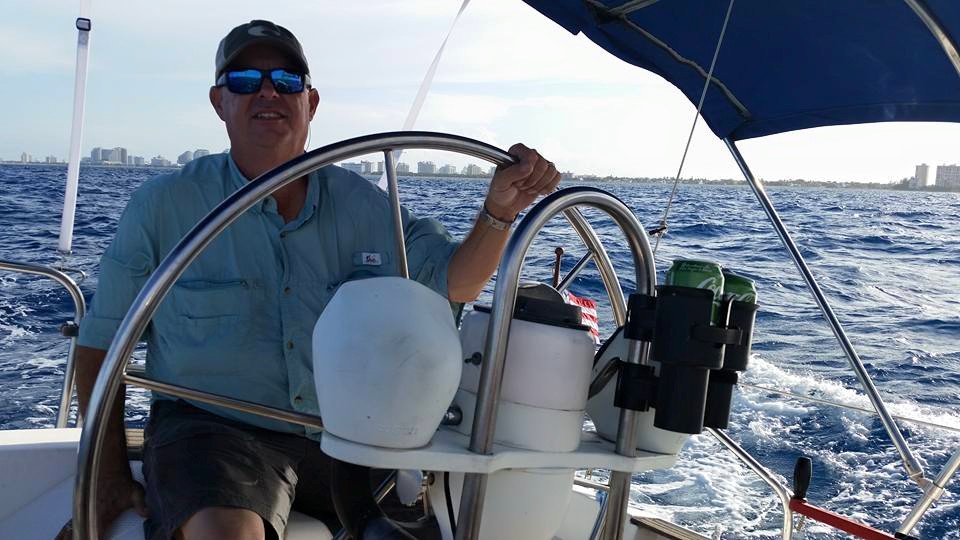

pateco
Aug 12, 2014
2,207
If it were me, I'd install the new and leave the old for backup depending on space for the display. (Our old boat had a bulkhead mounted depth display that I left in place.) If they need to mount in the same location, I'd certainly remove the old unit and put the new transducer in the same hole.
Ken
New C-80 display will not require removing the old one. which is in a globe off the left side of the pedestal as shown in the photo below. Still haven't figured out where to put the new display as the rail on my pedestal is not tall enough to add a standard nav pod. I may have to get creative. Any Suggestions?
