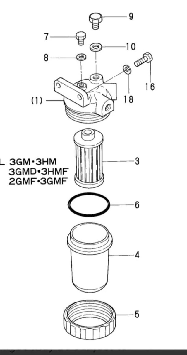

I understand the thinner stock o-rings can leak, and when I changed my filter last there was a thicker o-ring installed than the stock one (part 24342-000440). I’d like to have some extras on hand for subsequent filter changes, but don’t know where to get them. ID is 44mm, and the ring appears to be ~3mm thick.
The bleed screw on my filter also doesn’t appear to have a gasket/washer. I don’t notice any fuel leaking from the bleed screw, so I believe it’s adequately sealed (I assume this is a pressurized location, not a vacuum location, and a leak would produce fuel exiting at the leak instead of air entering). I’d like to have some gaskets on hand though.
any suggestions on where to source these?
Also, can anyone confirm that a leak at the bleed screw would produce leaking diesel when running the engine?

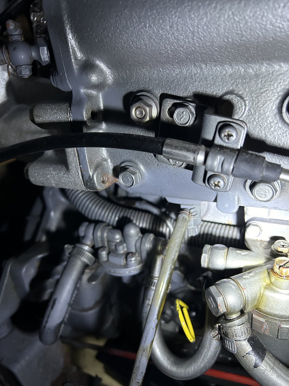

I just came from drilling out the hole for my remote mic on my boat, sorry I missed this posting, I would have checked my supply of filters. I‘ll be there later this week and get some more detailed information for you.
On my 3GM30F, like colemj stated “The bleed screw has a seal. Yours may still be stuck to the housing.”….It Happens.
A set of Dental Pick Tools will help get out the old O Rings if you can’t get it out, but you will need a new one for sure.

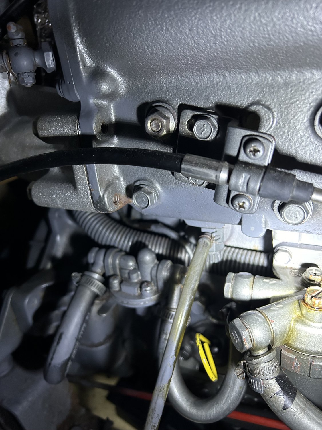

Have you also wiped it down and checked the banjo bolt for a leak, it could be there. In the picture of my filter housing it shows a diesel fuel stain, but thats from when I bleed it after changing out the filter, not a persistent leak.
This is the filter for the engine mounted fuel filter, it comes with the O Ring for the housing, not the bleed screw.
You can check with Old Port Marine in Newport, RI 401-847-9109. They have most, if not all the parts for your 3GM30F
Just in case…..My other filter is a Racor No. 110A (Filter is R11T) Yours may or may not be the same.

I have noticed a very slight amount of fuel on the feeder line between the lift pump and filter housing. I picked up some appropriate compression washers for the banjo fittings and will install them when I am next down there. My question: would it be worth it to just replace the entire filter housing as well? It only costs $85. I am chasing a hard starting issue and want to just eliminate possible failure points.

O-rings are standard sized using the ID and the cross section.. Since the part # has the "44" in it, I am gonna guess that the ID is 44mm .. The parts manual does not show the cross section number, listing it as "S" but again 3mm sounds about right.. the OD would be 50mm (44+3+3)
