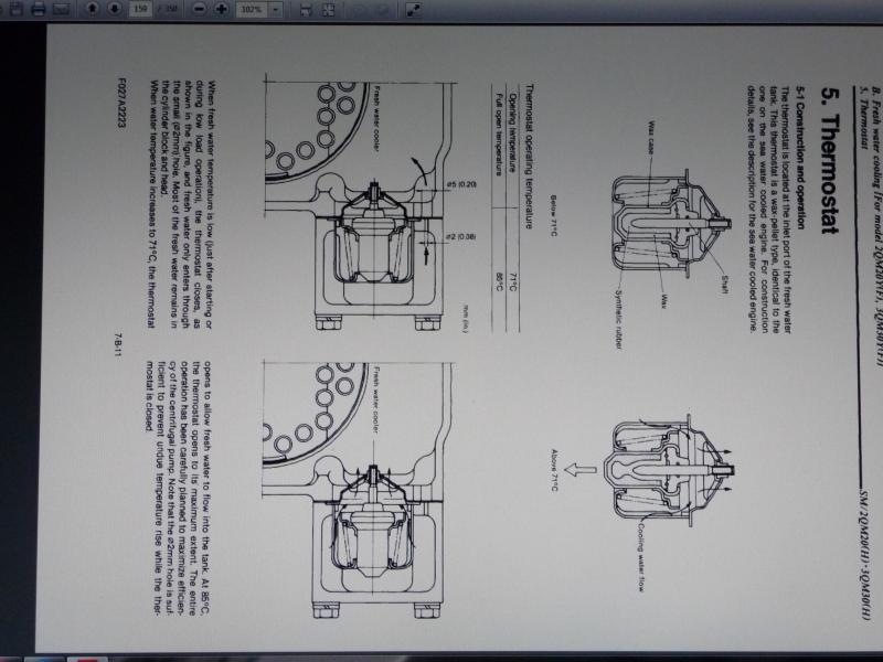

Mike, if it is the factory conversion, the manual says that the thermostat will fit but the opening and full open temp set points for the fresh water cooled one are higher. The thermostat for the raw water cooled engine are 42C (108F) opening and 52C (126F) fully open.. for the fresh water thermostat, 71C (160F) opening and 85C (185F) fully opened.

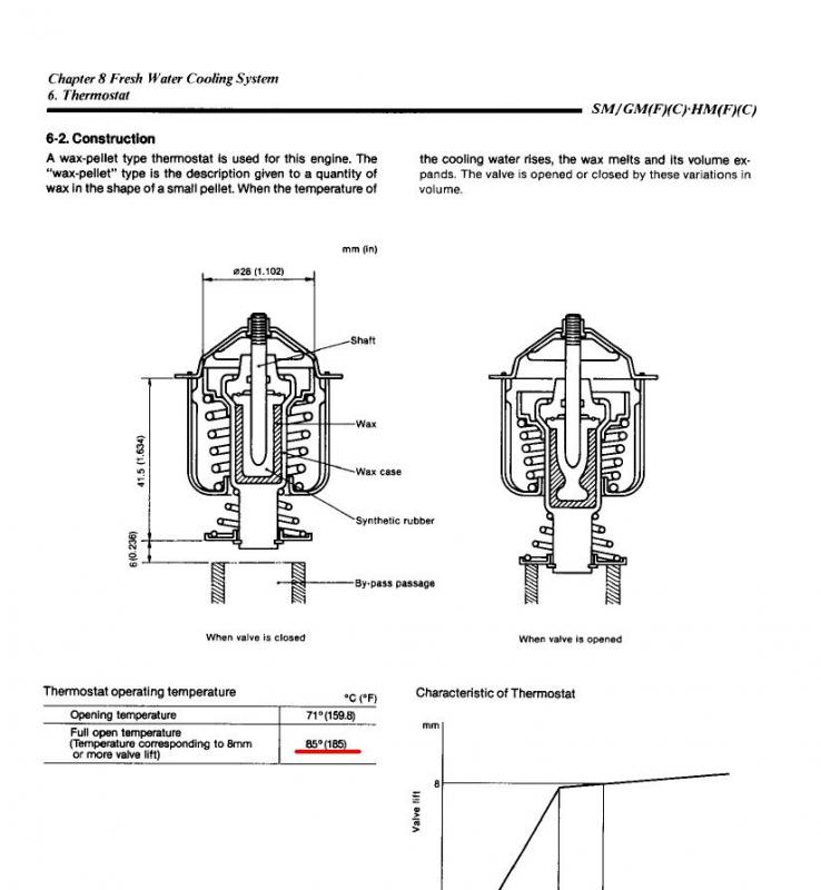

............. because with the advantage of having the factory service manual in one hand and a rum and coke in the other, it looks like you're right within specs.
As shown in the manual, the full open temperature of the stat occurs at 185 deg. F which is what you are presently showing.
Looks as if you have a perfectly good thermostat on your "( fresh water cooled unit)" so why change it ?
Don't hesitate if you require any further engine specs, however it's going to cost you some photos of what you're doing down there. I spent three years working in the Bahamas on a cruise ship destination island and it was the greatest job I've ever had.

First, the thermostat for your QM is very different from a thermostat for a GM.. If you look at the picture I posted, it shows coolant going around a movable plate which is just below the "arch" on the thermostat. That plate is what regulates the water temperature by opening or closing the coolant flow. First. be sure that the thermostat is at fault by putting it into boiling water.. if the passage opens, you probably don't have a thermostat problem. If it doesn't move, then drill a hole in that plate to let more coolant through. Do not remove the thermostat for normal running because that will affect the coolant pump performance. The "arch is the part looking left in the bottom two pix and looking up in the top two pix of my post. Again his is stuff pertaining to the factory fresh water system.. if it is not a factory system, my info may not be correct..
