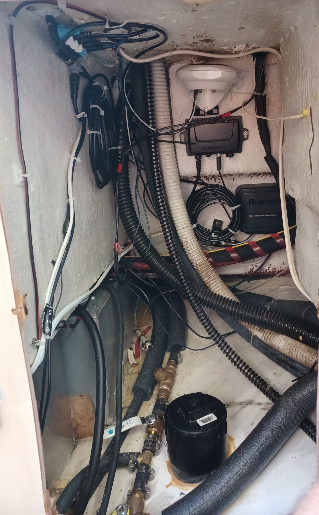

I got my EV-1 installed behind the drawers in my C30. I checked the location with the app and it showed only 5º deviation but some other locations in the cabin showed 20º or more. If I got within 12" of my speakers, it pegged the meter at 90º.
