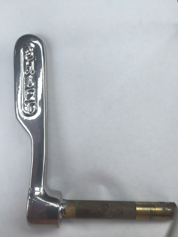

Just got my shifter and throttle handles powder coated in super chrome. They look like new, two days thirty bucks! image-3252658257.jpg

Just got my shifter and throttle handles powder coated in super chrome. They look like new, two days thirty bucks! View attachment 87312
WOW ! Glad that it worked for you too. Quick service and great price. Keep the contact in mind. I'm thinking about getting the turnbuckles done next winter. They are still good but have lost all their shiny appearance.
