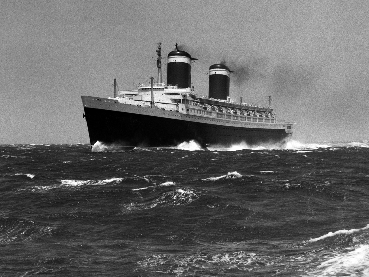

What's the hull speed on that?
I guess the description was not clear. They did 38 knots in trials and spec that max speed at 43 knots.

John, two different pieces of data. I interpreted Daveinet's question to mean "what answer do you get when you multiply the square root of waterline length by 1.35"? So I gave it to him. Clearly they exceeded hull speed, which you can do if you have enough thrust (horsepower).
24,949
Remember talking to one of the engineer officer's on our trip home in 66. He said that the power in the boat was unbelievable. It might have been able to exceed Hull speed. At 16, hull speed calculations were a bit out of my normal activity. But I could look at the ship and hear the discussions of the crew. They knew what they were talking about. I was still thinking. This ship is sailing form South Hampton to New York. The same route as the Titanic... :yikes: my dad arranged a visit to the bridge with the Captain. Way cool for me. They have the ship on the east coast and are trying to rebuild parts of her as a historical site.

Yes, hull speed and max speed may be unrelated. I was curious how close they were to hull speed and if they were exceeding it.
24,949
Dave I think they were exceeding hull speed based on their power system.
For the time, I understand, that the hull design was innovative.
Here is a link to some of her propulsion data Specifications of SS UNITED STATES
Here LWL length was 940. Using the standard hull speed calculation you get 41.08 knots.
So the reported 43 knots is beyond the calculated "Hull speed".
