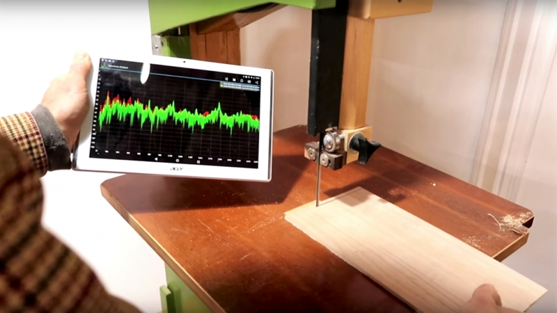

Don't waste your money on a tach:
I would think you should be able to see your exhaust pulse pretty well.
Depending on your phone, there are other apps that will strobe your flash just like a timing light.

That guy has got some brains huh?
It depends what his career is in real life. In my past life I was an audio engineer, so what he is doing makes perfect sense. Now that I think about it, you could probably just use a frequency counter app. Put some sort of noise making flapper on the flywheel and measure the frequency of the noise. I use a frequency counter app made by Keuwlsoft for Android.
