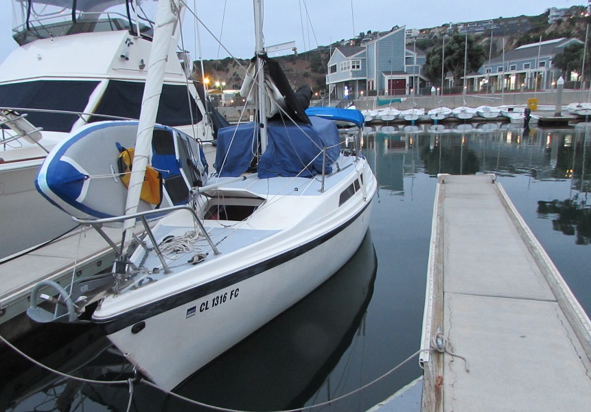

First picture.. looking down into nearly 2500 feet of Pacific Ocean water yesterday. Second picture from this morning.. last day on the water at Dana Point before heading home

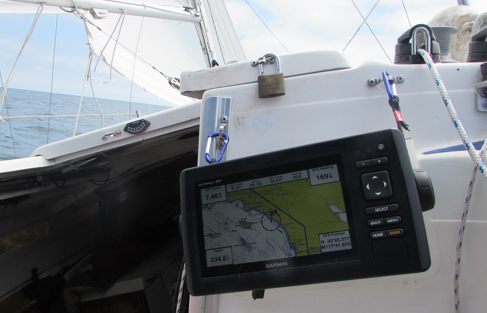

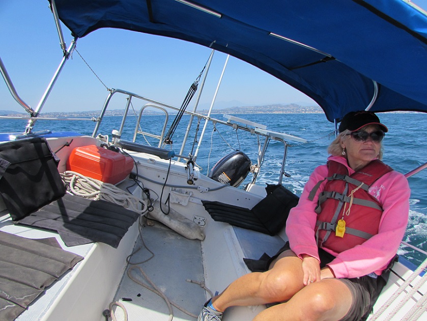

One more from today sailing the Pacific Ocean off of Dana Point CA under auto pilot. Slightly notable is that our boat speed on a reach is 7.48 mph (6.5 knts) which slightly exceeds the theoretical hull speed of this boat (26S at 23.5ft).
Likes: BudGates
May 18, 2017
52
MacGregor 26S Piscataqua
6.5 knots! What were the conditions that allowed that? We usually get 5.5, never more than 6. Were you reefed?
walt
Jun 1, 2007
3,556
I dont often get to those speeds but the boat will do it. I would have to guess at the wind speed so I wont (you can see the water in the picture) but it was still under where I thought I needed a reef. I have about a 5 foot traveler and I think it was about all the way over to leeward. Tight vang and moderately tight backstay. 110 jib on a furler sheeted from the inside. We were mostly on a reach, maybe with a little downwind. I also have this crazy mod on my main sail http://analogengineering.com/sail/mac/sail.html that after all this time.. think it does make a difference especially in conditions exactly like I was in (windier, either mostly reaching or upwind). This is something I discovered by accident a bunch of years ago and have tried it on a bunch of sails and will put it on the next sail I get. Oddly, I was still fairly heavy on the bow of the boat with an inflatable kayak and SUP up there (deflated and inside) plus about 8 gallons of water. I had about 4 gallons of gas all in the back. The Bimini was also up.. It was windy enough to blow the new hat I had bought from West marine before the trip off and into the water and it sank before you we could get to it..

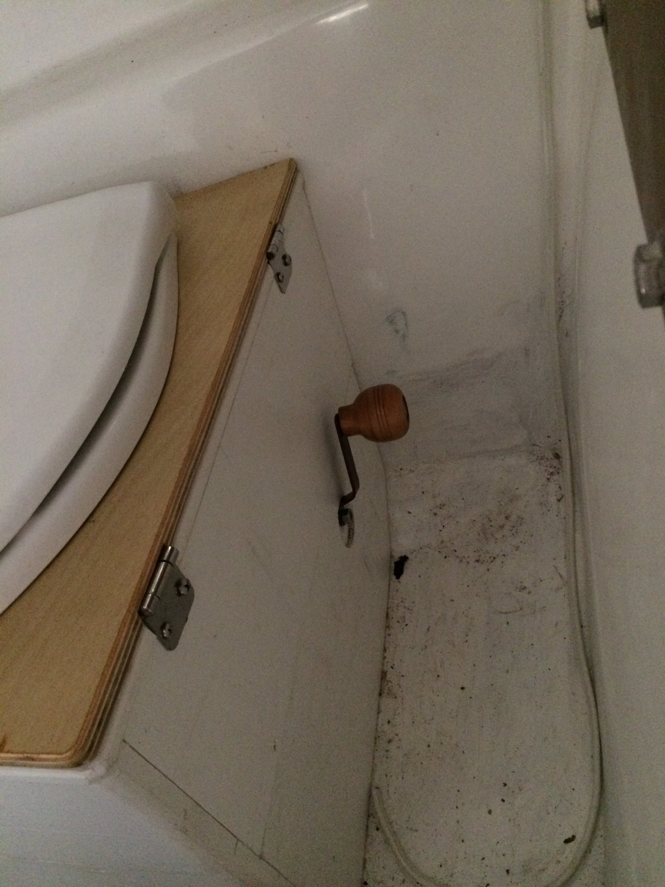

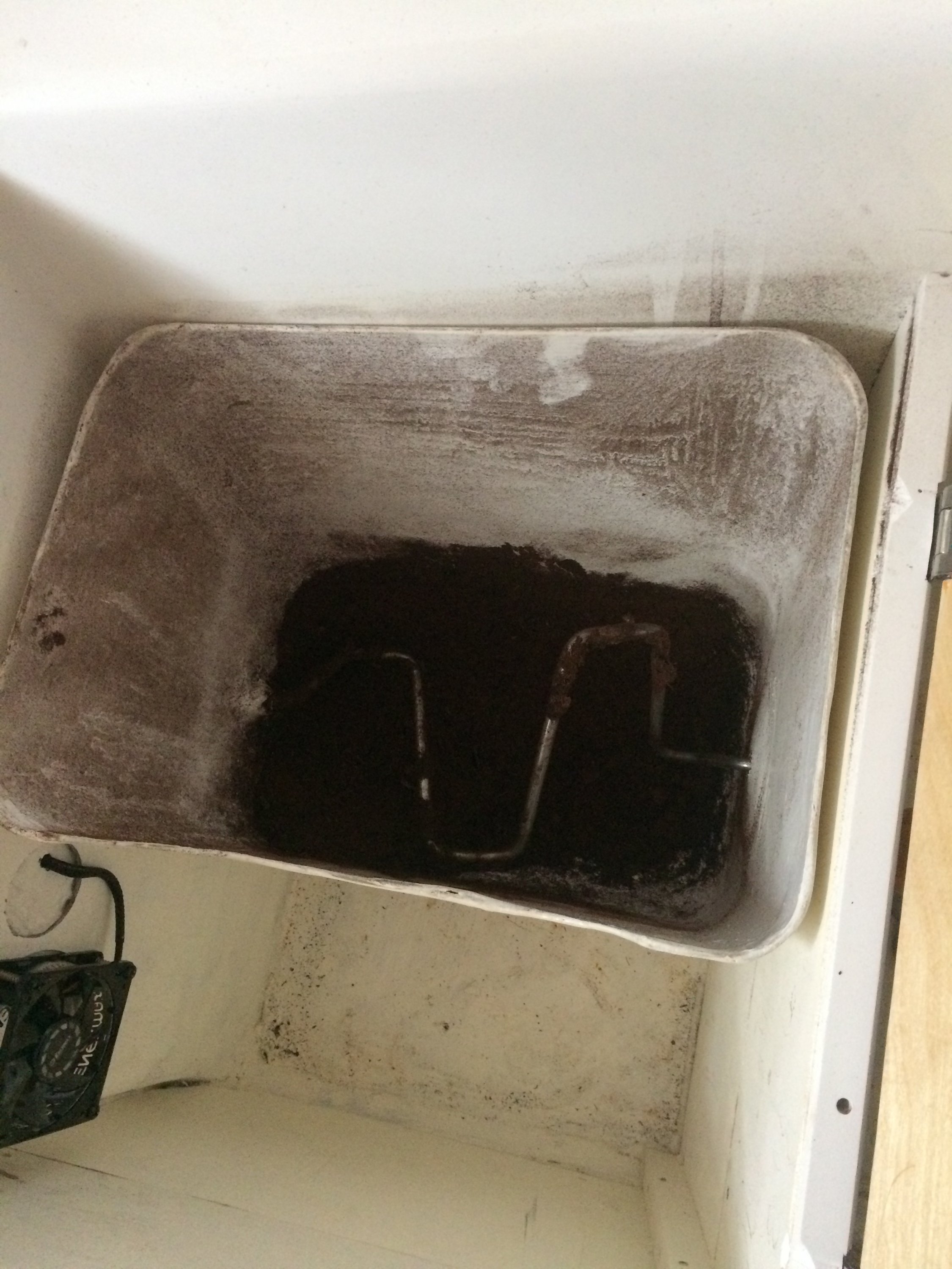

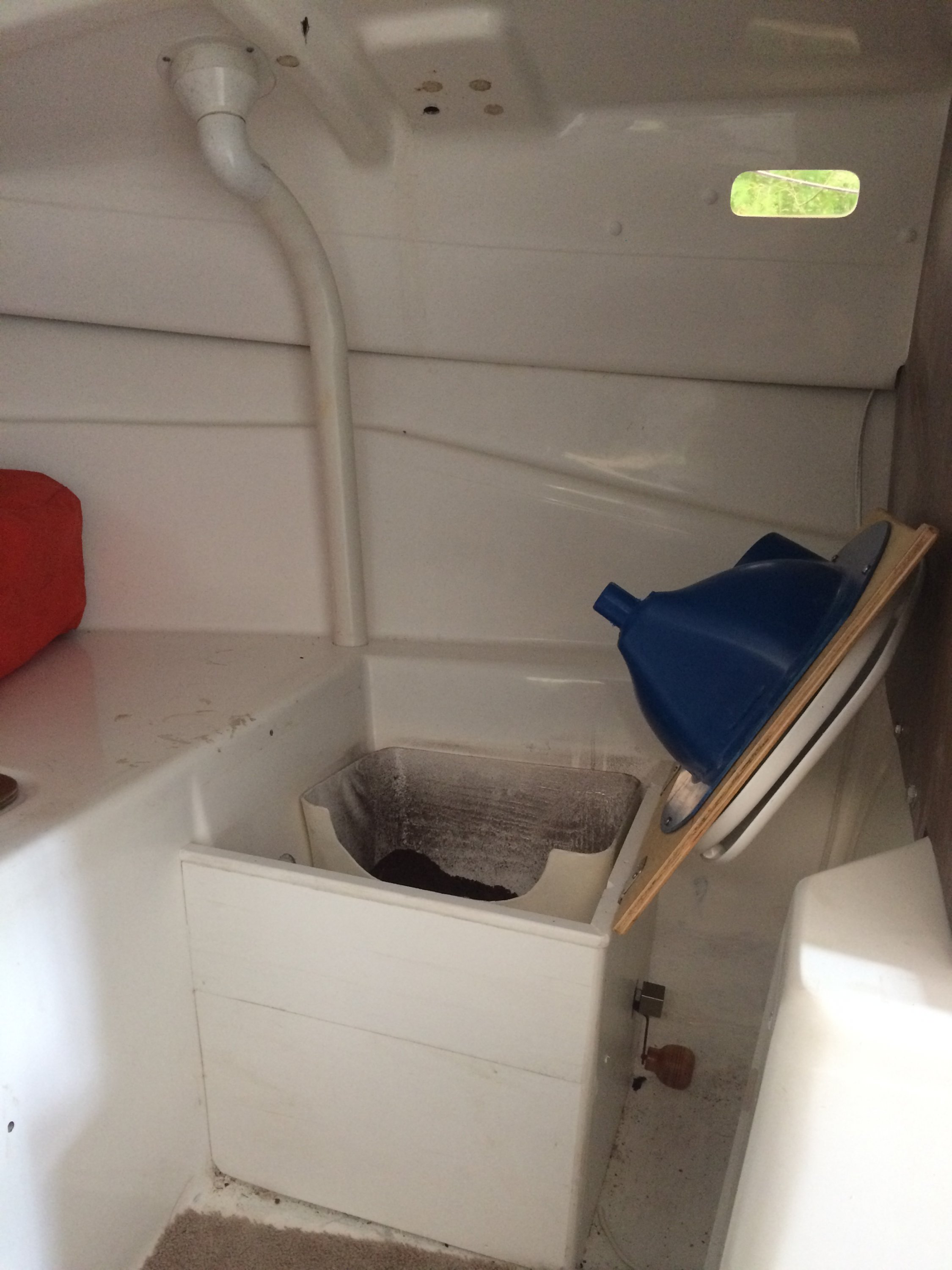

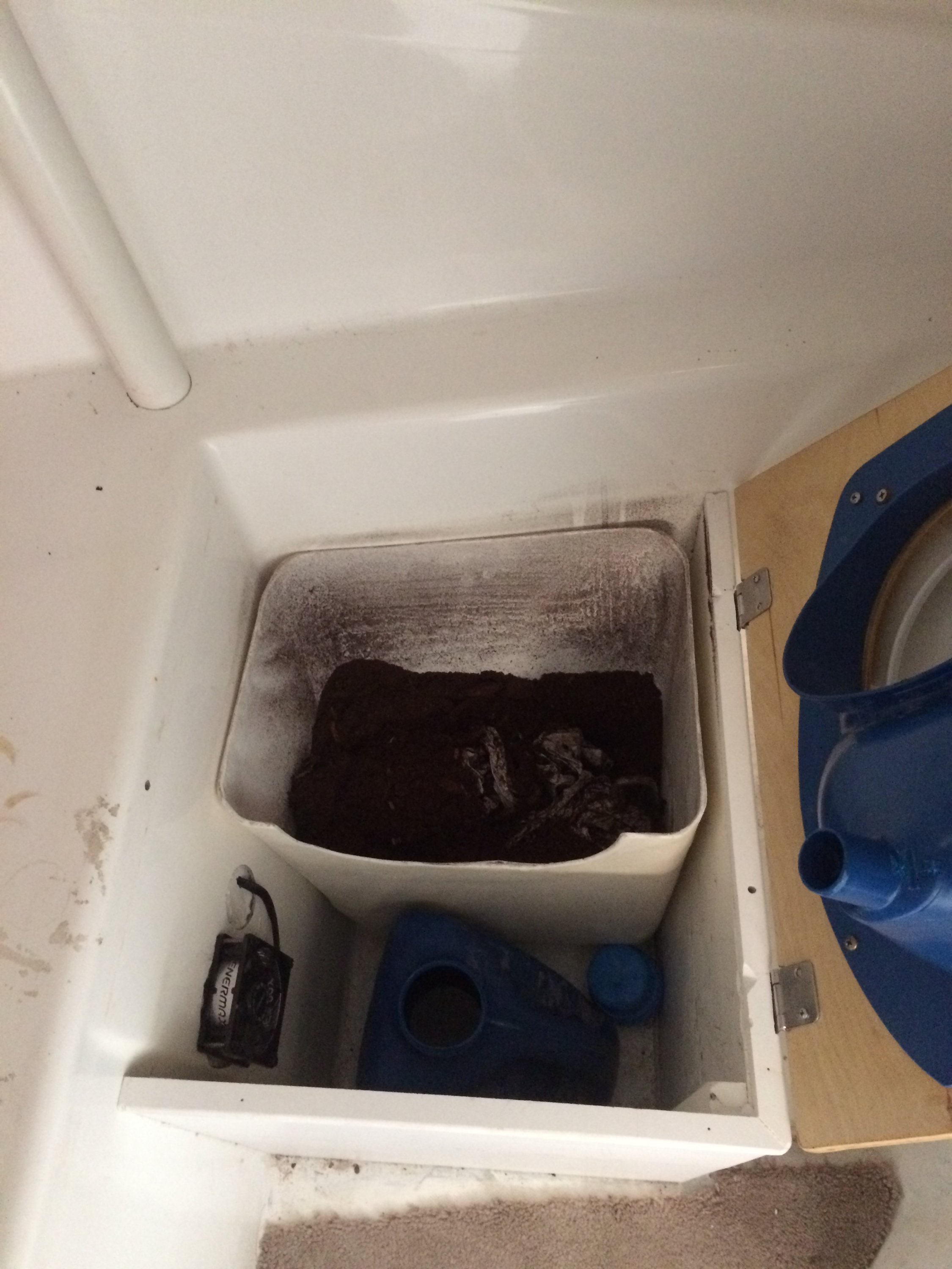

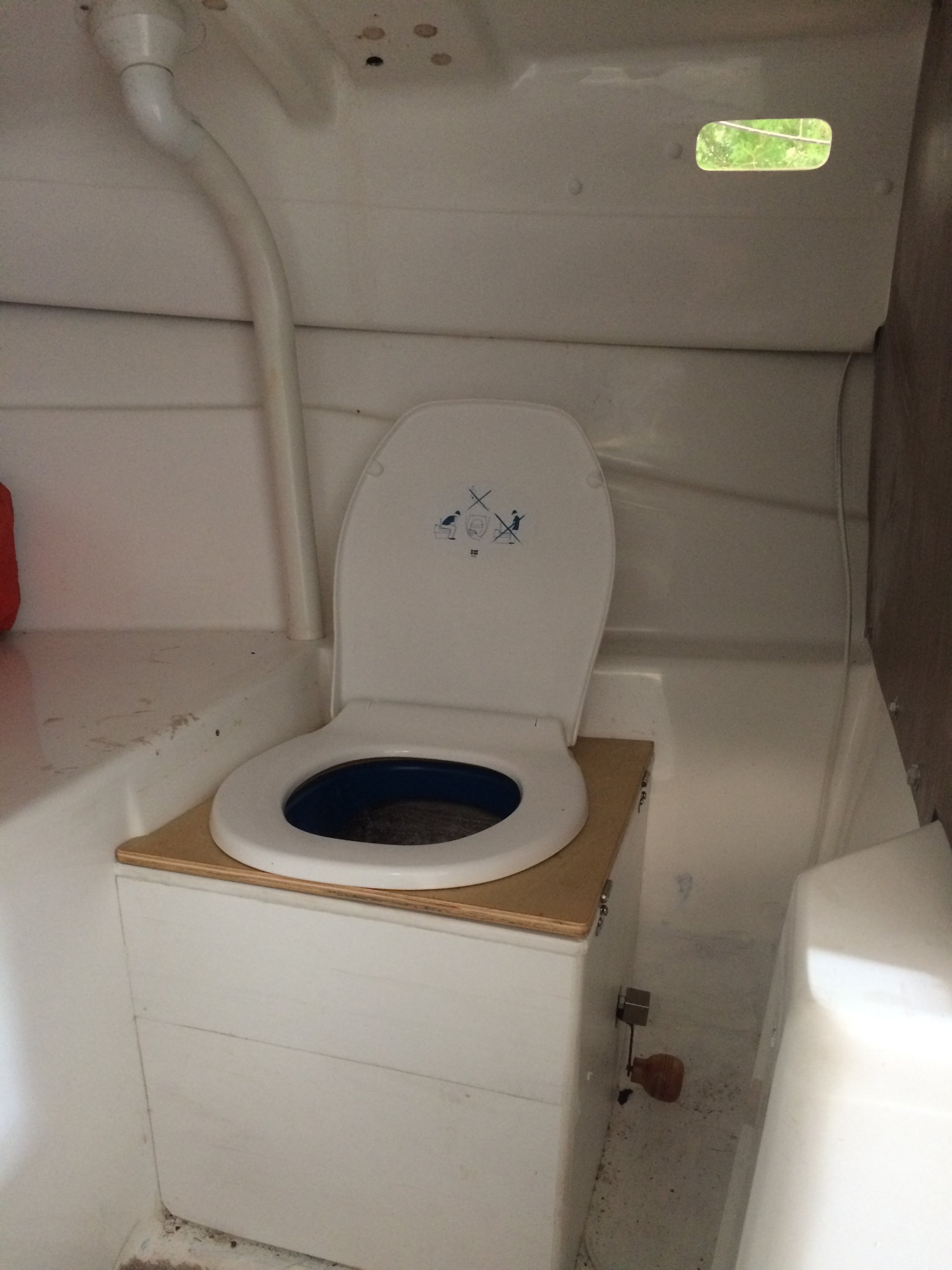

Kristen and I have continued with our interior mods. Here's one we really like. Neither of us like the idea of using a porta potty for long trips. And the thought of a marine toilet system is worse. So we looked at composting heads. But a 26S doesn't have enough vertical space. You'd have to use it with your neck bent. So I made one. I cut out the false floor where the porta potty sat, re-glassed it for maximum vertical space (i.e. Down to the top of the tank) and made a custom fiberglass bucket for solid waste, found a gallon-plus laundry detergent bottle, and bought a Separett toilet bowl, seat and lid.
A solid 3/8" stainless rod yielded to my torch to become the auger. Peat moss from the garden center completes the solid waste side.
There is very little smell, but just in case I added a very quiet computer fan that vents up through the roof.
It works great!

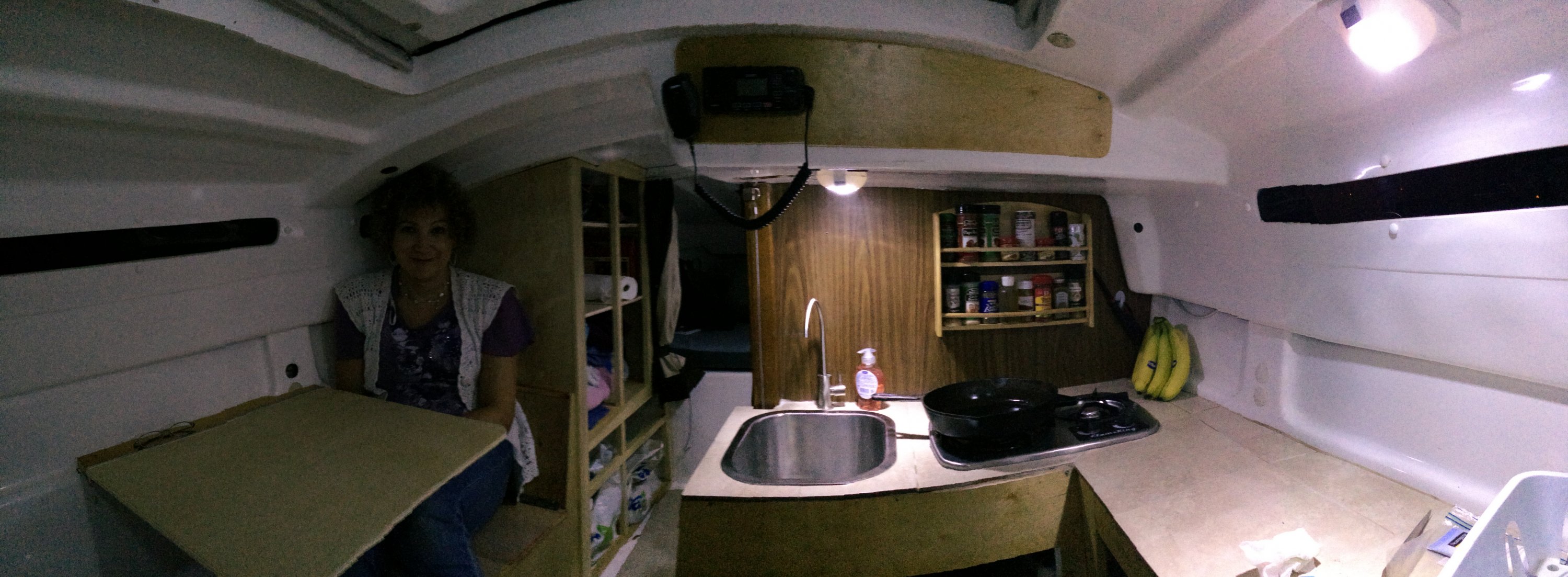

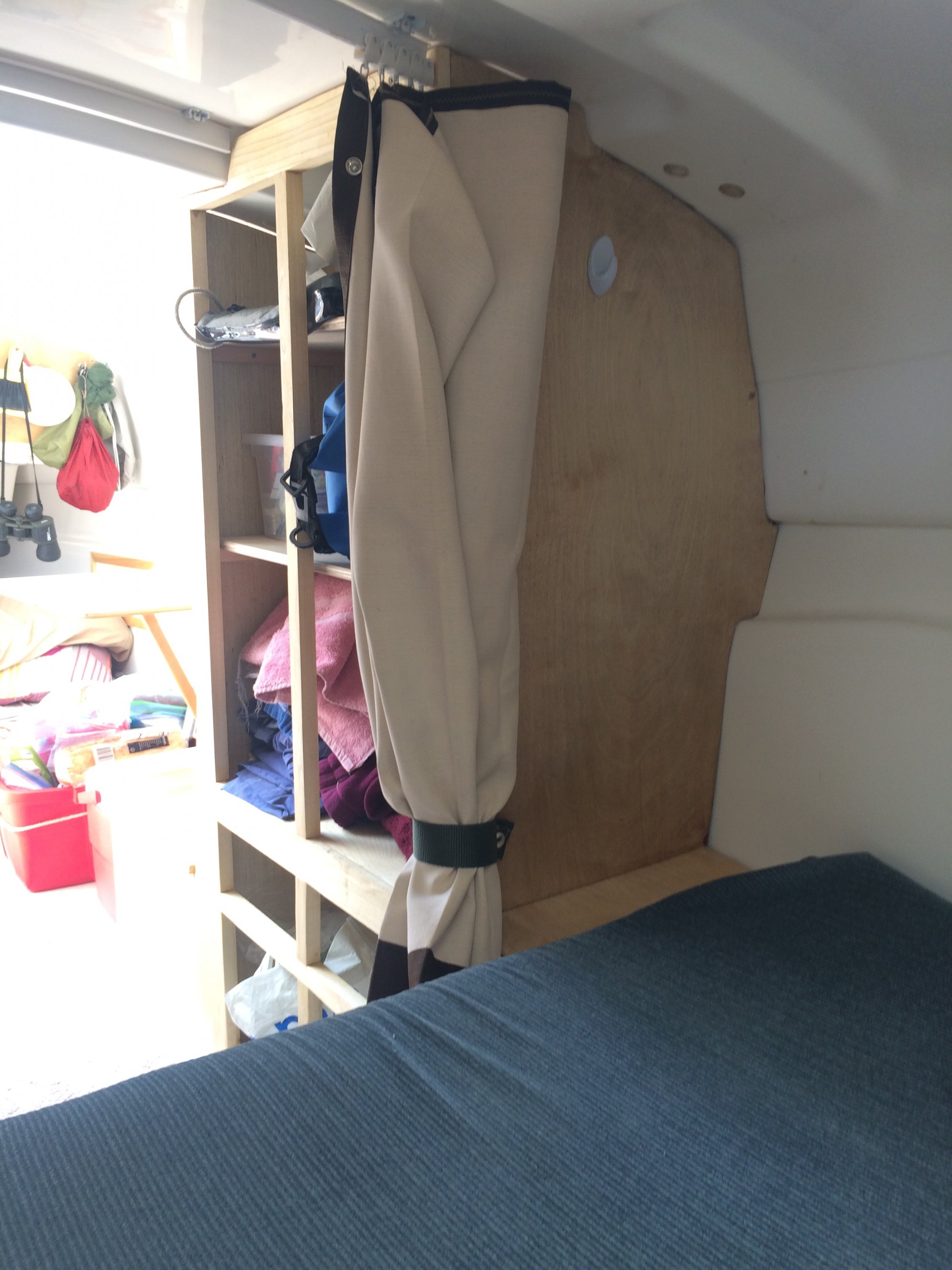

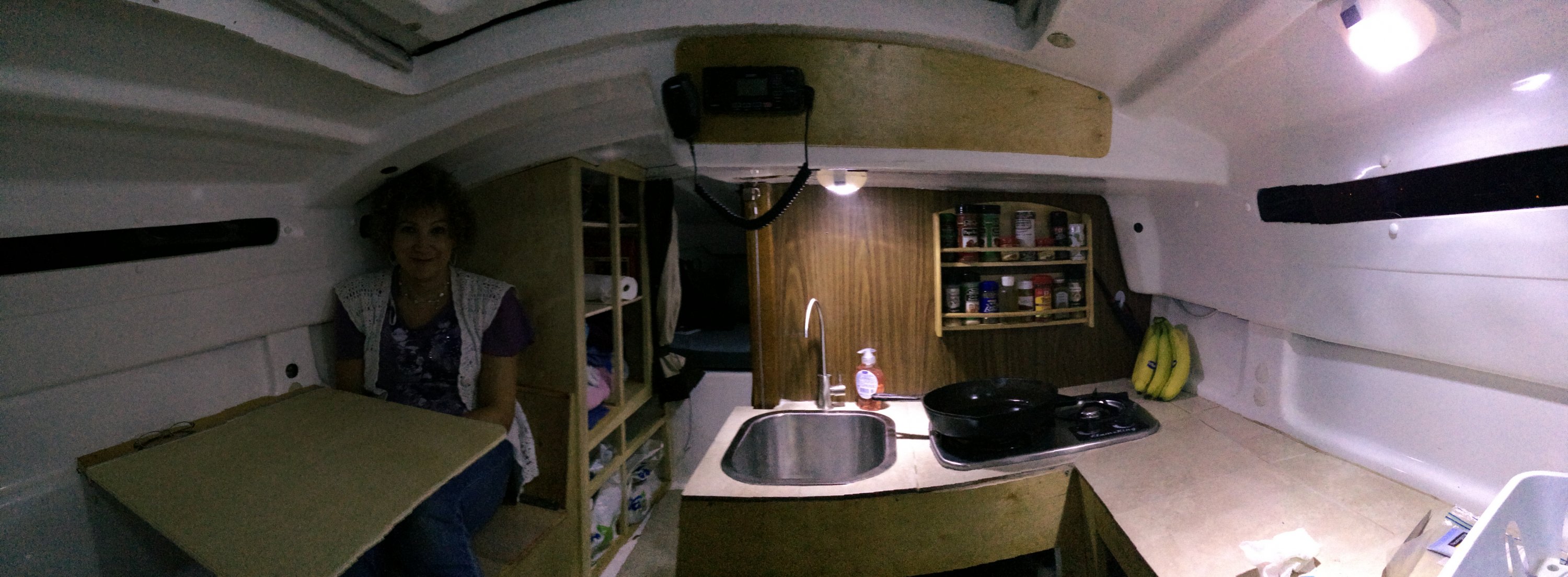

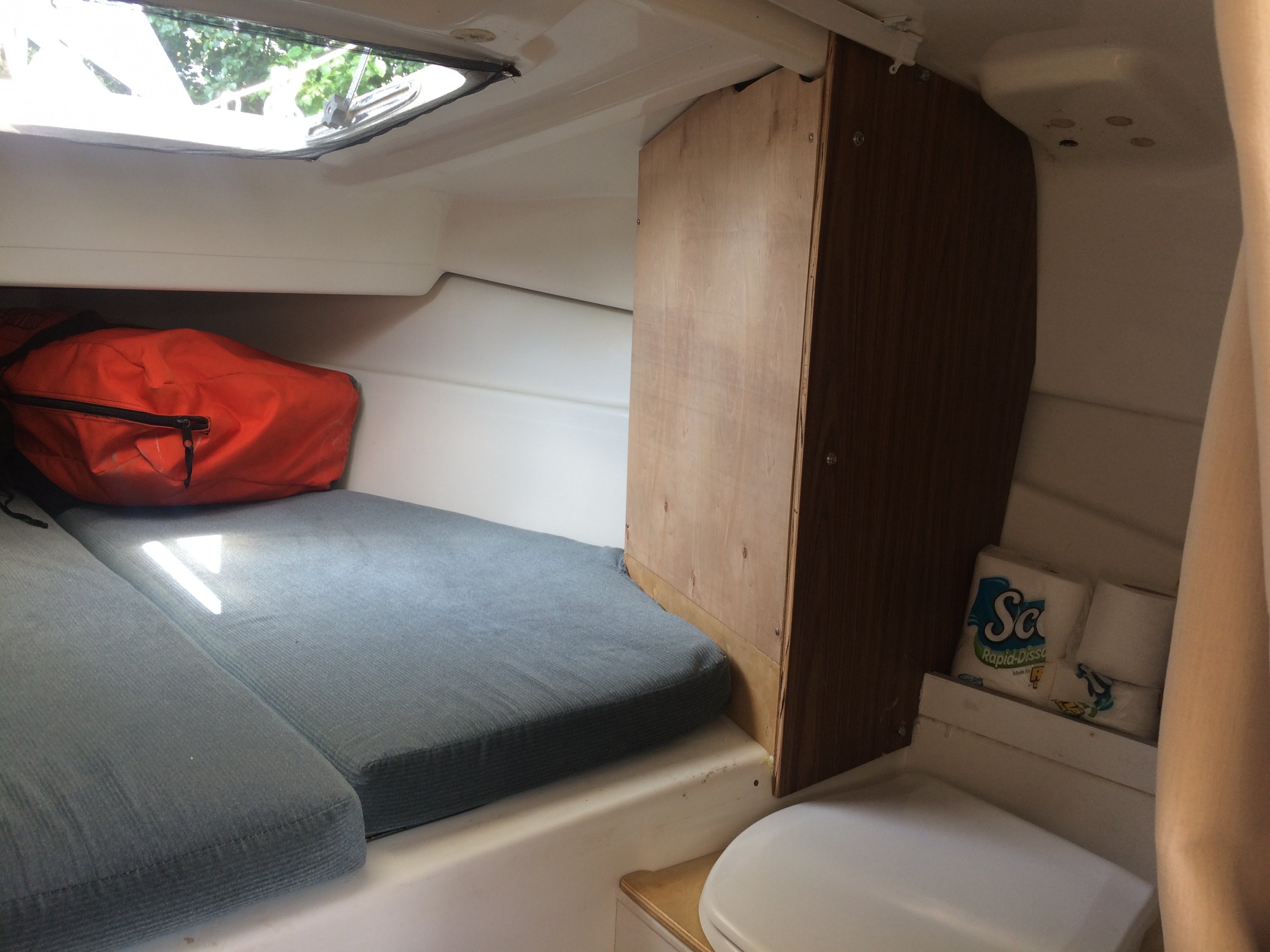

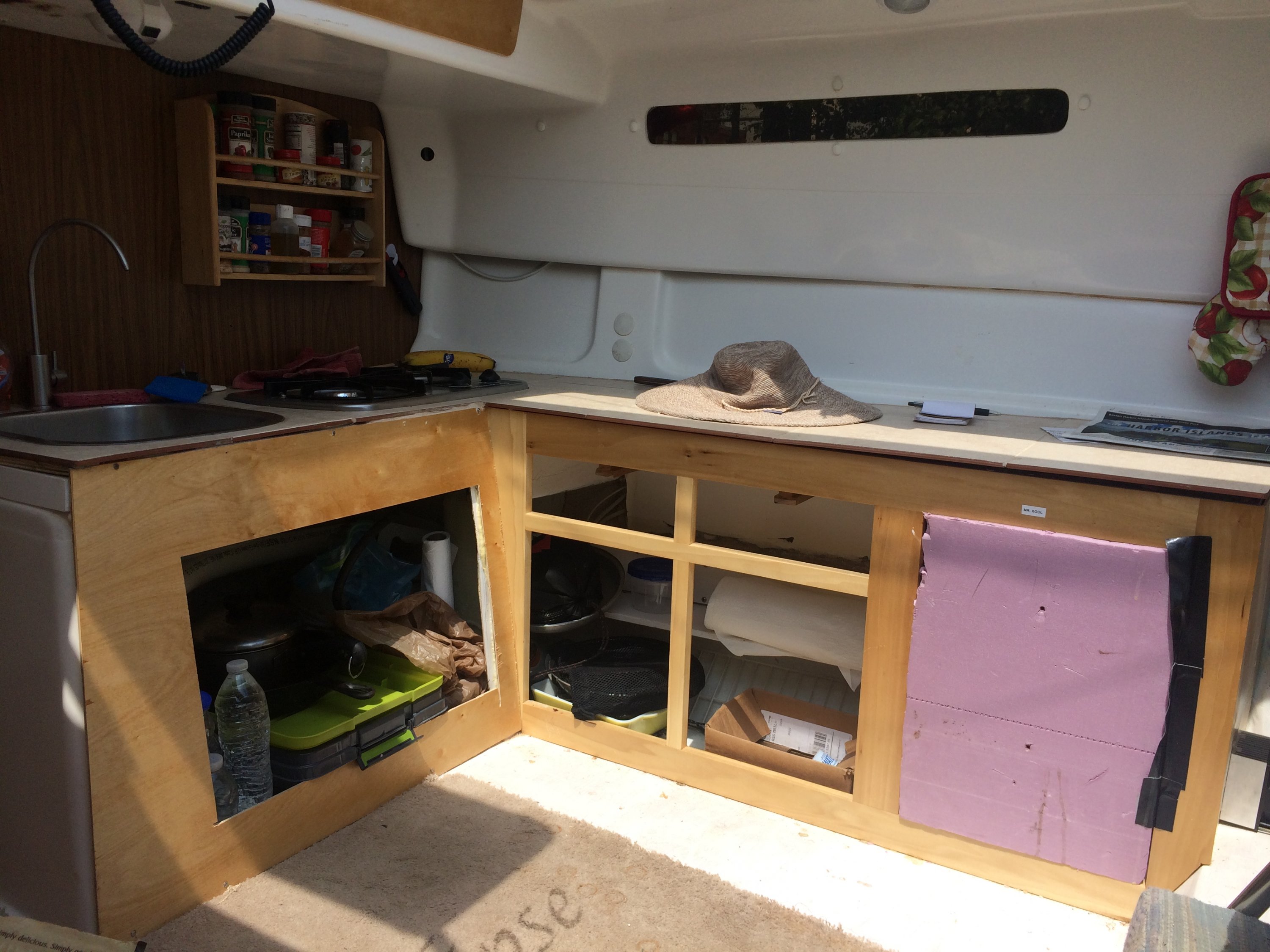

Here's our interior mods to date. Cabinet doors are next. We cut out both setee benches and fiberglassed it over to create a wide flat floor. Cabinet faces are poplar, sides are birch veneer plywood.

Nice.. The composting potty with the venting fan is slick!
