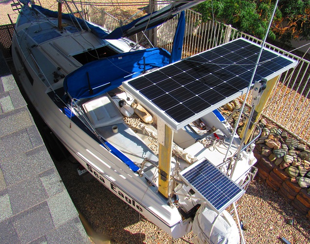

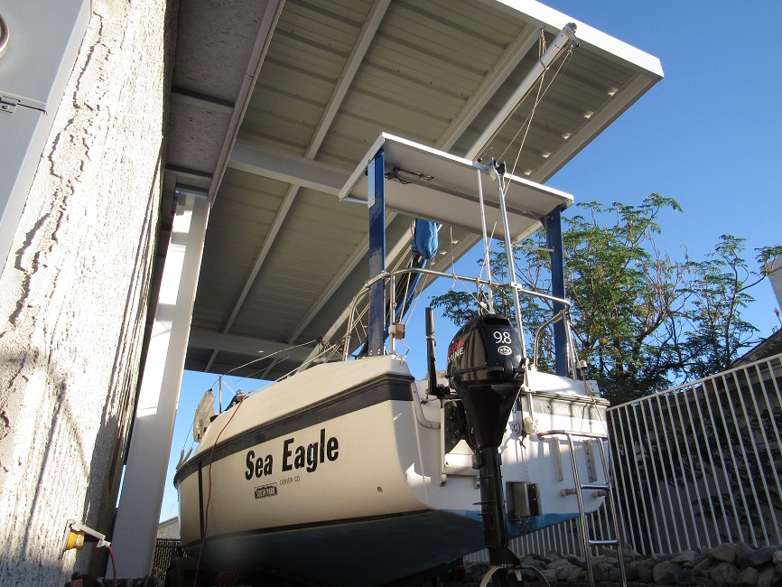

Progress on the solar power fridge. Electric fridge is a HUGE step in power. The 20 watt panel is still on the boat and I could get by easily with this panel on week long trips. Fridge is going to require the much larger panel which is the compromise you have to make. The large panel is 59 inch by 26 inch (size for 140 to 160 watt panels, this one is 160 watt) Ive enjoyed this boat for 10 years now partly by doing things like this.. changing things up.

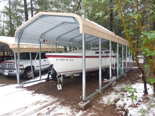

Our sailing season just has a lot more interruptions during the winter time ;) . The drive through "boat port" for Silent Running has worked out really well. if a day does come along during the "off" season, that's sailable, it's easy to just hook on and go. in fact I have another port ordered to put the newer little day sailer (Aye Pod) in. ~ 1K each, but they last forever without dealing with tarps etc. you can still get in the boat whenever needed, and air circulation/condensation situation is a lot better than when using a tarp.

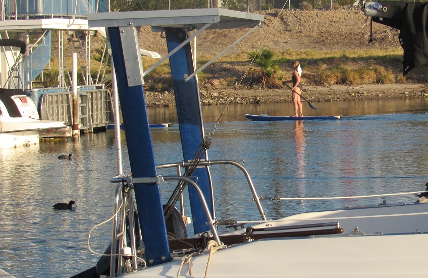

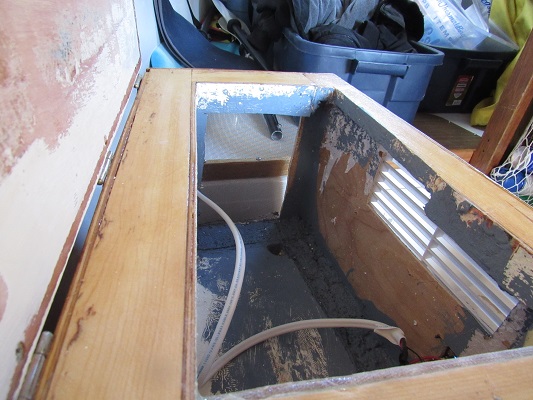

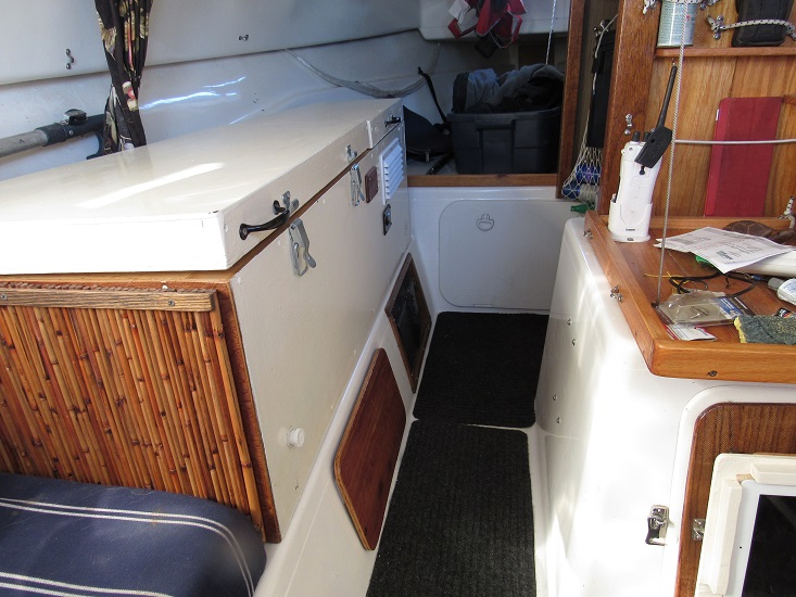

First picture. Cantilever structures.

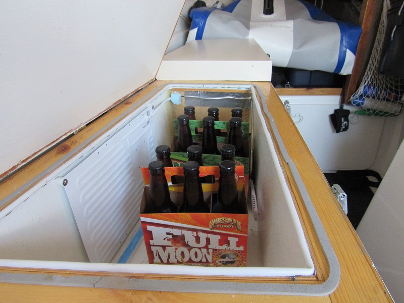

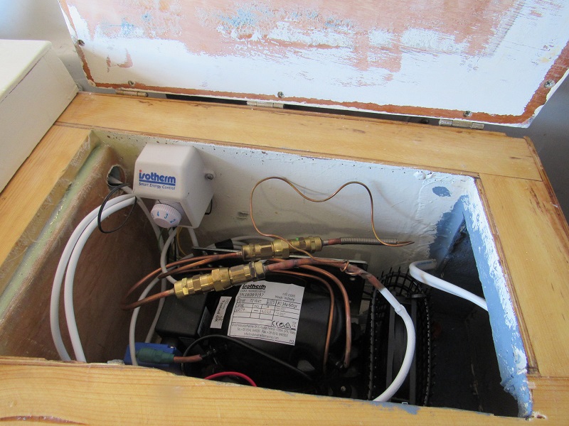

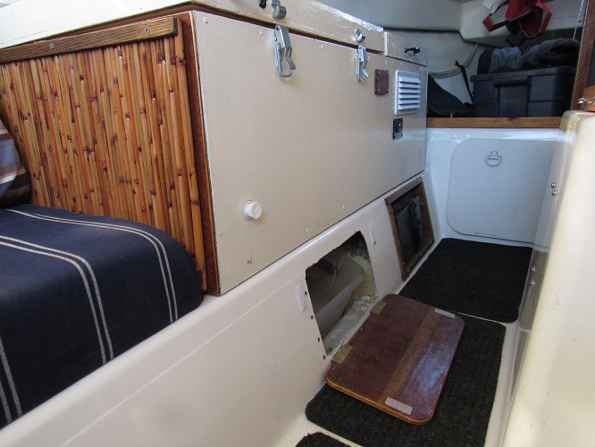

Rest of the pictures.. The guts to the electric fridge not here yet but the old two chamber ice chest has now been converted to a single chamber cold box attached (and thermally isolated with about R18) to a compressor box. The compressor box needs to be well ventilated allowing cold air in at the bottom and hot air to exit at the top. The whole back side of that compressor box just has a screen and there is a louvered vent on the front side. The cold box still has a drain so that I can still add ice if needed and also to make it easier to clean.

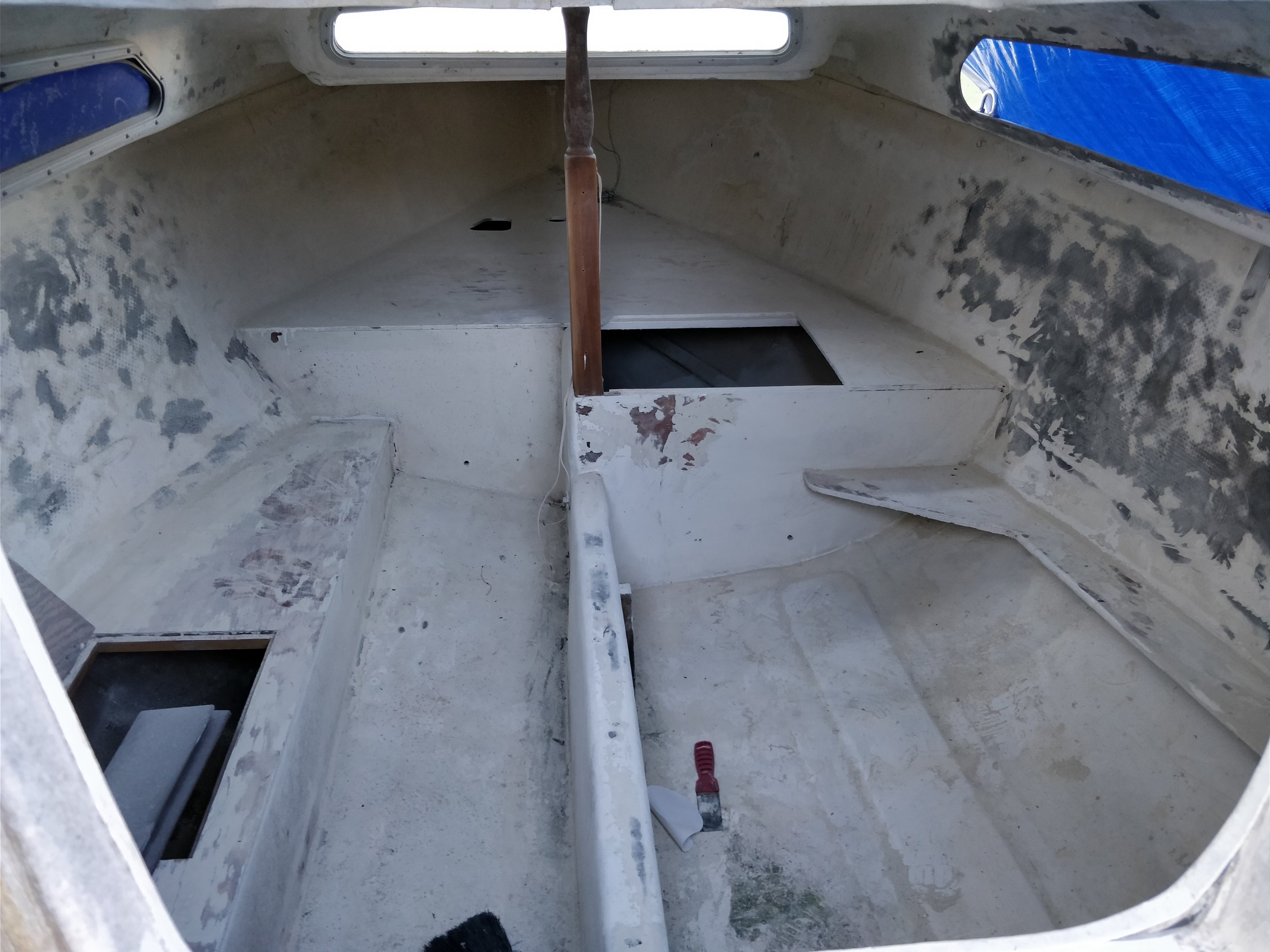

I also had an area under the fridge that was a hassle to get at and on our last 10 day camping trip wished I had another easy access 18 quart tub so... I couldn't help myself and the saw came out again and I cut another big ol hole. Added a hinged lid that is held in place by both gravity and Velcro until I figure out how to get rid of the Velcro later. The sides of the new cut hole are reinforced with AL angle on the inside so that I dont get any distortion during the hot summers here.
Boat should get put in the water later this week with a working electric fridge stocked full of beer.

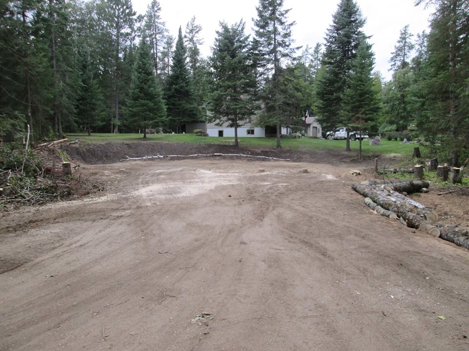

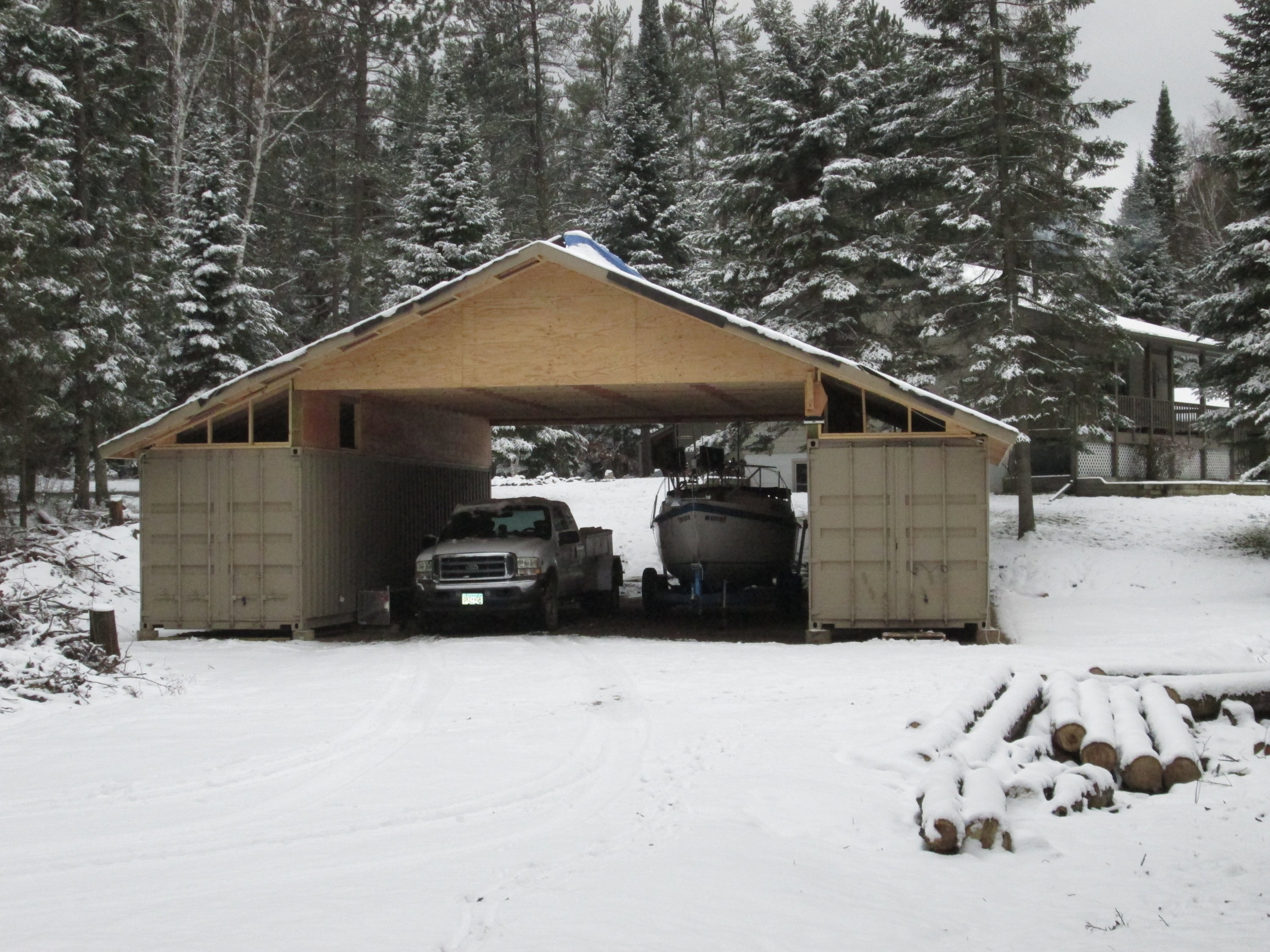

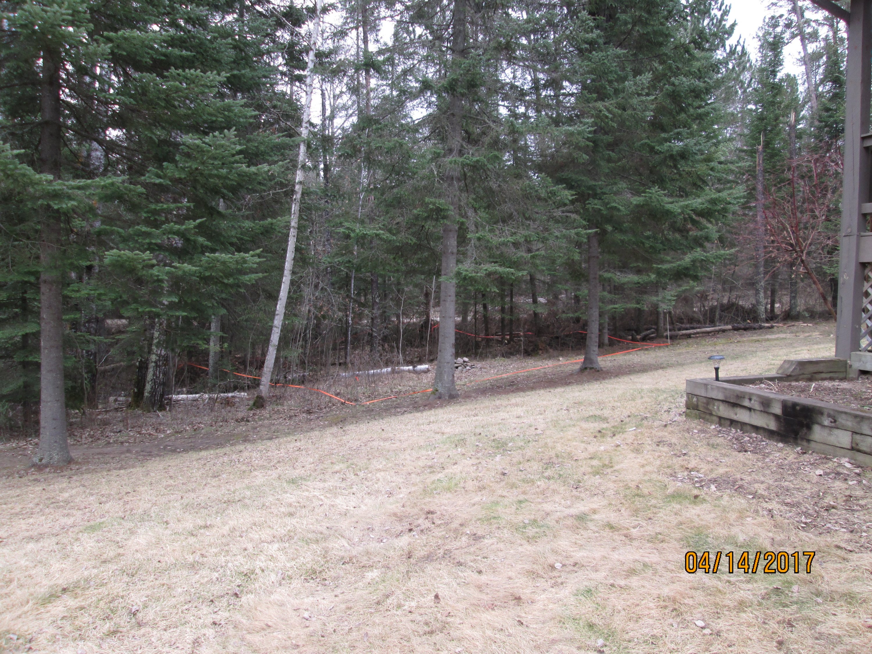

I've been rather busy since my retirement and haven't had time to let people know what I've been doing for my Mac. Now that the weather has turned I have a lot of time to get caught up.
Here's what I started with.
Then after cutting a LOT of firewood it's time for some excavation.
The wife has a lot of construction pictures but I can't seem to find them.
time passes...
Then as soon as the felt goes on the roof winter hits with no breaks in the foreseeable future...
I tried climbing on the roof to install the shingles anyway but it was so slippery I decided to wait ... maybe untill spring.
I may not have gotten quite finished but at least Miss Behavin' has a cozy place to stay dry. ;)

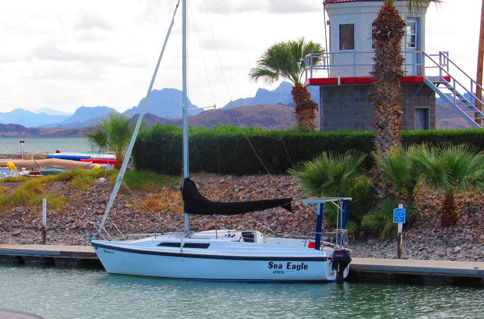

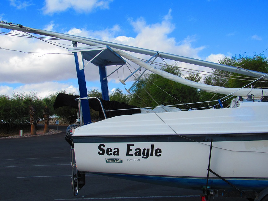

Retired south guy is liking Mondo panel.. Turned the electric cooler on this morning and so far it has worked perfectly. The 160 watt panel seems to have a lot of power margin which is overall good. Myself and my dock neighbor tested the beer temp, it was a little too good. I also raised the mast this morning.. no problem.

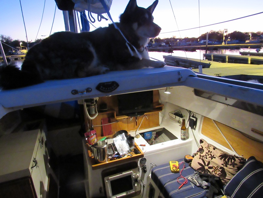

Working on the solar powered fridge with the solid state relay that shuts the power off to the fridge at night. The solar panel output is the signal used to turn on and off the solid state relay. I took this picture right at the point where the power automatically switched off. The power to the fridge switched back on this morning in about the same light - sun just barely coming up. Helper is making sure there is no trouble from the local ducks.
