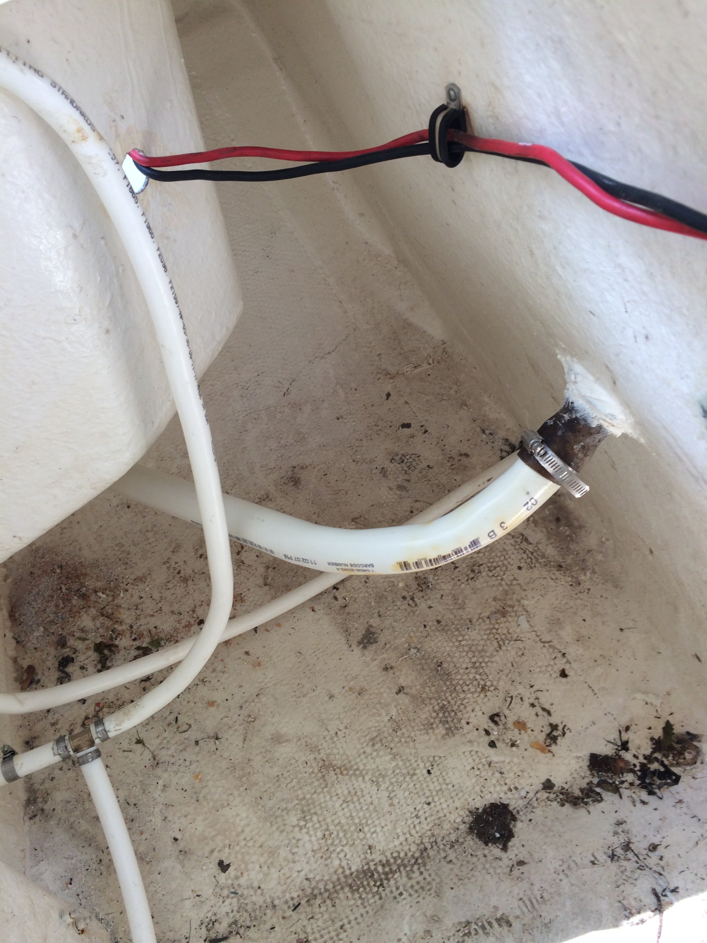

My photo of modifications in the lazaret is hard to see what's been done, but here it is. You're looking down through the open hatch. Wires to outboard above, new PVC pipe band clamped to a stub of the original plastic hose, and bilge pump pipe below that. The bilge pump pipe loops high before exiting through the through-hull fitting. View attachment 137593
So where is your bilge pump located?

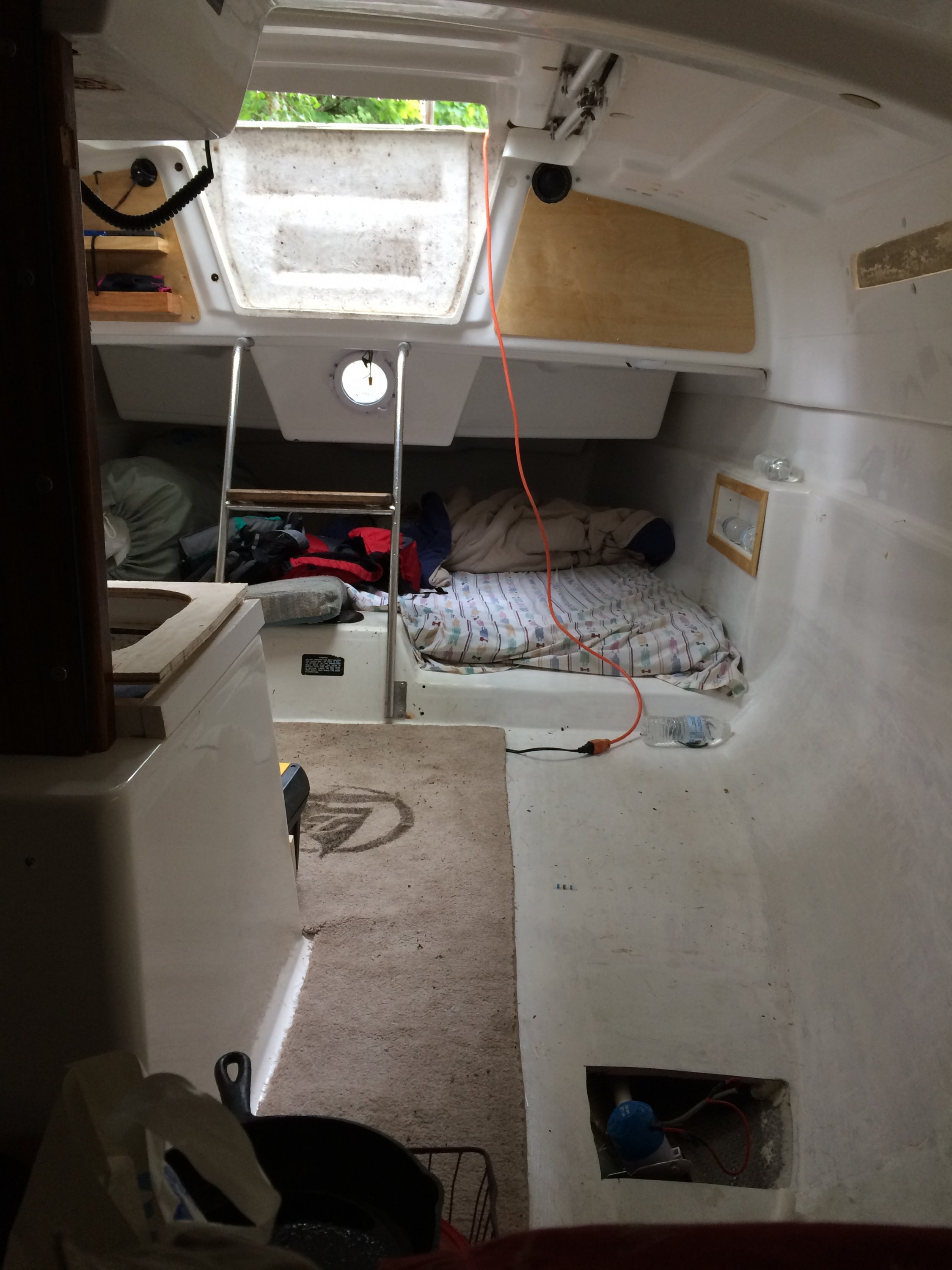

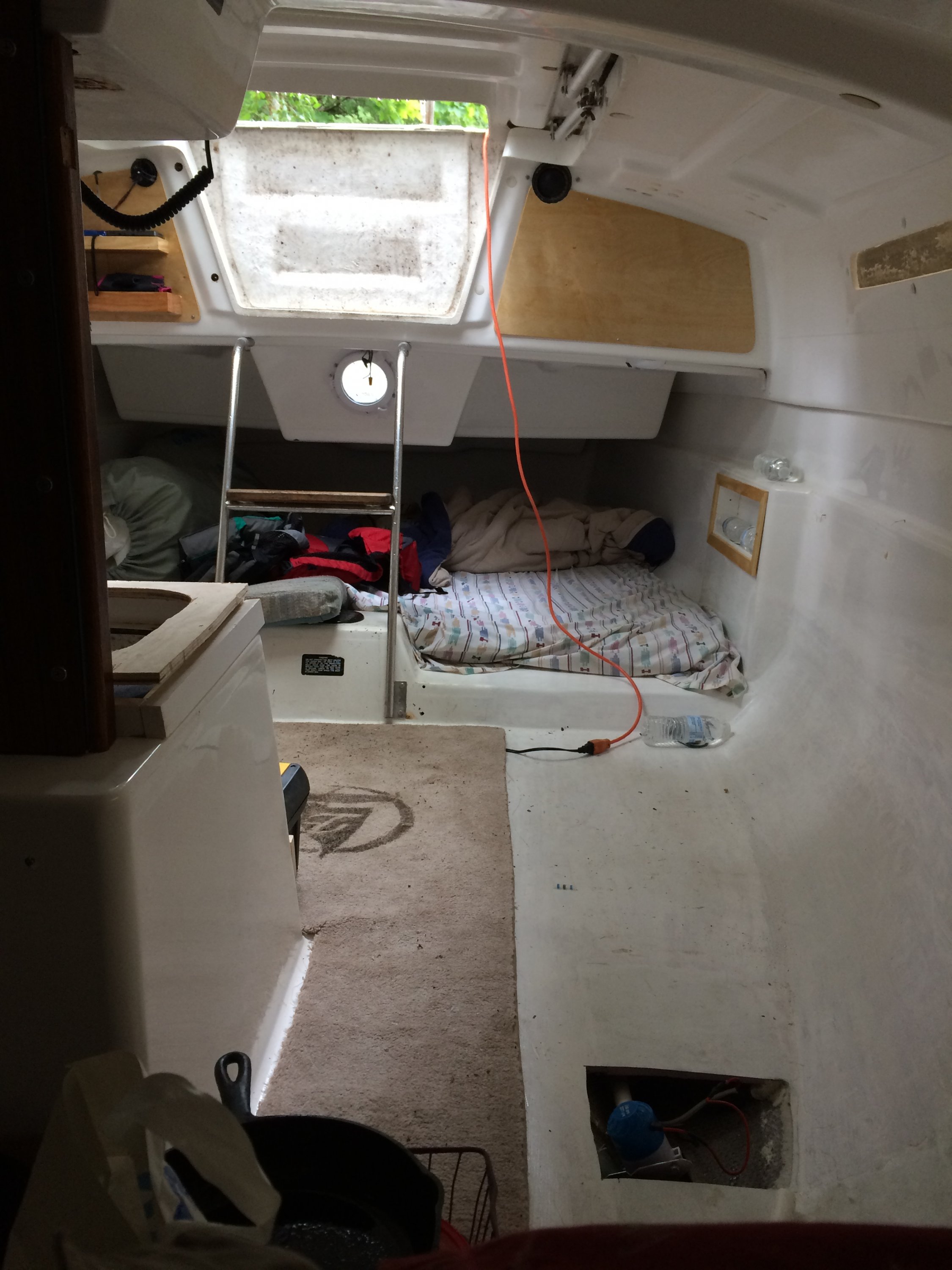

IMG_2500.JPG When I took that photo, the bilge pump was not yet installed. Now it is! 3/4" pex piping fits the pump and through-hull. Without the long setee benches that everyone else has, my choices of location are limited. There will be a cabinet on the port side just aft of the V berth, so the pump will be incorporated into the base.
Nov 30, 2015
217
MacGregor 26S Lakehills, Tx
View attachment 137707 When I took that photo, the bilge pump was not yet installed.
OK, I see what you did there. I'm still thinking the pump could be moved a bit further aft to the lowest point where water will collect.
The interior sure looks different without the settee bench.
What are you going to do with the rest of the space you opened up?

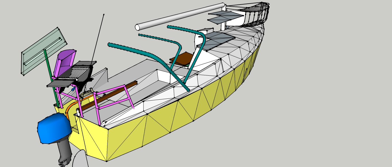

Patience! We have plans for a new layout, but these things take time. Stay tuned here for updates. Does anybody else out there use Sketchup or other 3D drawing program? eclipse salon.jpg

... Does anybody else out there use Sketchup or other 3D drawing program? ..
I use Sketchup and love it, but haven't used it in about a year so probably need to memorize a lot of the commands over :(...
I used it to design a trailer to carry the dirt bike on the tongue and the Polaris ATV behind a small camper section. Bought the steel, axle, tires and most everything to build it. Now just have to motivate myself :sosad:.

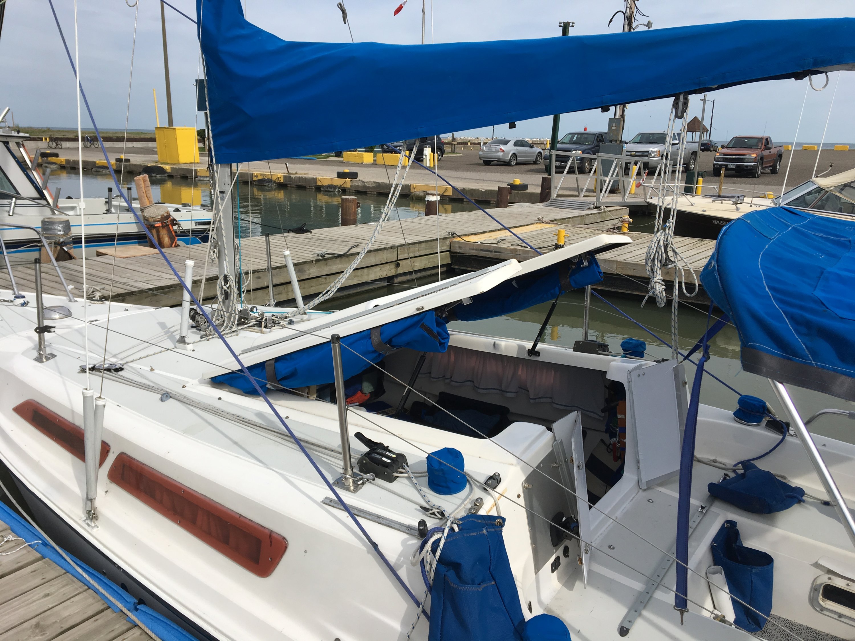

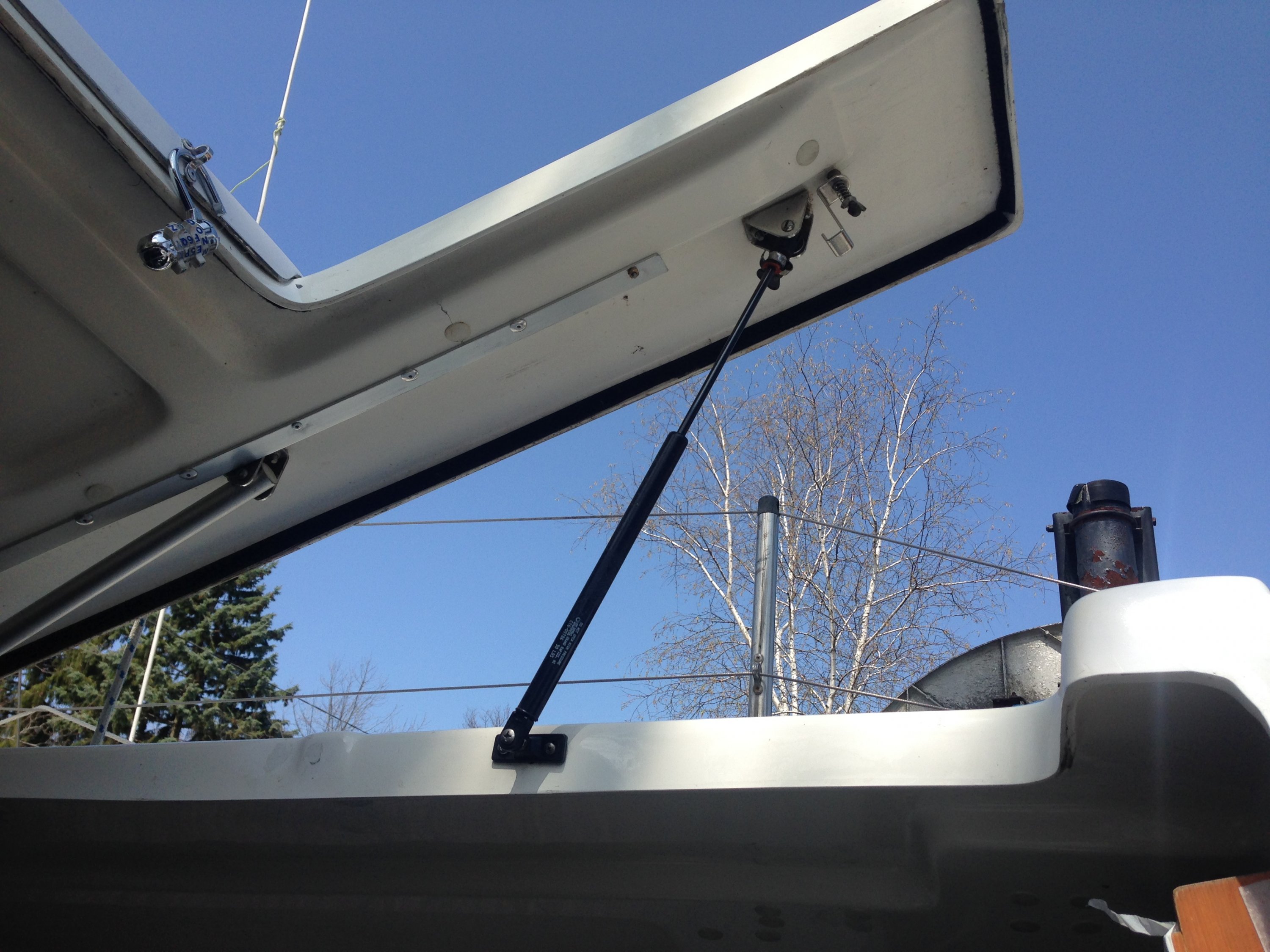

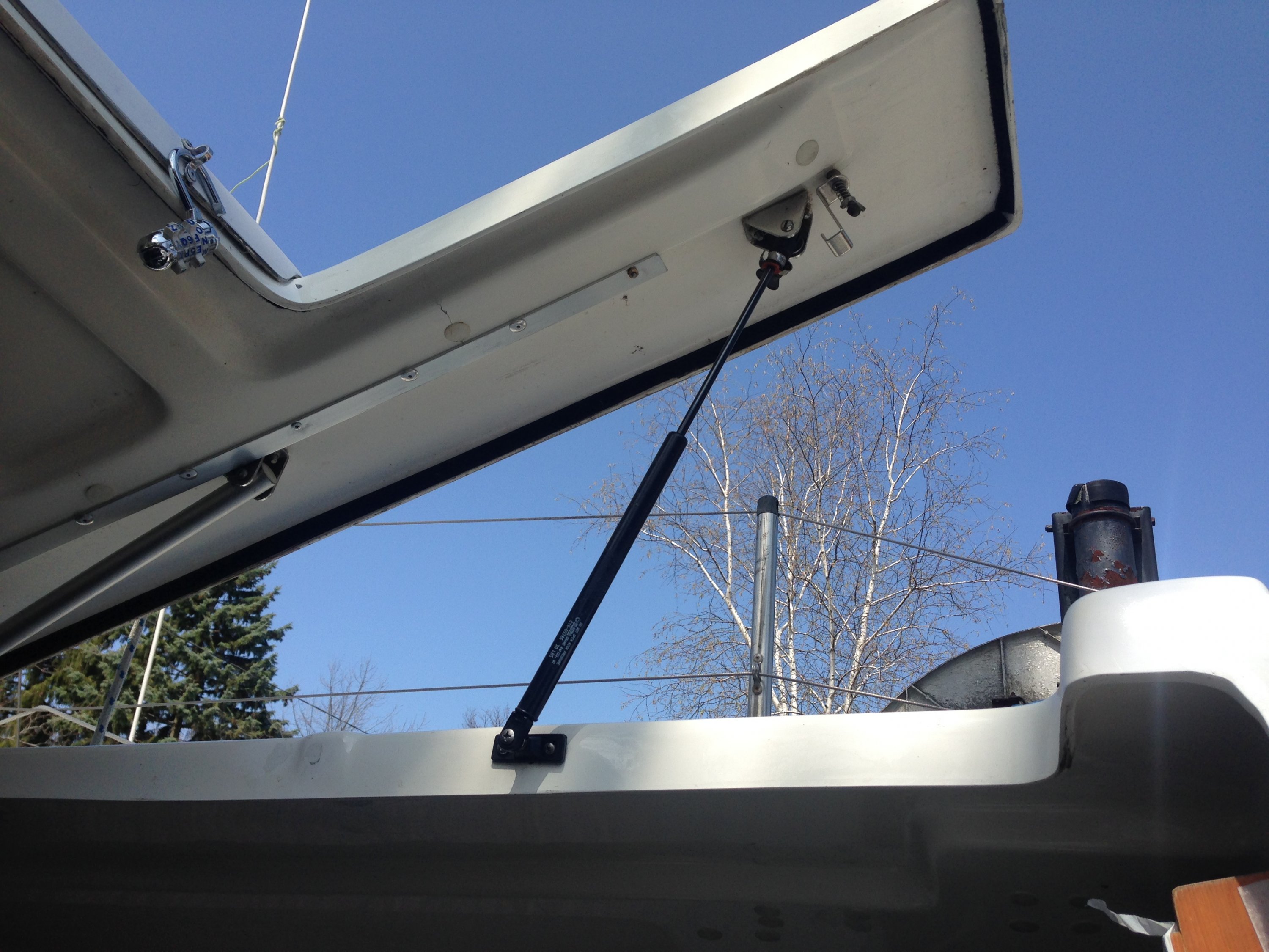

I've enjoyed this forum for years but never really contributed. I'm laid up with a sore back and want to start to share a bit. The one mod I've made that seems to be unique is the addition of two shocks to the pop top. The advantage to me is the ability to sail with improved headroom, good forward visibility and being able to use the vang. I've a few pic's that hopefully show the arraignment and operation.
Nov 30, 2015
217
Nice set up!
What length are the struts that you used?
Next question: What are the sunbrella rolls under the pop-top for, and what is the purpose of the PVC tube and sunbrella bag in the cockpit?
Inquiring minds are always searching for new idea's!

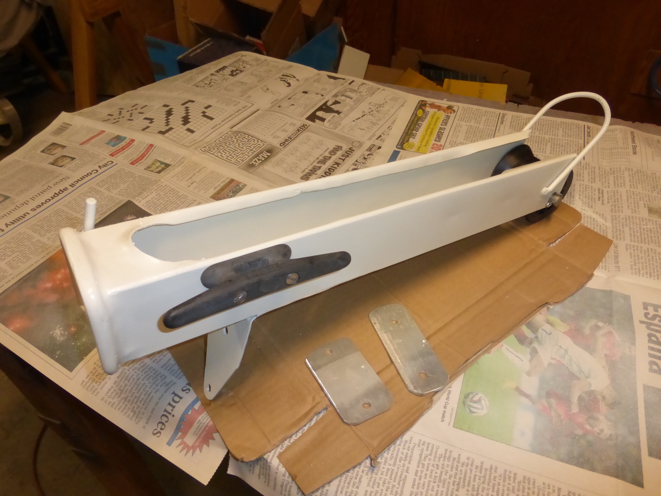

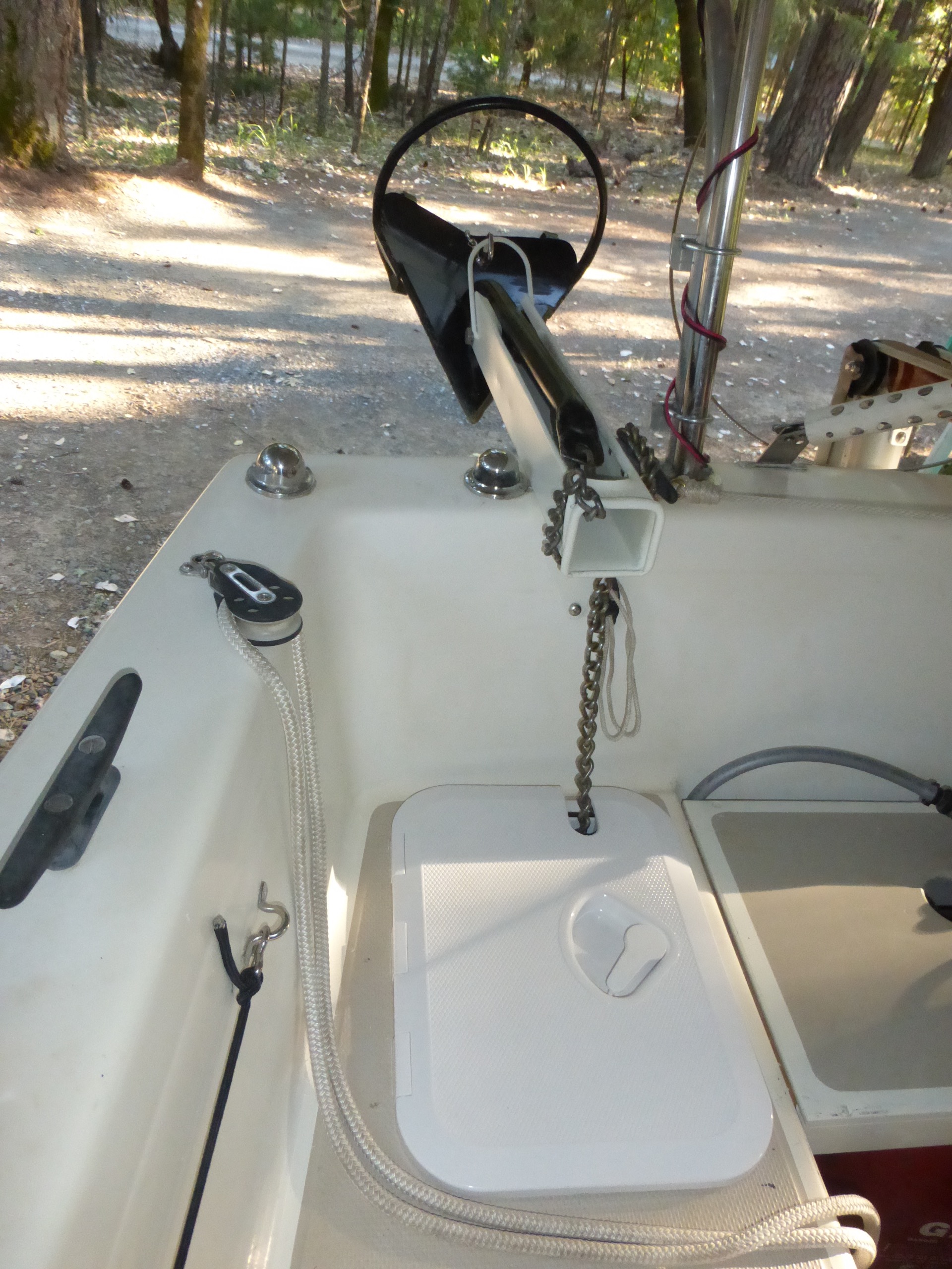

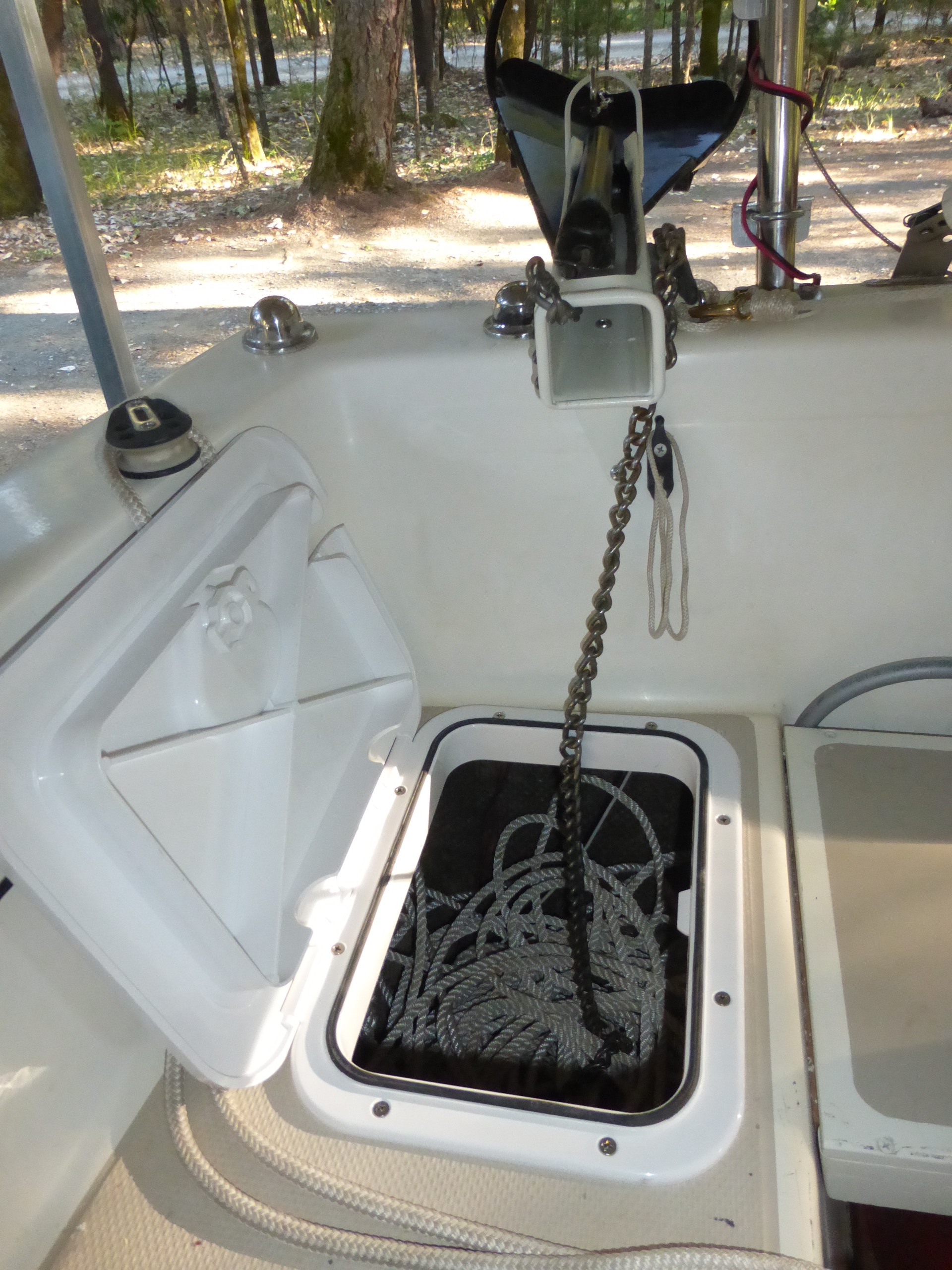

Over the 2+ years that we've been sailing the Mac 25 we've kind of developed our own way of doing things with it that works for us. some may say we're bass ackwards.... [shrug] but it works for us ;) . one of those things is when we get ready to overnight we like to drop anchor off the stern a couple hundred feet off shore and continue to pull, bow in, to a nice place to beach, tie up to a sturdy tree or stump etc, and then pull ourself back out with the anchor 50-75' off shore for the night. this way we can easily pull back to shore if we feel like stretching our legs etc. the catch to this is that a good anchor is needed at the stern, and just a rope at the bow. for two years I've had a d@^# plastic crate tied into the starboard rear corner of the cockpit bench to hold the 300' of anchor rope with anchor plopped on top of the pile. can you say PITA? it was always in the way and sometimes caught the tiller or tiller tamer rope, not to mention just taking up way too much real estate. SO....
my 3 day project was to fabricate a stern mounted anchor holder and rope locker. a couple photos are worth a thousand words:
The cleat is to tie off the anchor rope and the pin on the other side secures the anchor chain when the anchor is parked. I put a short "safety chain" on the rear of the anchor thinking I may want to trailer with it on there, but I still may not be able to not worry about putting it through someones windshield on the freeway, so I may not use that ;) . my dry land testing gave excellent results for launching and retrieving my custom "Russkna" anchor. the little kink in the nose even flips the anchor right-side up, as it comes over the roller, when retrieving. I couldn't be happier with it. :yeah:

Hi My Mistress ( hope my wife reads this in context)

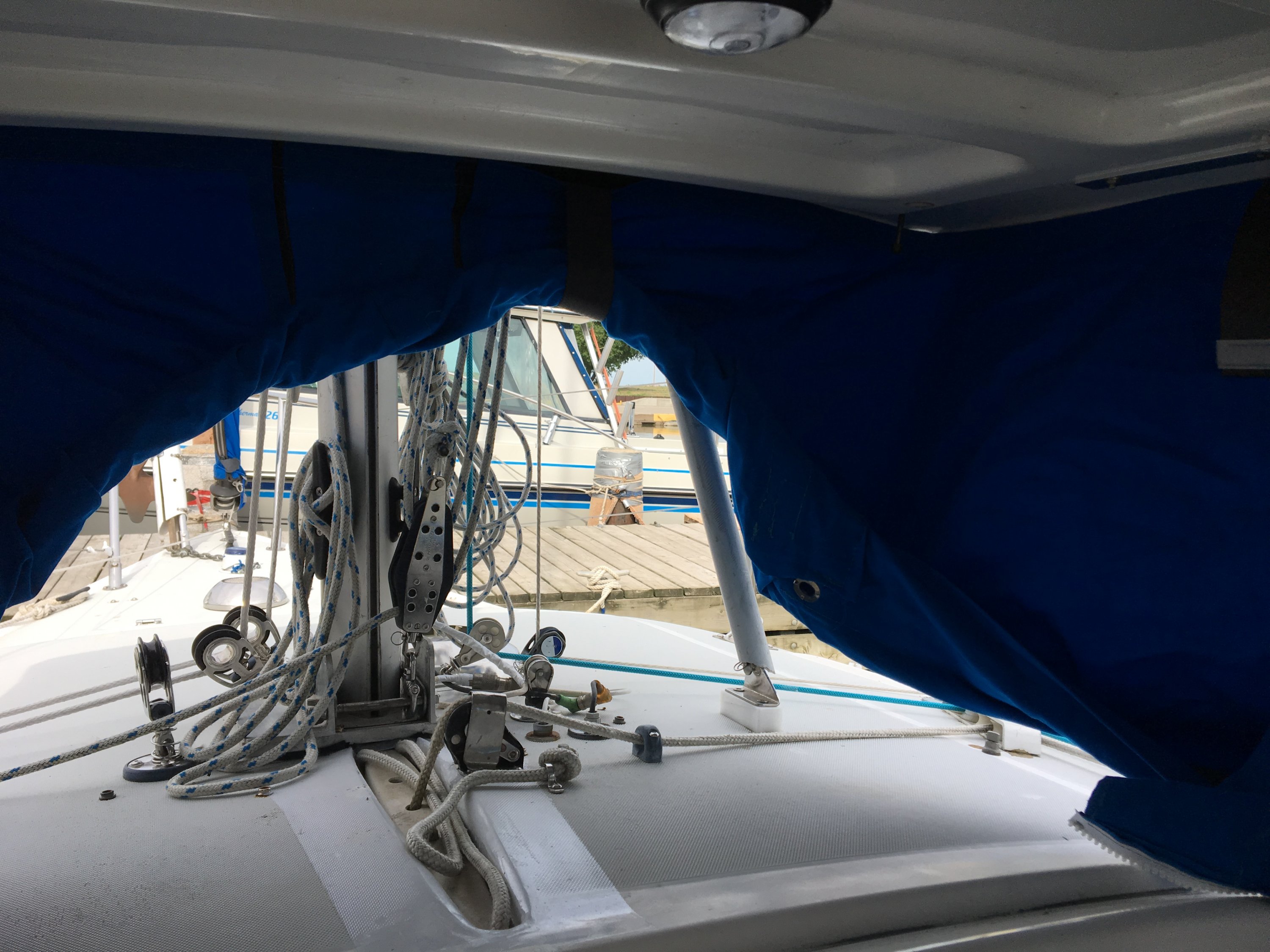

The sunbrella is a removable, self storing popup over. I'll post a few pics.
The PVC on the stays is just an inexpensive way to hold the calibers in place when trailering and I like how it looks when standing.
The bags are for storing lines, sail ties, winch covers and the like. Also used to tame the sheets when underway. They are held in place by turn buttons on the bulkhead so are easily removable.
Here is the popup cover with the full screen enclosure
Looking at the starboard side fully deployed
As it is being unrolled. Rolled up it is stored completely under the top. I've more pics if needed.
For specs on the gas struts, perhaps you can get info from a zoom in on the picture. Otherwise it might be a while till I'm back at the boat.
