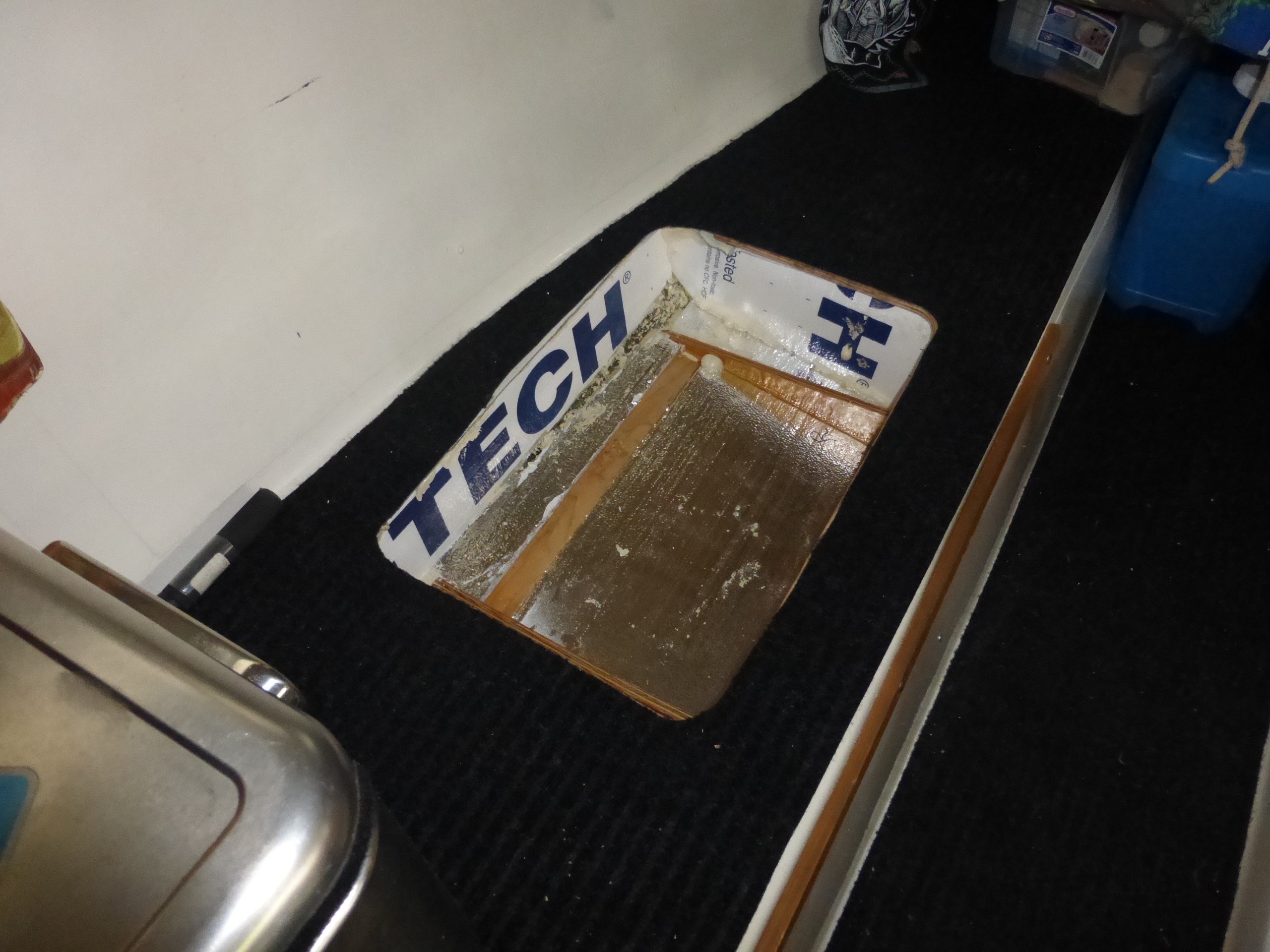

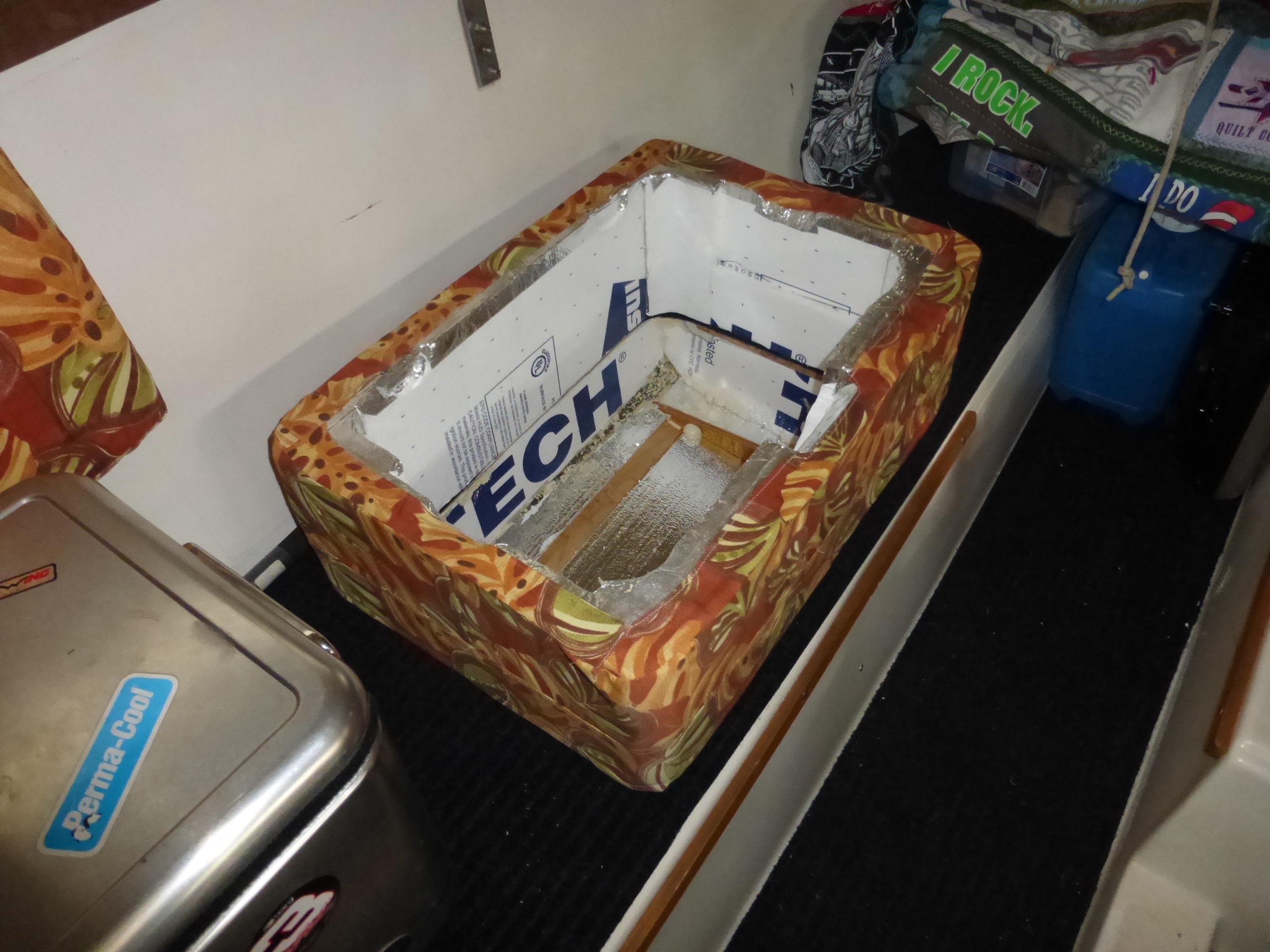

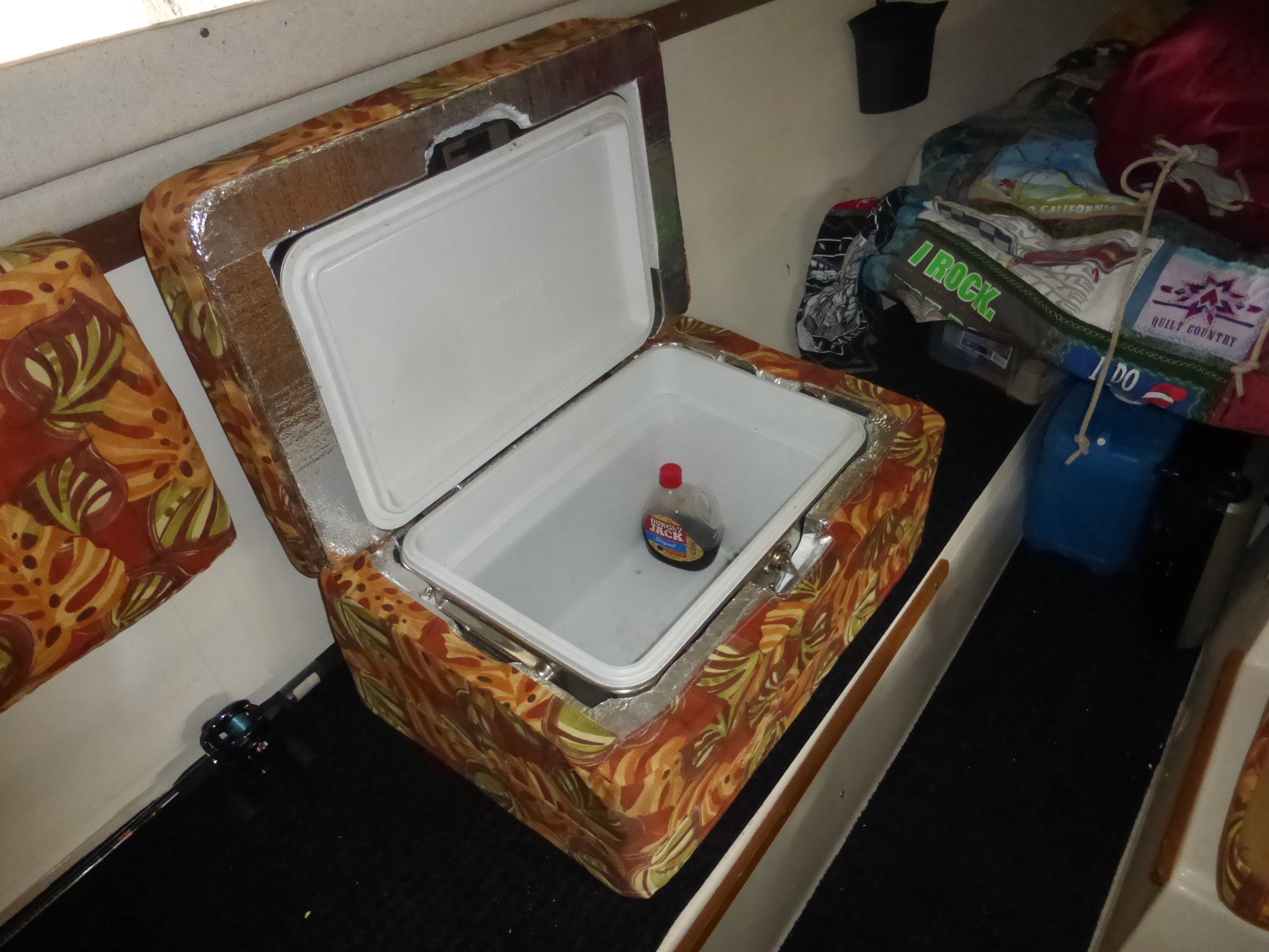

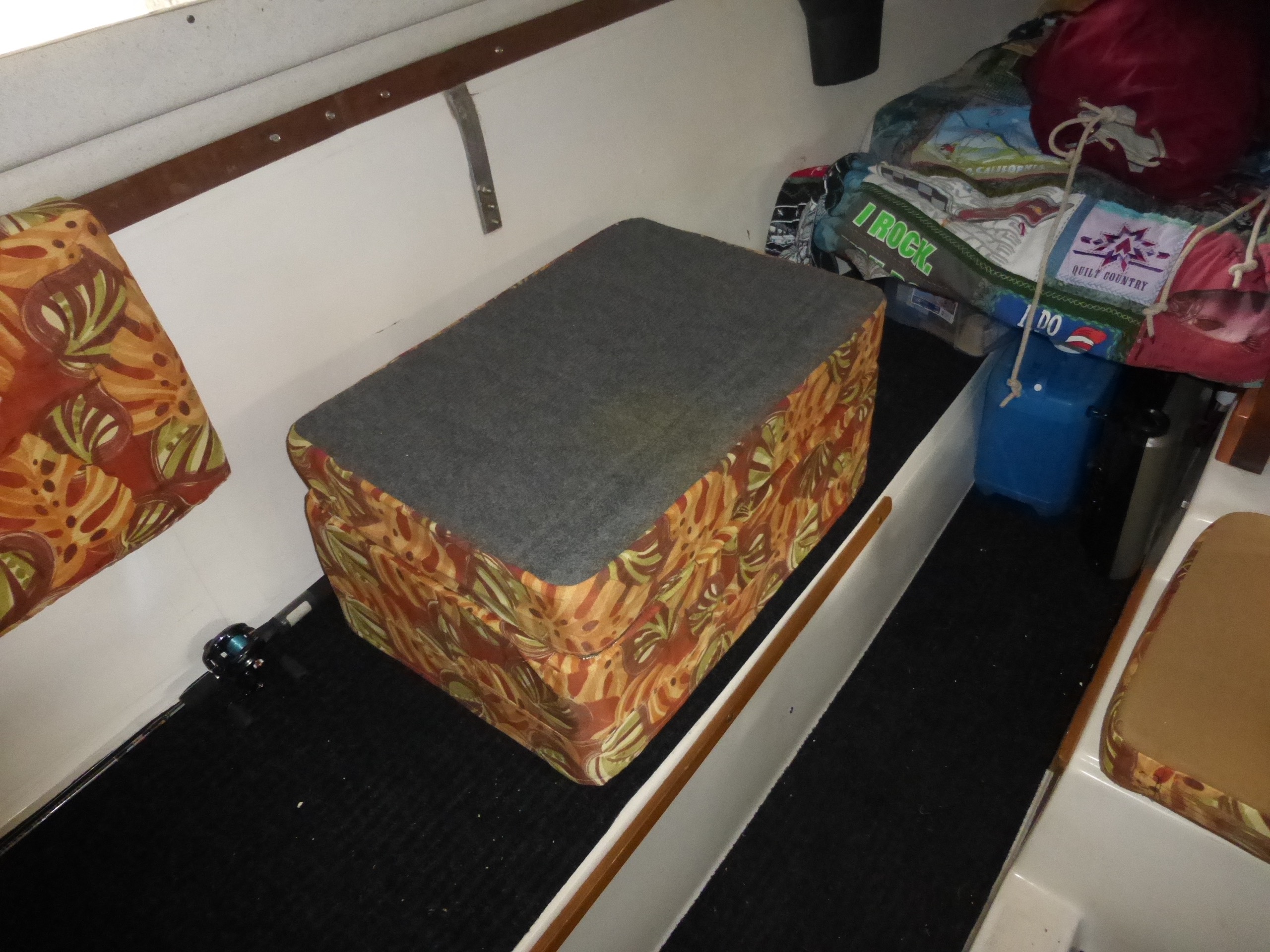

I deem my cooler project finished! I cut and fit pieces of the 2" Styrofoam to seal up the lower section beneath the bench. spray foam was used to fully seal all gaps and edges. then I sewed up a covering from the same material used for the boat cushions, and used a bit of super 77 spray glue to attach it to the sides of the portion of the box that's above the bench. for the cooler top I also cut a piece of the carpet runner material and sewed that onto a cloth edging. the foam top piece is attached to the hard cooler lid with several large pieces of velcro, so the lid lifts as one, as it should.
We stayed 3 days on the boat a week or so ago, before the lower portion was even finished, and the two 1/2 gal jugs of ice still had over 1/2 their ice when we got home, so I guess it works ;) .

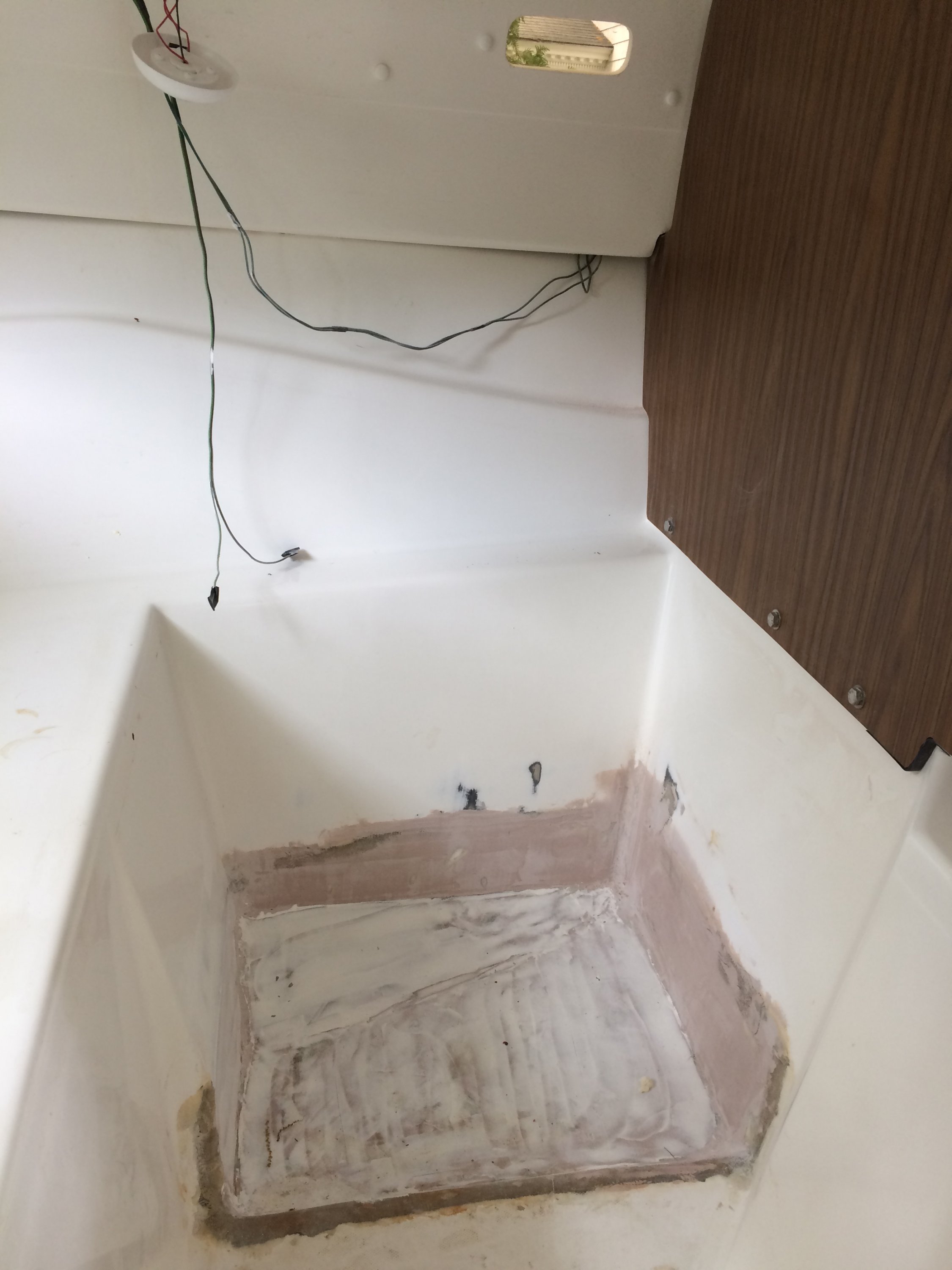

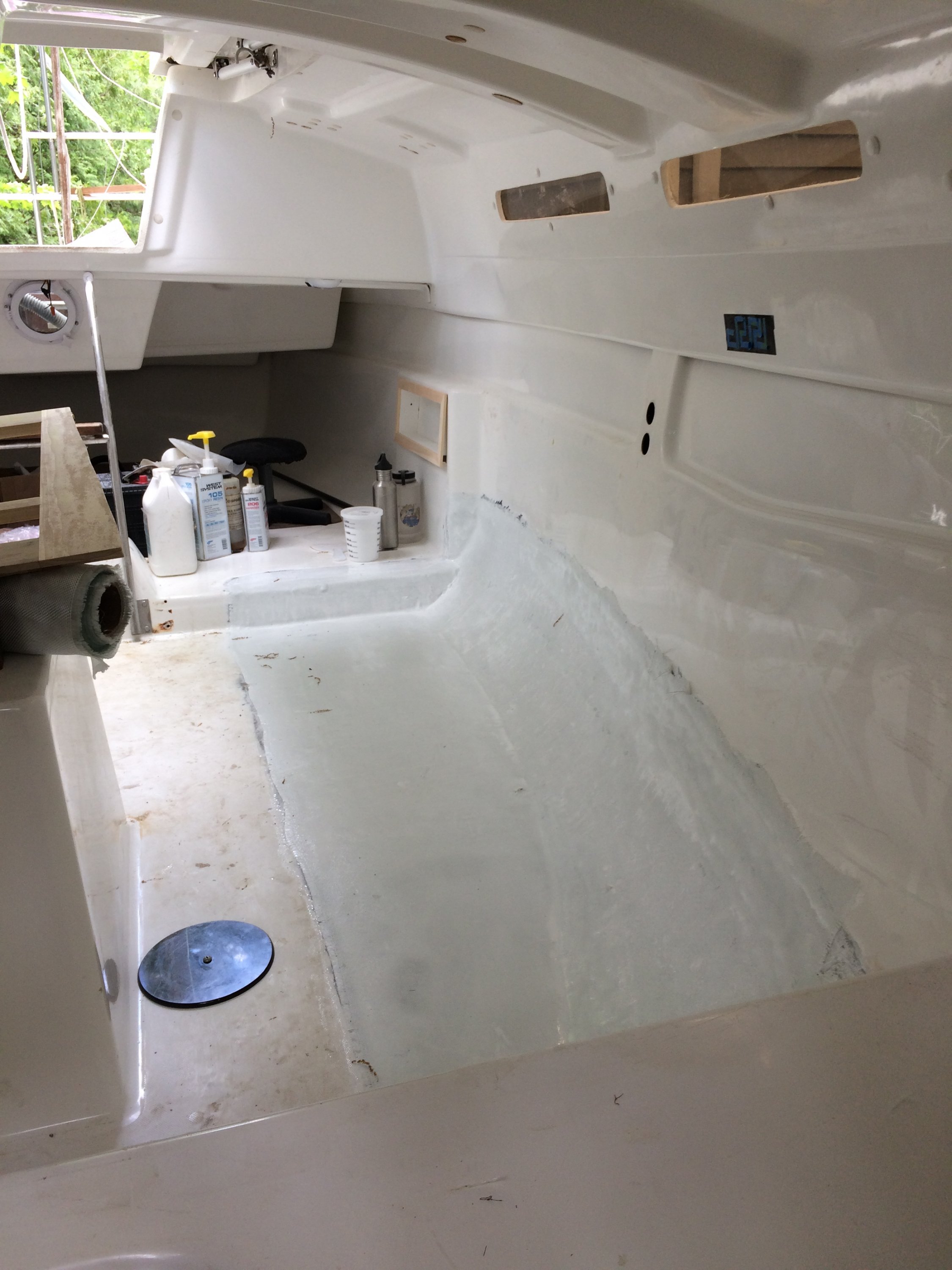

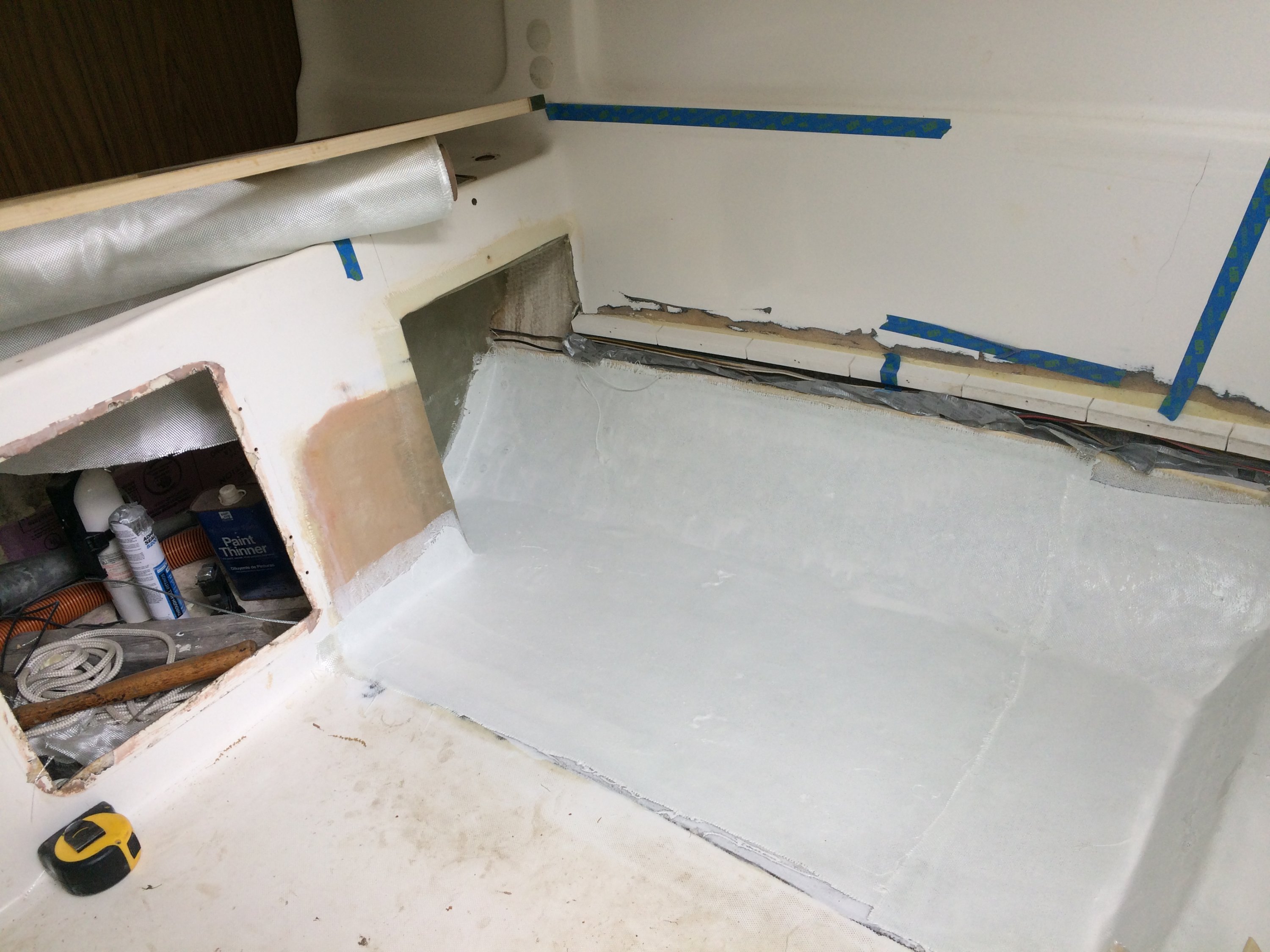

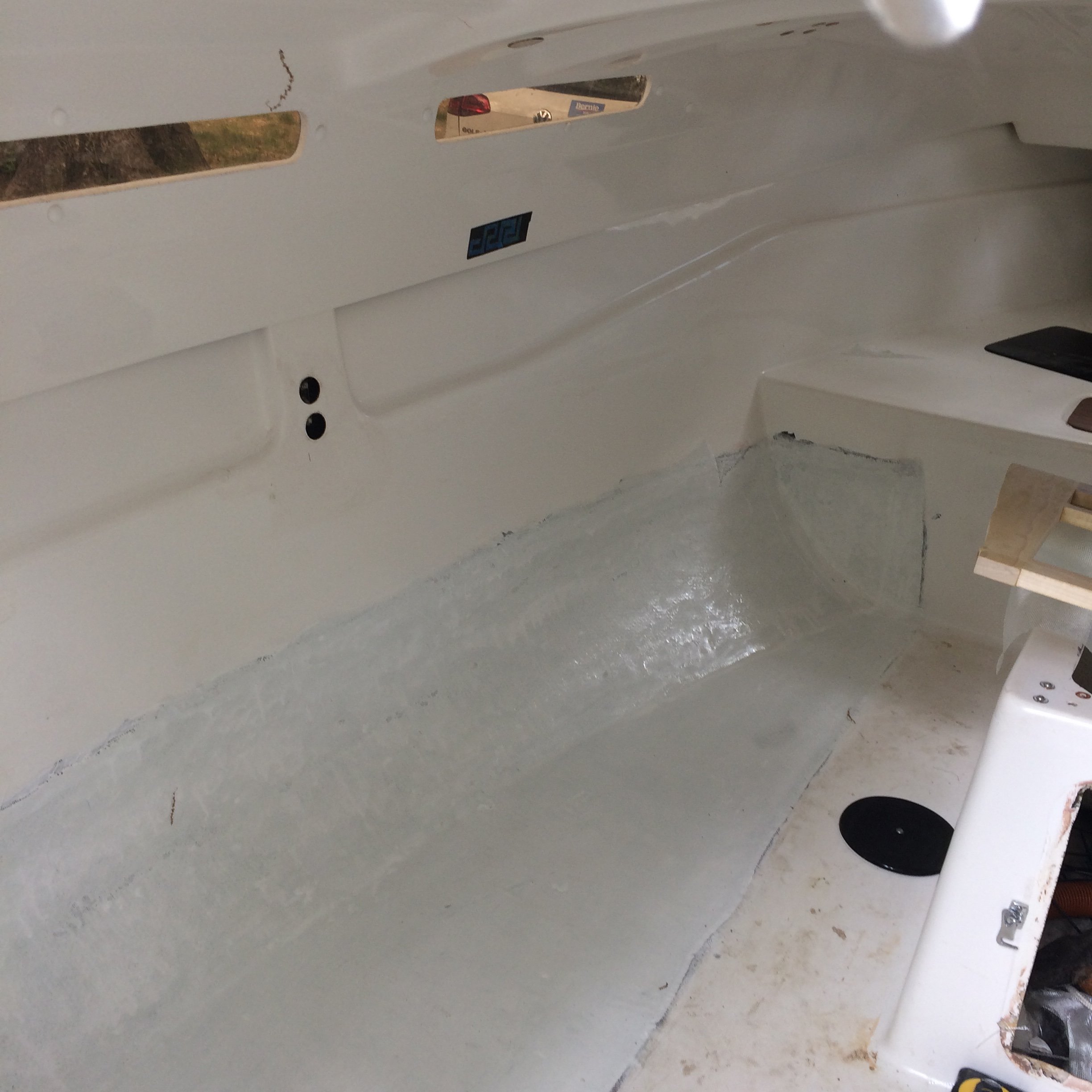

We completely cut out both starboard and port settee benches plus the shelf for the head, and I have been fiberglassing over the new floor areas. West system epoxy and US Composites 7oz glass. I laid in 1/2" styrofoam to provide a smooth and level substrate for the glass.
Eventually there'll be a revamped galley plus dinette style seating on the port side. There'll also be a composting head.

Here's some photos. It's all white, so I hope you can see what we've done. It's amazing to have just a wide flat floor. But it won't stay that way. IMG_2459.JPGIMG_2460.JPG

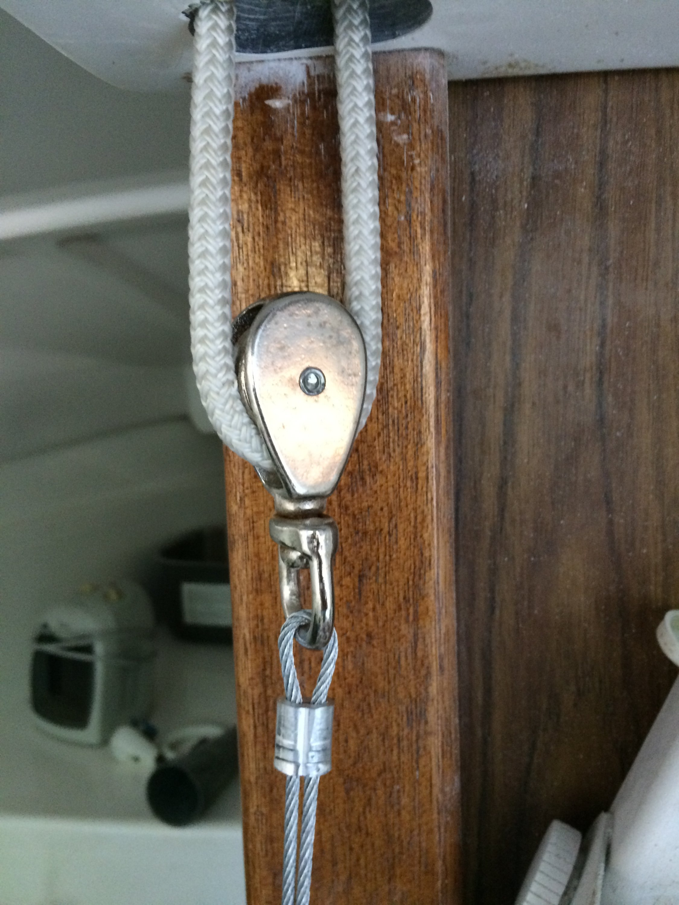

With the new salon and galley layout, I had to move the centerboard cleat. I like what others have done (oft showcased in this forum) with leading the line aft and to the cockpit. The cable ends with a block giving the line a 2:1 advantage.

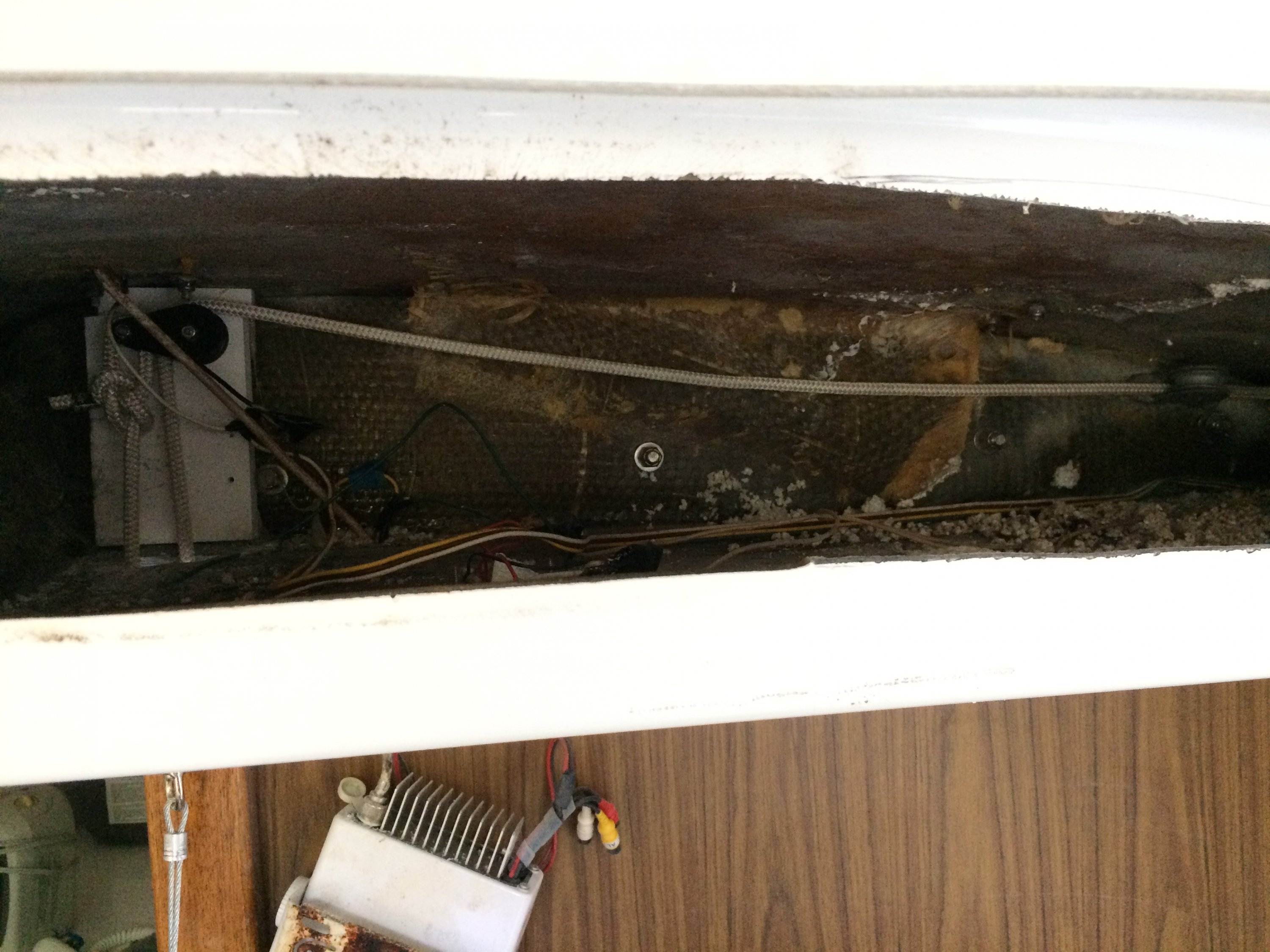

I don't think I'd dare run a pulley through that area above the galley on "Mistress" now. I brought every piece of wiring; every system, (fuse panel, AM/FM radio and S2S radio, voltmeter, additional switches, antenna leads) through there.
I like the idea though.
