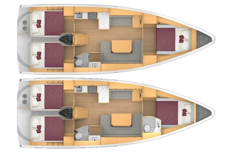

So the pizza slice shape is fast, that's great. Plus the designers put in hard chines (deep dish pizza slice). Why? More berth space primarily.
To me, it's an amazing 'interior' in that 3 double bedrooms - two are 'ensuite' - are fit inside a 42'er!
For running the Atlantic, it better be fast because it doesn't look like it has much storage. I see one good seaberth on each tack. No sea-going ventilation (AC maybe?)
I think for a charter boat it's a great idea. For how we sail, I guess my wife and I could AirB&B two cabins and make some $$$. :) Crossin the Atlantic, not a good design me thinks.
I didn't see any comments on tankage. Very small for a boat her size. No mention of a holding tank. Also, 6 people and 1 head doesn't sound like a recipe for a successful cruise.

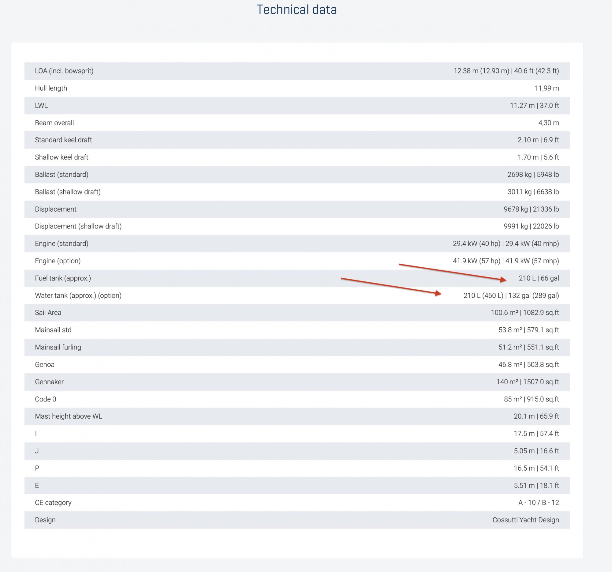

There is a 2 head model.
Water tankage is 132 gallons standard, 289 gallons optional.
Fuel tankage is 66 gallons.
No mention of waste.

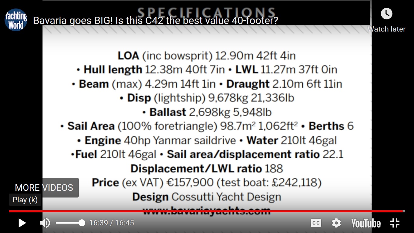

This was in the video from OP.

13,318
Thank you. I saw that also. So where did the data originate in the video?
Well the numbers are all screwed up.
210 Liters is about 55 gallons, 460 L ~ 121 G. However, tank options are 210 L or 460 L. Or 132 G or 289 G. None of those are equivalent. Even the number you cited, 210 L or 46 G are wrong.
I hope the engineers at Bavaria are better at math and conversions than the marketing people. :huh:
