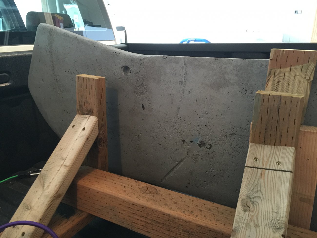

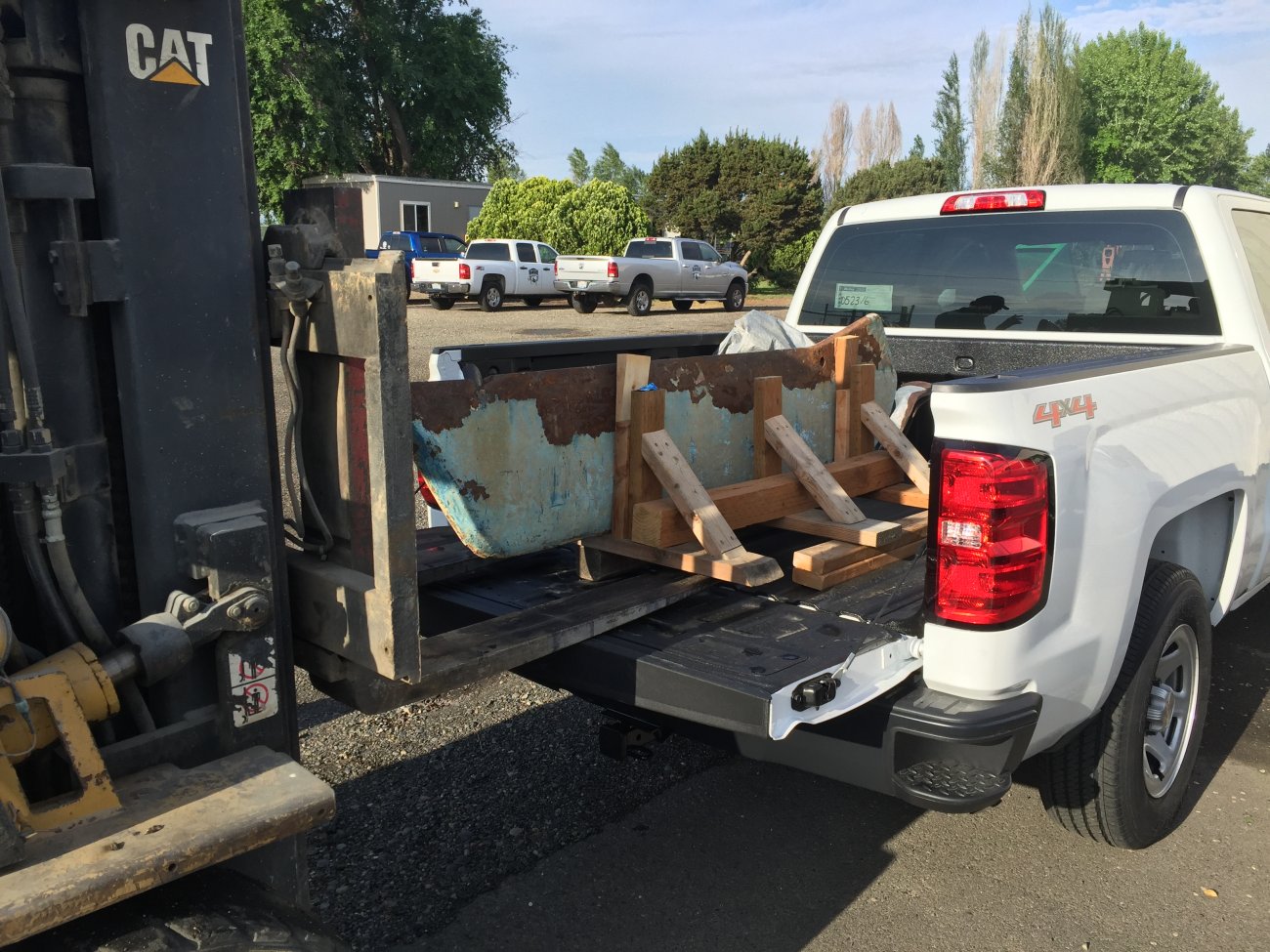

1) Pull it (and then promptly spend countless hours figuring out how to get it in the truck for sandblasting

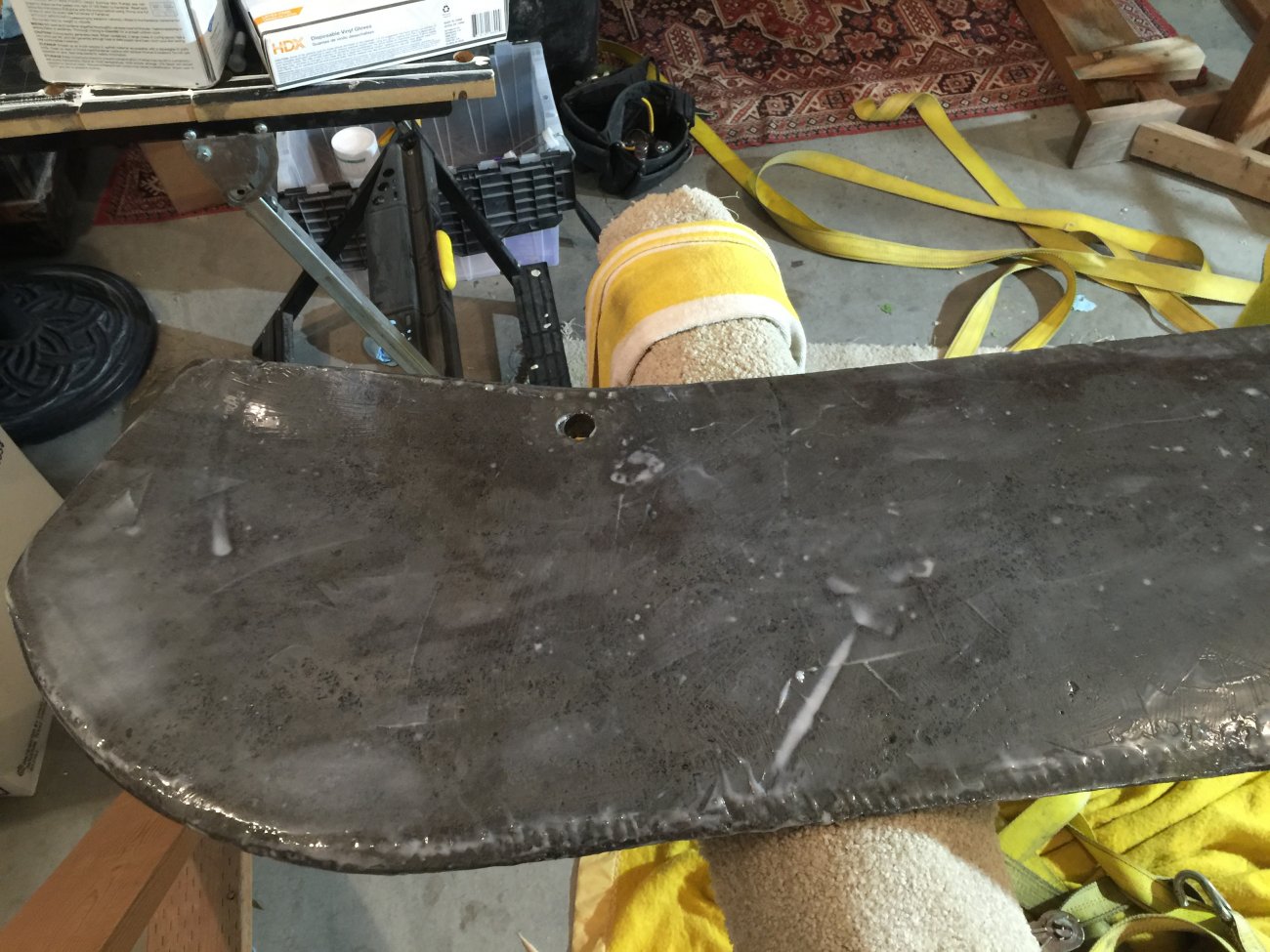

2) Sandblast -- expose that wonderfully flawed chunk o' Iron and get her clean

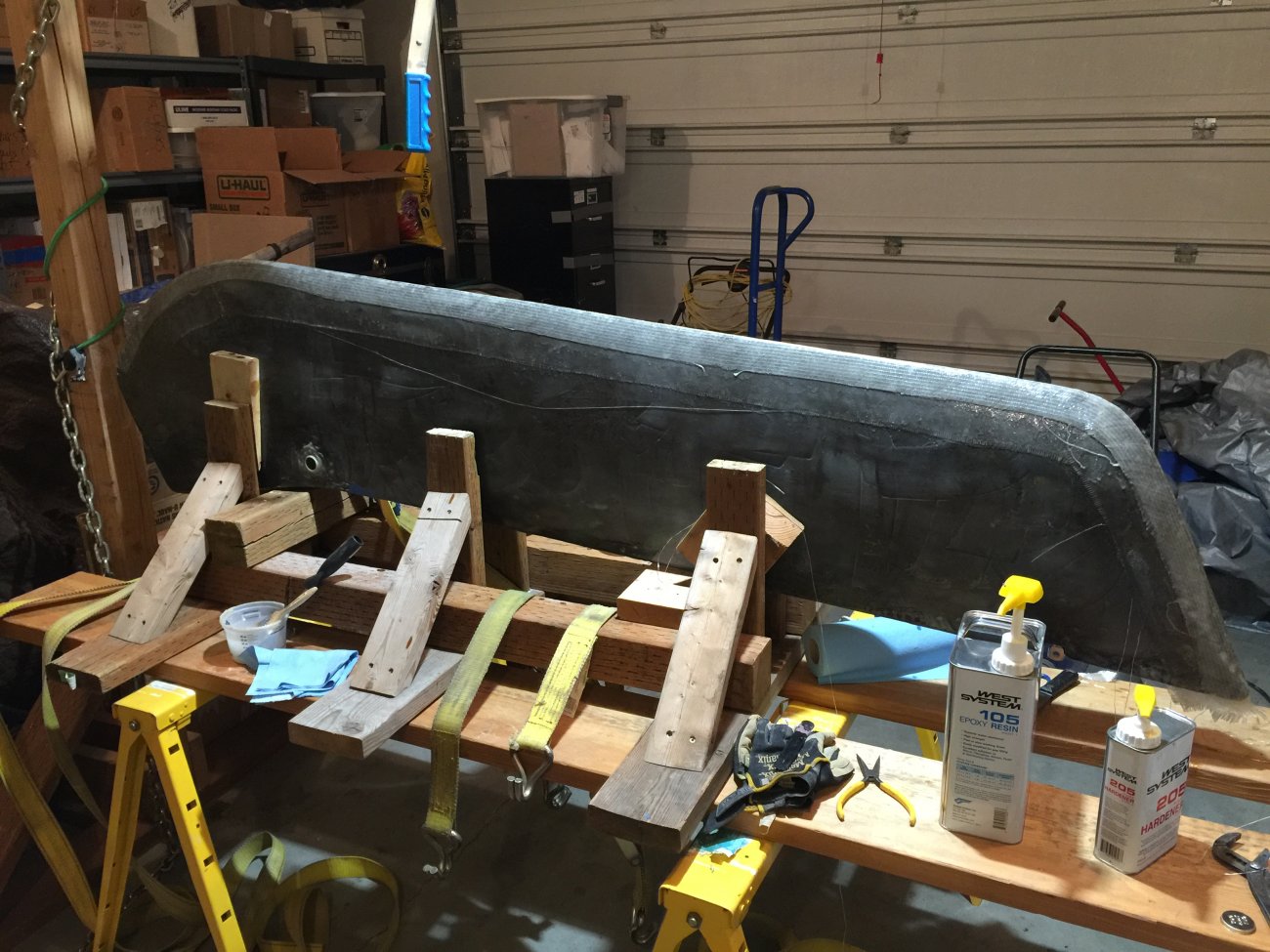

3) Slather with unthickened West Systems Epoxy (two coats) Finally its free from rusting in the open atmosphere, but far from bulletproof.

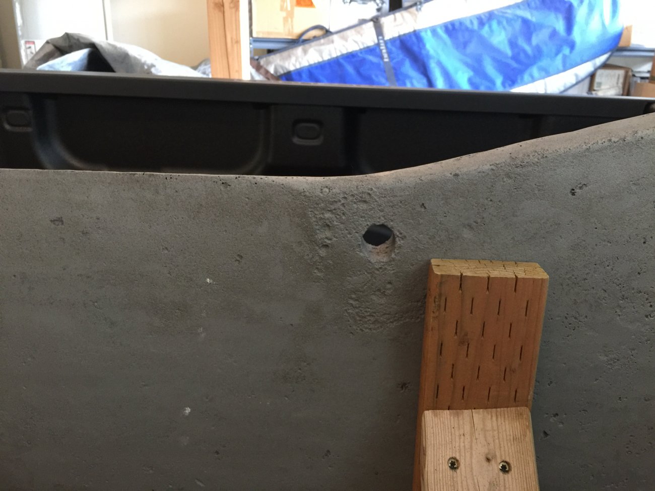

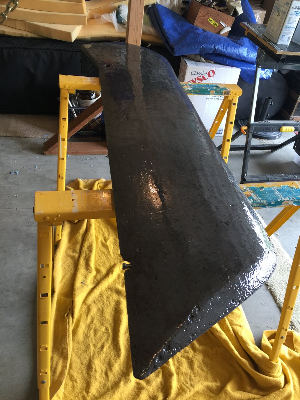

4) Waterproof but still lumpy as all get out-- now it's smeared with West Epoxy thickened with Colloidal Silica (strong like bull)-- not fair, but starting to find a shape.

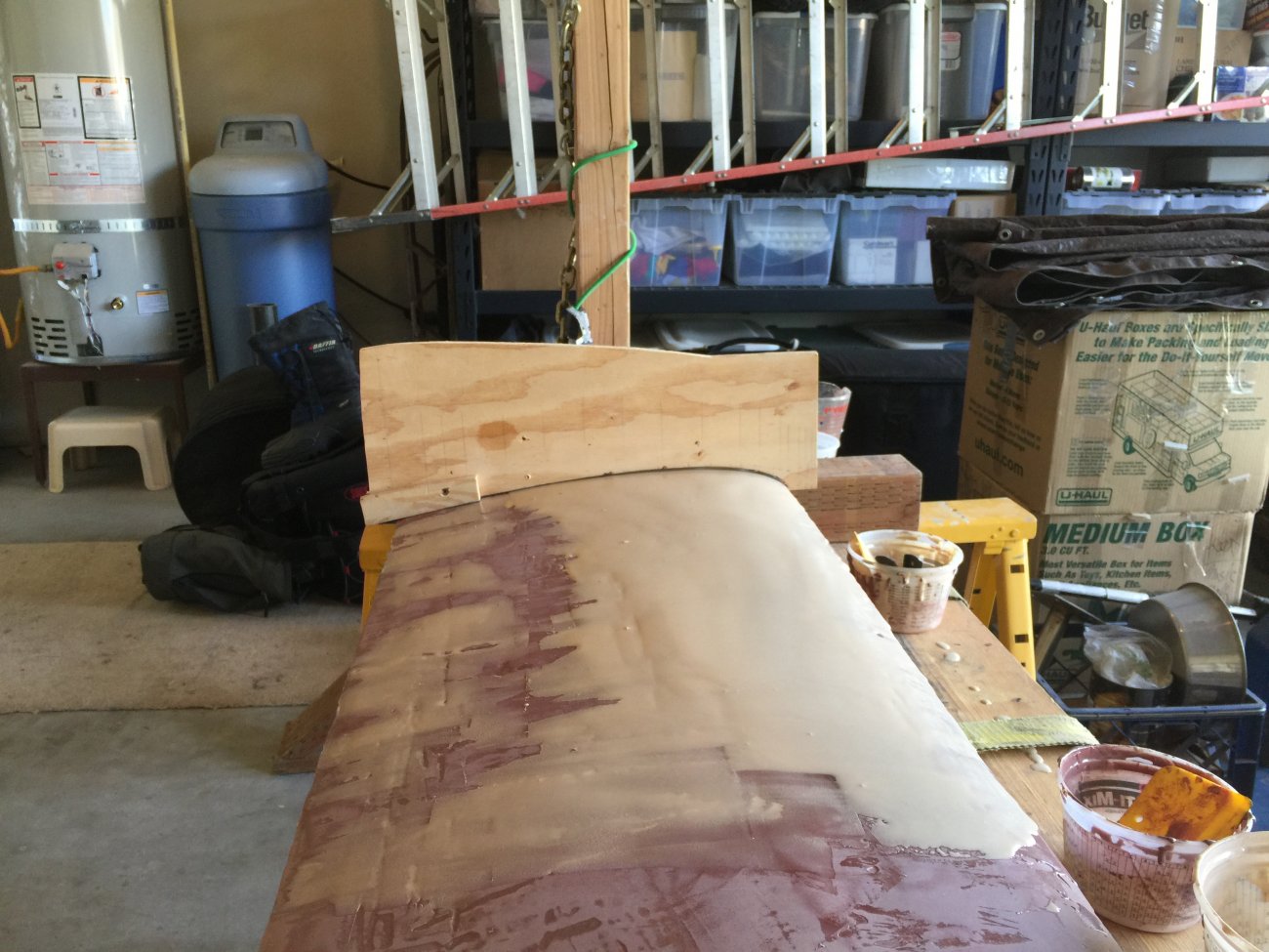

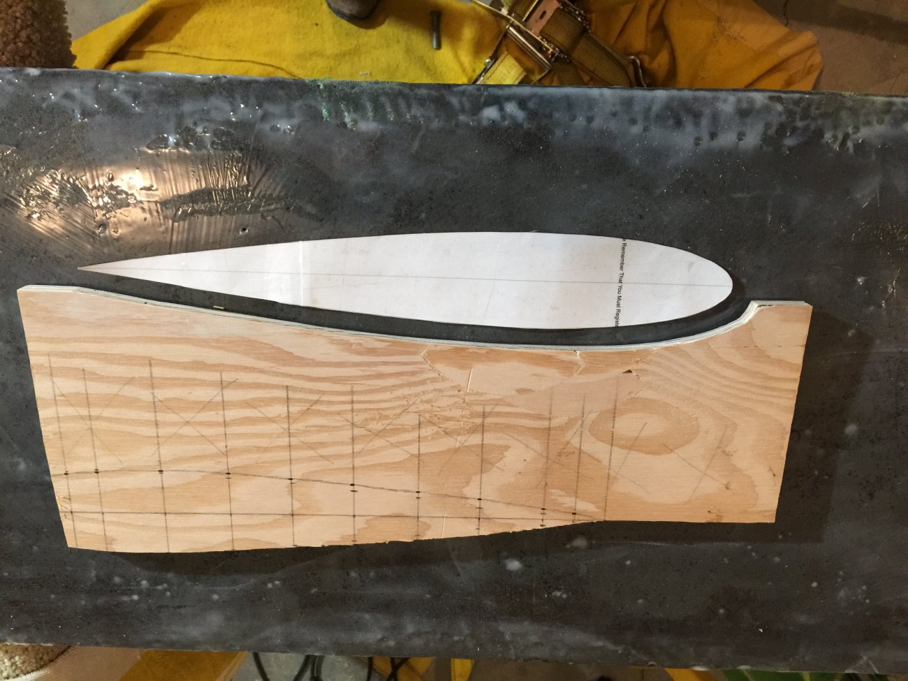

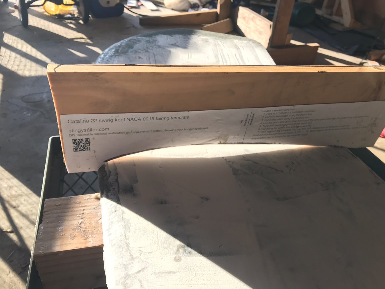

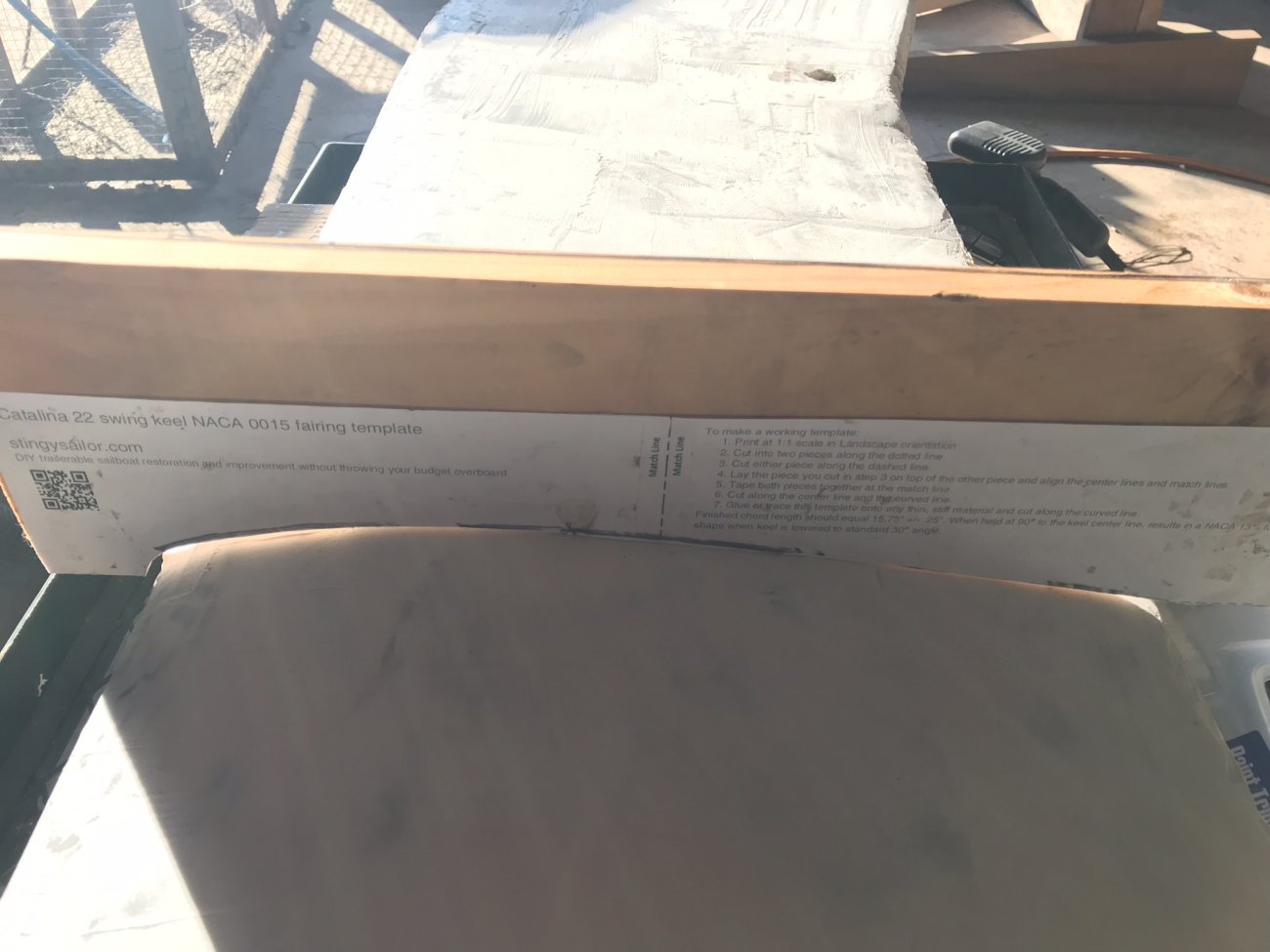

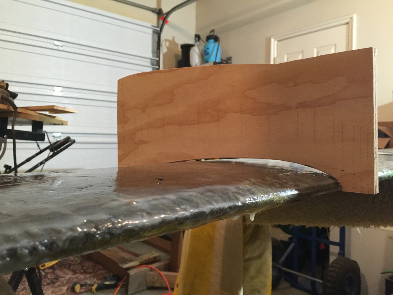

5) Wings need a shape-- found a foil template, build the jig

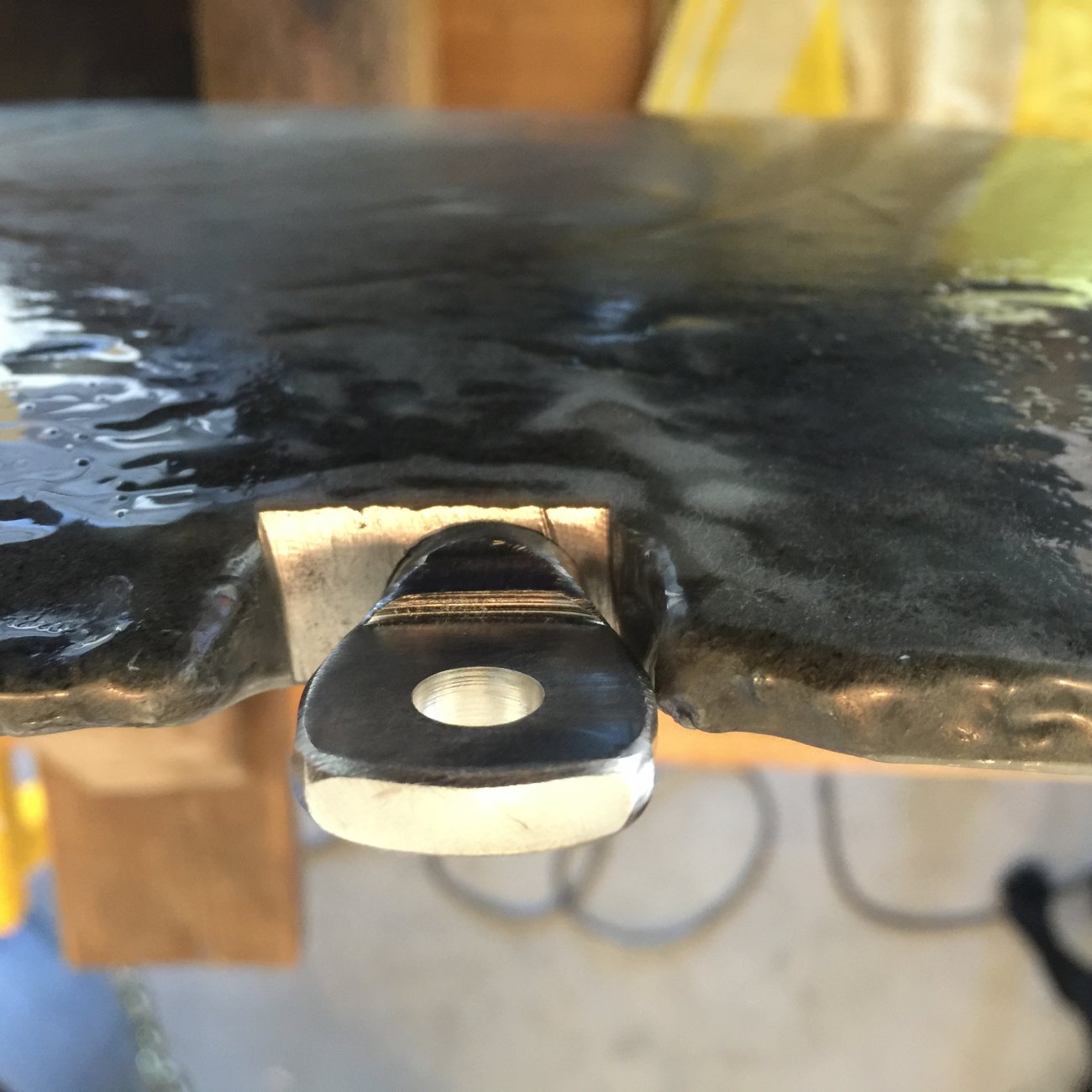

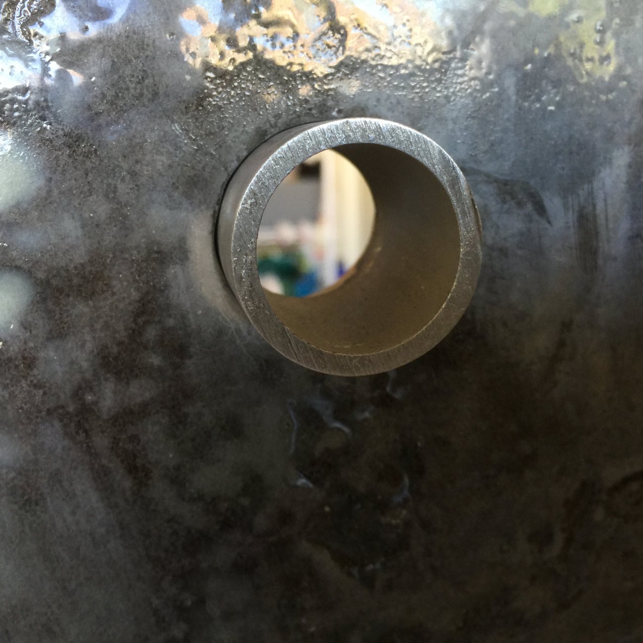

6) Clean up the important holes-- off to the machine shop to drill for the bushing, clean up the keel eye bolt
The stage is set, mechanical addressed and ready to start what I thought would be the easy part. Standby for part 2 (you can only load so many photos at a shot :) ).

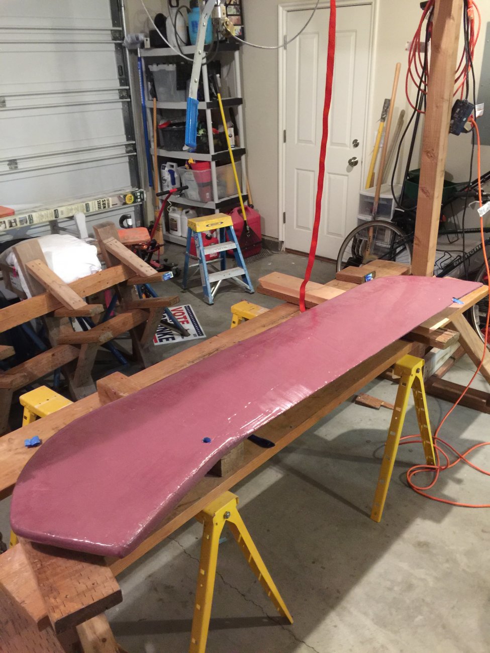

Step 7) Put armor on the battle ship! best thing I decided to do -- completely en-roved the leading edge with a wide strip of light cloth and then gave the top a big slab of biaxial
8) Start blending that fiberglass leading edge into a continuous shape-- bring on the 407
9) Burn 407 like there's no tomorrow-- finally a surface that we can apply the jig and foil template to-- we build up from here
10) We've added some depth -- but a long way to go before we have a semblance of the foil outline-- note the heavy spots as the layers are building vertical depth

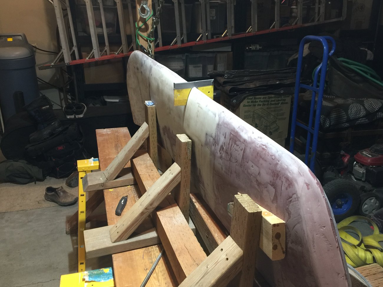

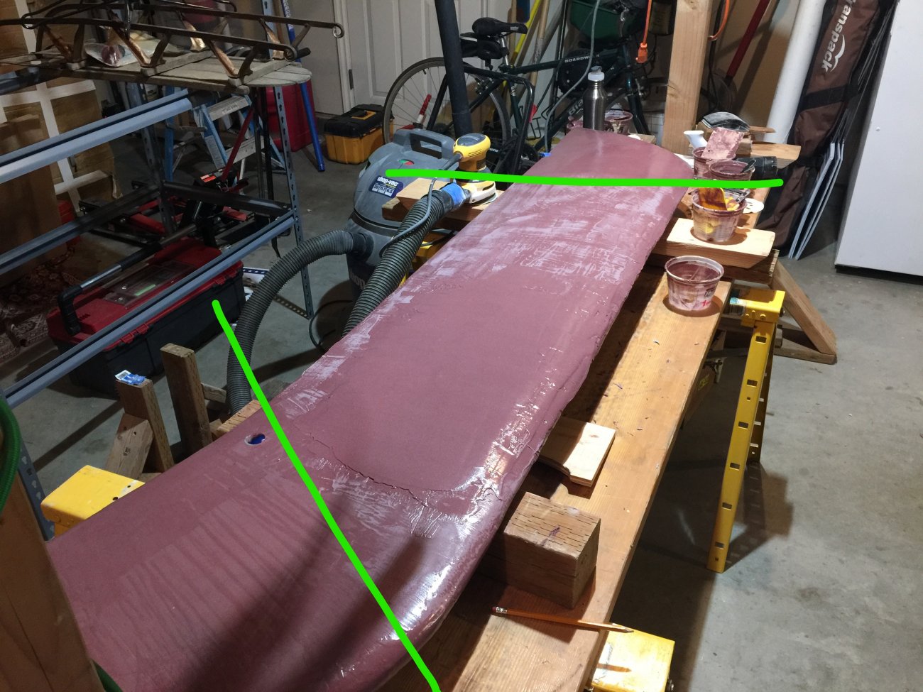

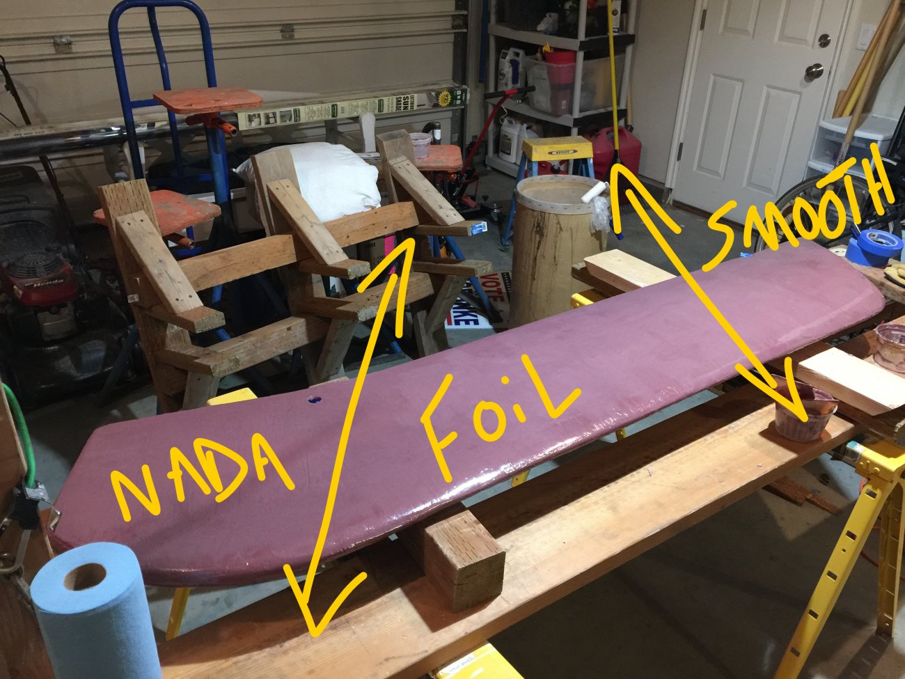

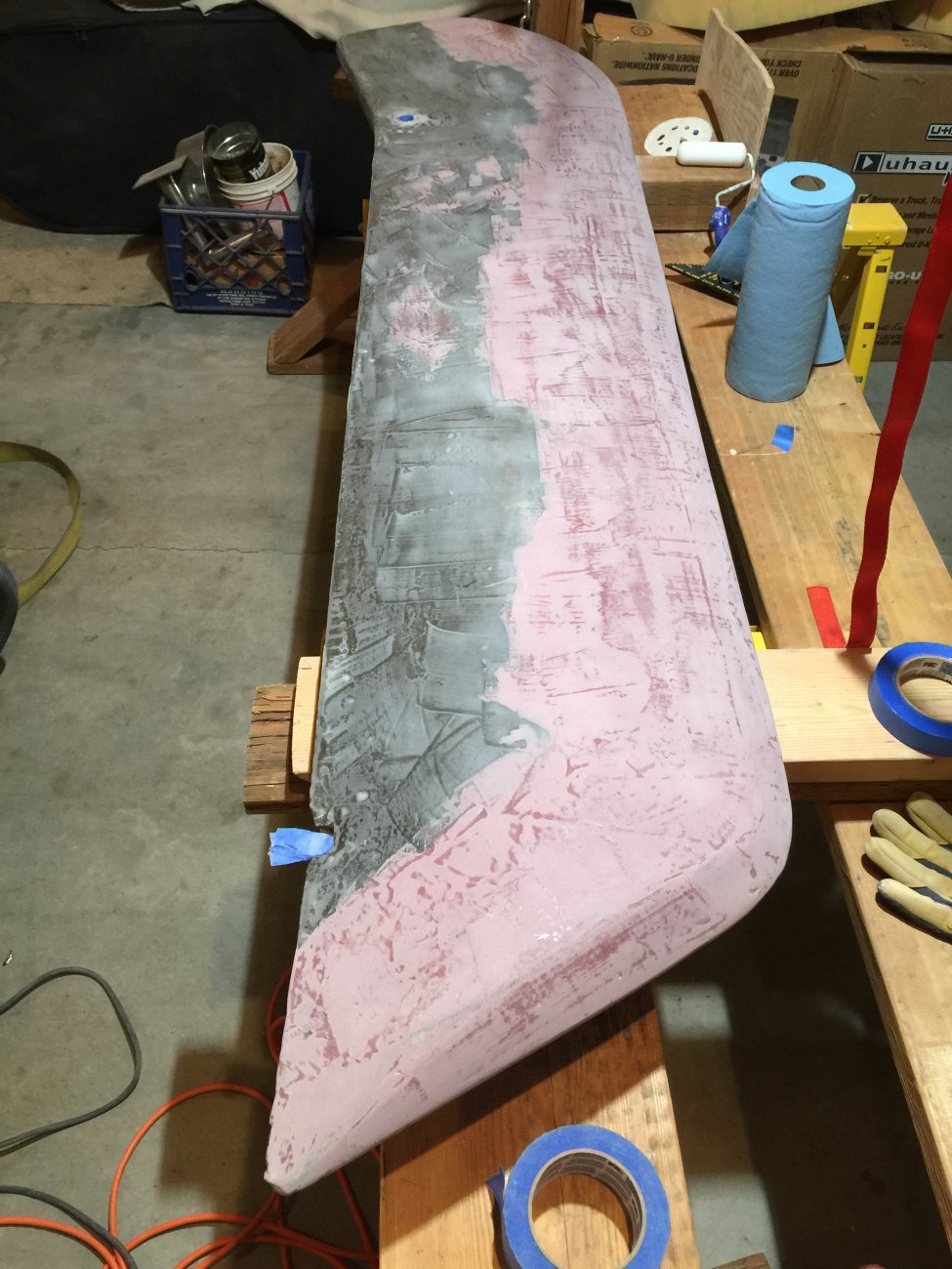

12) Countless hours and layers later we almost have the foil, but note there's a long way yet to go to a "fair" surface. Still lumpy as all get out but now we have the rough outline and starting to resemble an airplane wing

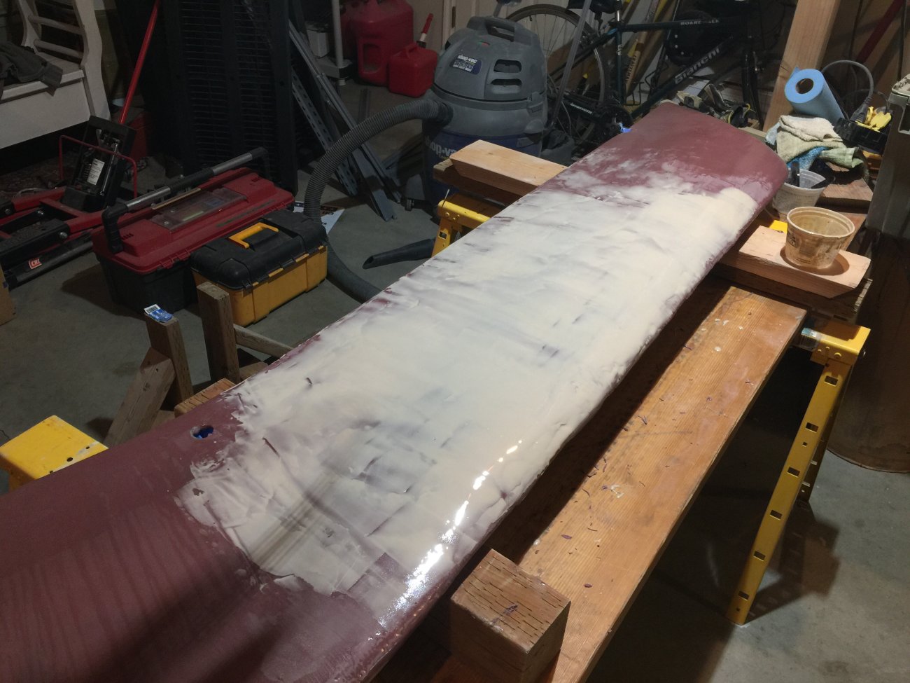

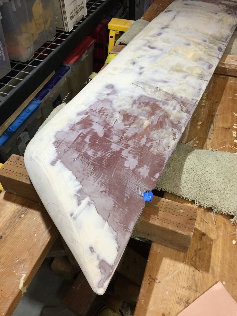

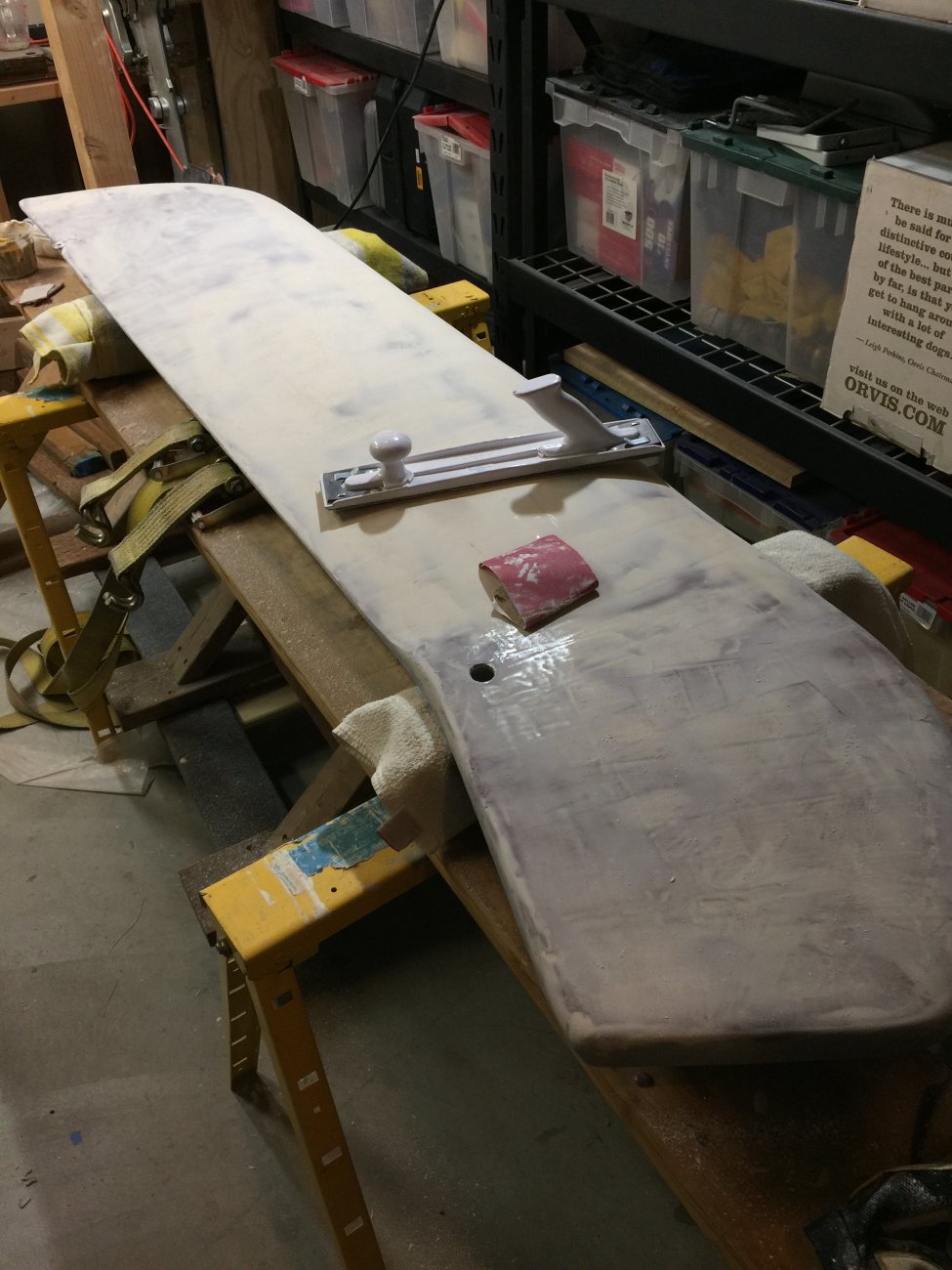

13) Fairing begins in earnest-- High spots, low spots and lots of pencil marks to guide the next layer of 410. clearly visible here are the shiny spots the longboard sander isn't touching (low) and the buffed sanded 410 is starting to blend

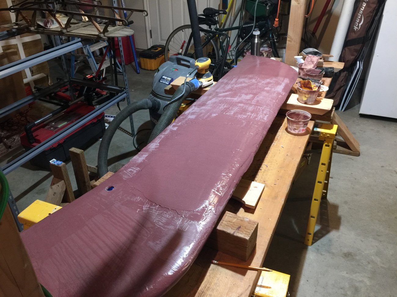

14) The longboard is doing it's job-- we're almost to the land of OCD, how picky do we want to be?

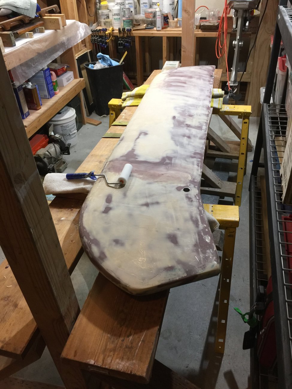

15) more longboard followed by spot hand sanding-- I'm ready to coat the entirety again in a layer of unthickened epoxy for the next stage , but here we take a modest break

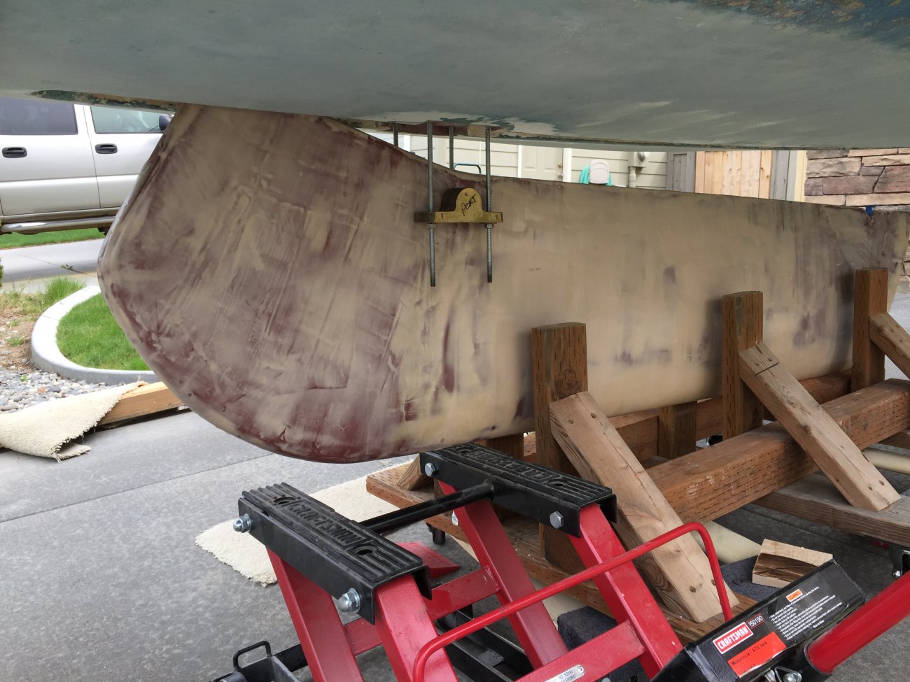

16) Check for fit! I've added a ton of material and have been conscientious of keeping the trailing edge and head of the keel unencumbered so she'll still fit-- confirmed! and I'd rather wrestle her here than once I have everything pretty

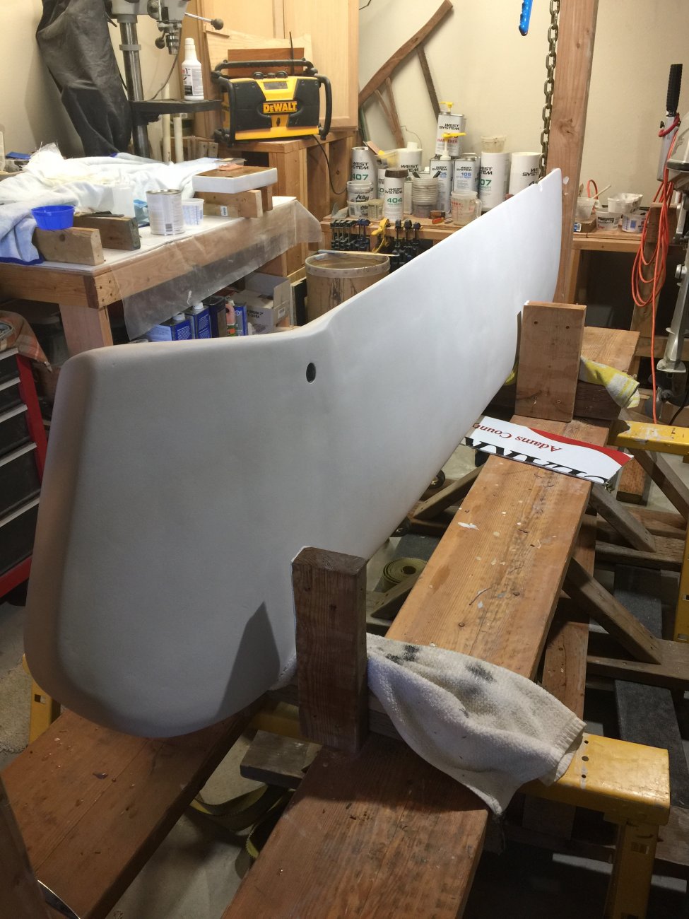

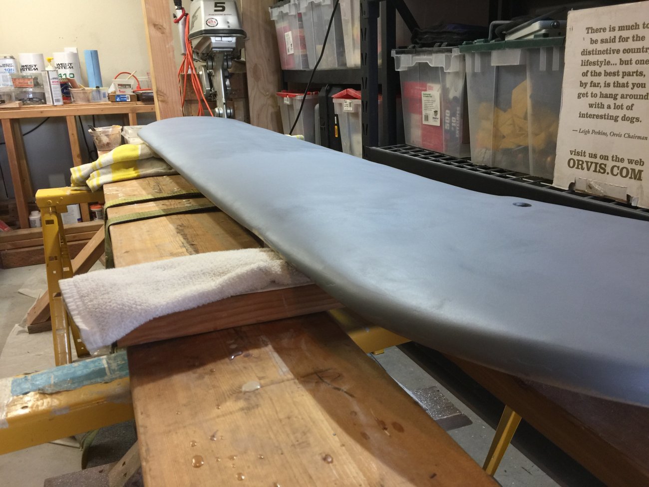

17) Primer Coat #1 -- used Interlux interprotect 2000E , expensive but designed for purpose.

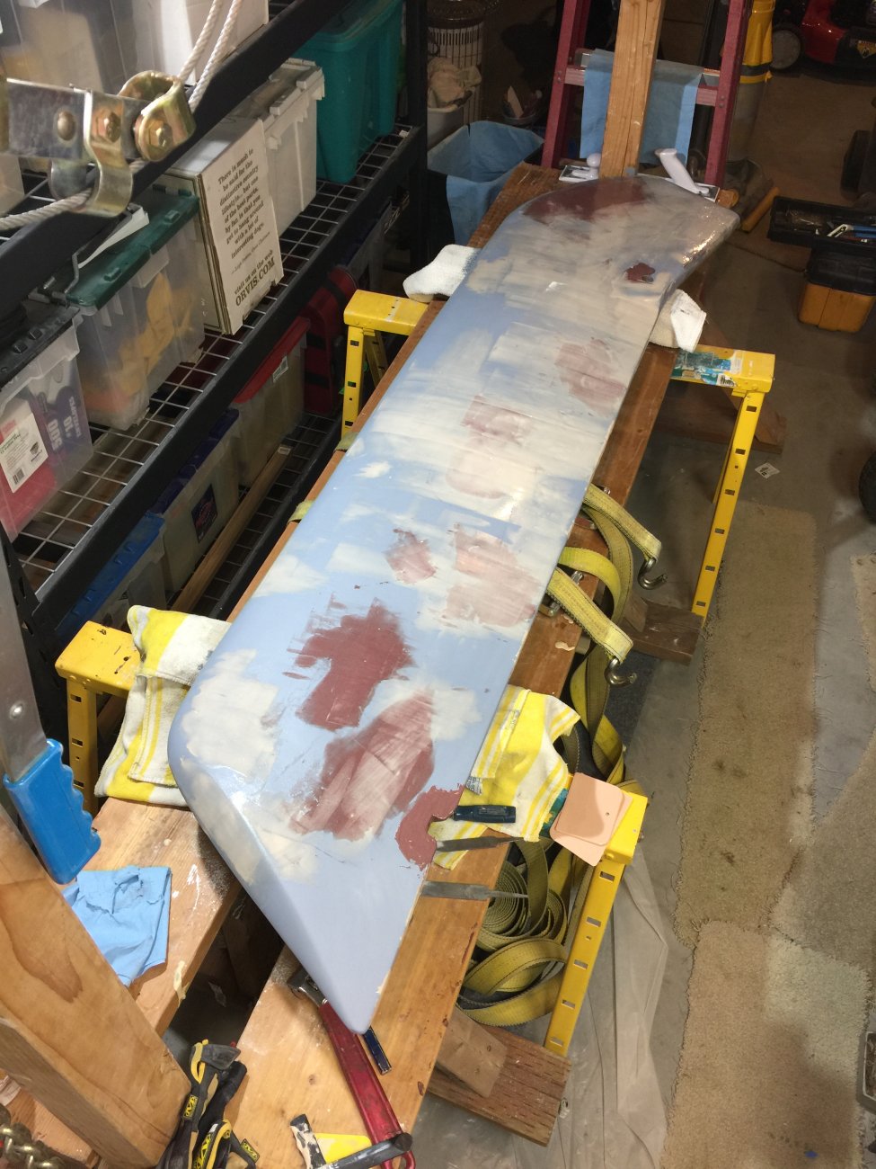

18) Some spot filling / fairing now that the primer shows all the hidden flaws, good time to touch up anything you're not happy with-- note the work around the keel eybolt

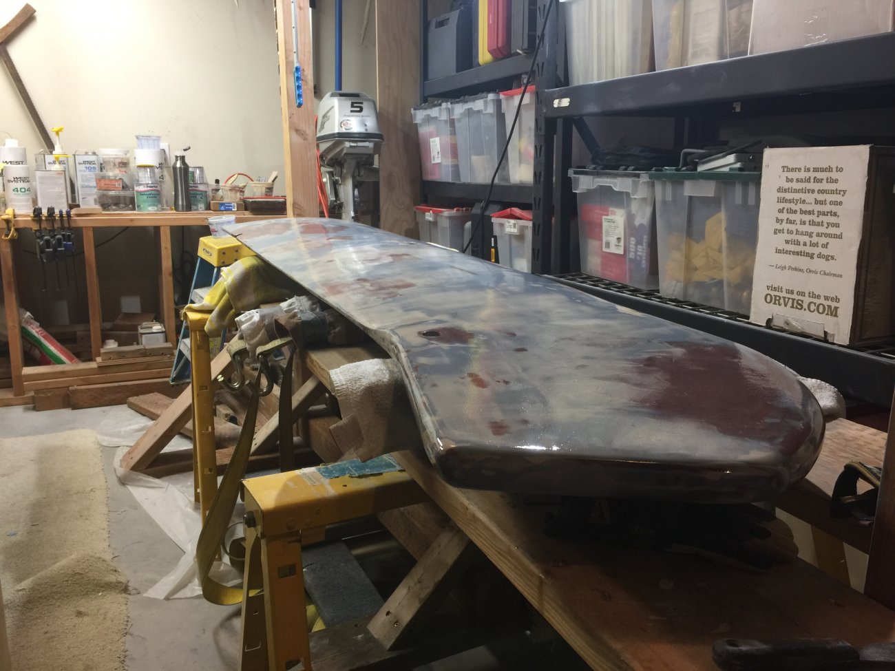

19) Last chance at filling / fairing and another coat of unthickened epoxy to smooth it all out for last primer coat. I Enjoy this photo as it actually looks like a wing finally.
20) Last primer before finish:

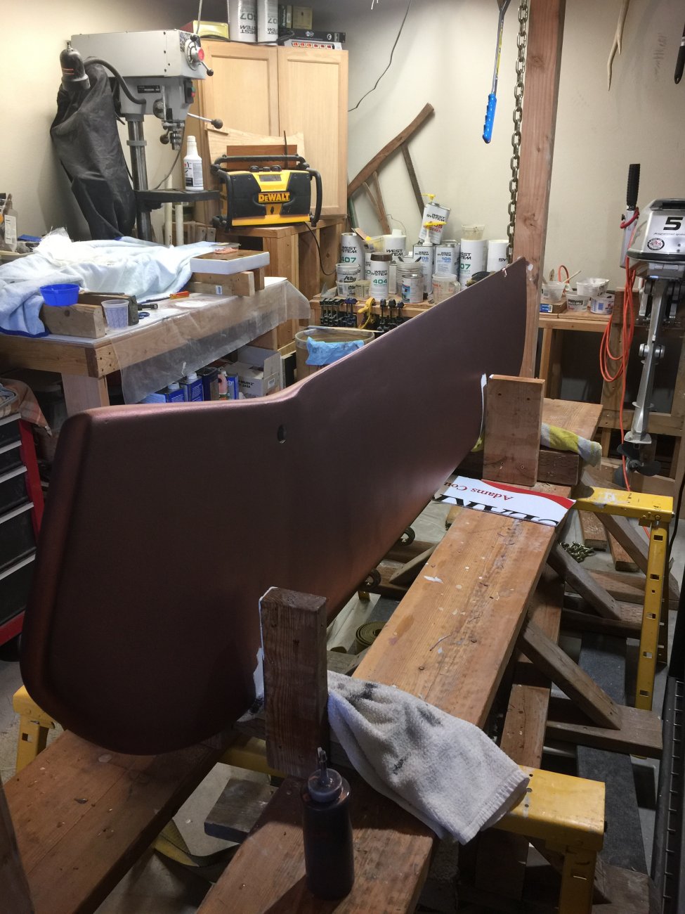

21) Finish coat of VC-17 as she's only a fresh water dunk and dash (doesn't stay wet more than a weekend at a time). PS. It's never going to turn blue-- 2 seasons and not enough exposure to lose the crimson. I should sail more often?

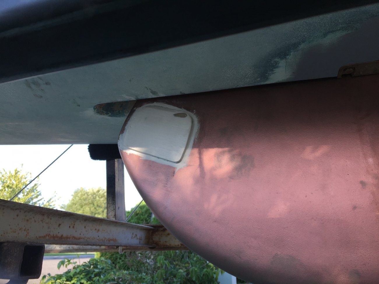

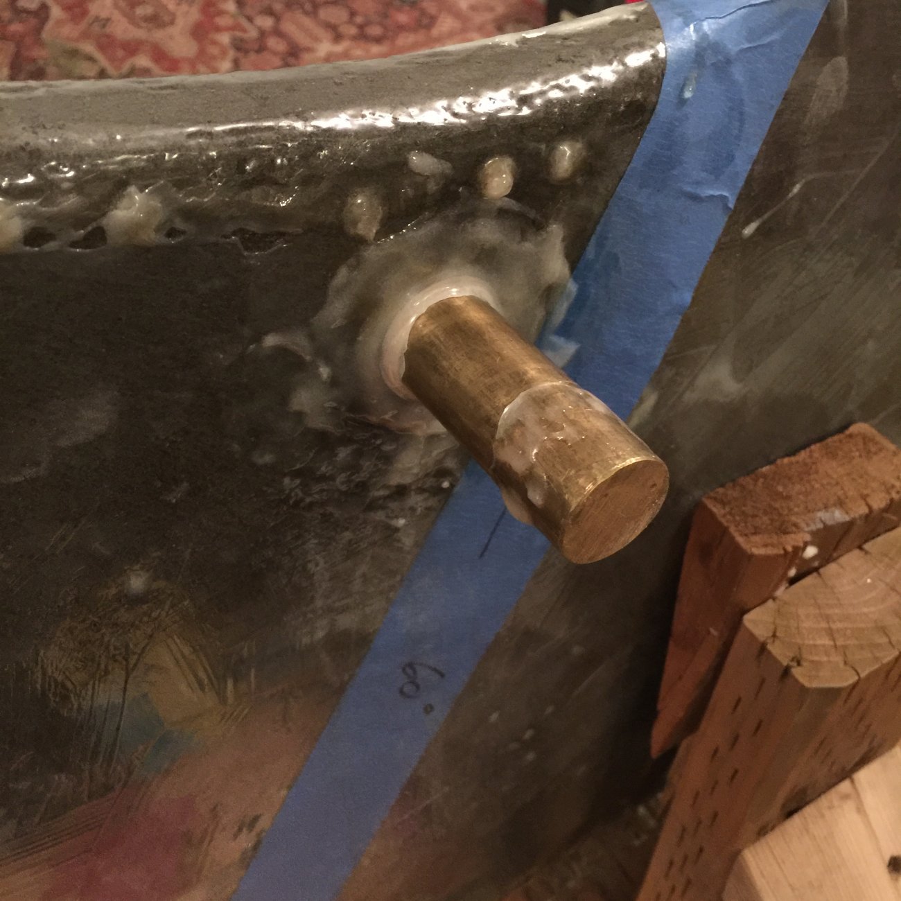

22) Made up some fiberglass spacers with all the scrap and applied accordingly-- 1/8 Delrin spacers courtesy of @CloudDiver 's leftover bin shimming each side of the keel pin
