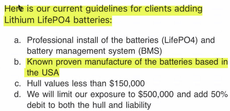

Ouch @Maine Sail. If I'm reading your post correctly (which I might not be) there is an indication that one might not be able to insure a boat with a value of more than $150,000 (I'm not in danger there;)). Does the last line mean that if you insured at $150K of hull value you'd have a "deductible" so to speak of $75K and if liability was involved they would only pay 1/2 of the liability award. In other words, you are self insured for 1/2 of the loss and liabiility up to a maximum payout by the insurance company of $500K. After that you are on your own. Do those conditions apply regardless of the cause of the loss (ie a collision that sinks your boat would still have those limits imposed) if it was not a battery failure related loss?
Regardless of the real physical risk, that imposes a pretty hefty financial risk.

Markel insurance:
@Maine Sail - reading this, it seems Battleborn batteries would comply with the first two points a) and b) as they are US manufactured and come with their BMS system installed in the batteries? Would that be correct?
Pretty sure the 50% is added cost of the premiums for hull and liability (ie 150% of the non-LFP premiums). And the $500k is max total they would pay in any claim. So don’t sink in an busy channel or burn up in a marina.
dj
The insurers, such as Markel etc. want to see a US company, on US soil, so they have someone to go after should an accident occur.
Batteries such as Kilovault, Lithionics, Battleborn, Dakota, Relion, Mastervolt, Victron, Trojan, Lifeline etc. would meet this criteria.
Batteries that come directly from China from non US Based companies such as SOK, AmpereTime, Chins, AO Lithium etc. Would not meet this criteria.
