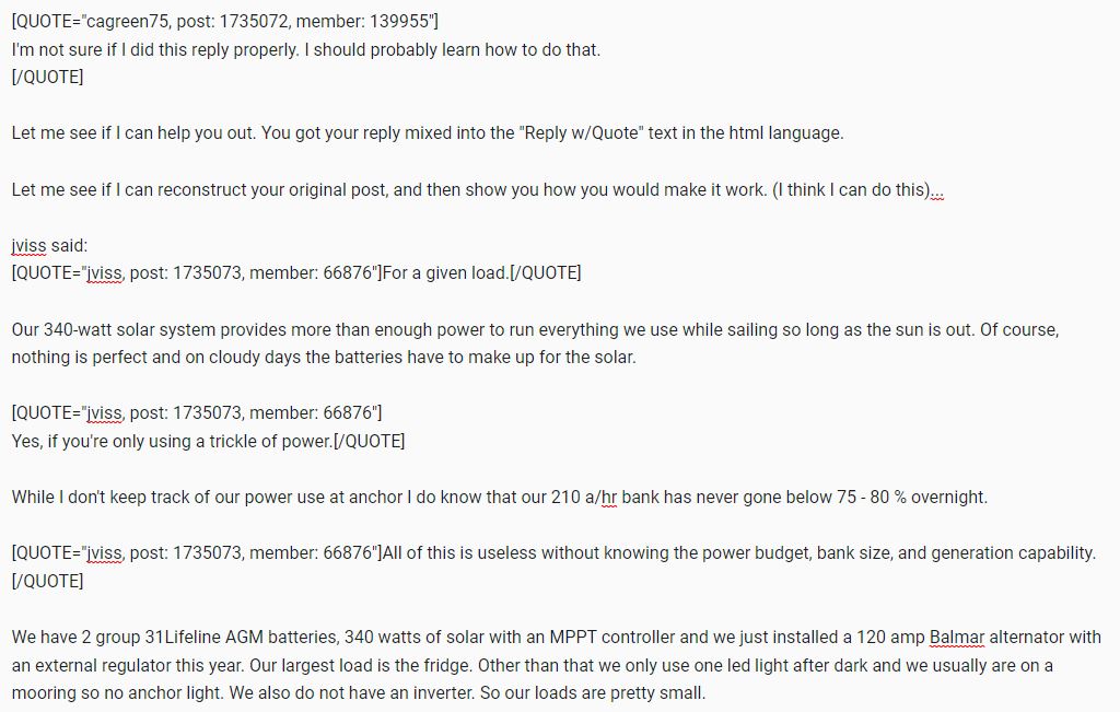

I've attached an image of the html text here (not perfect, but close):
Note the start and end of quoted text.... It takes practice...

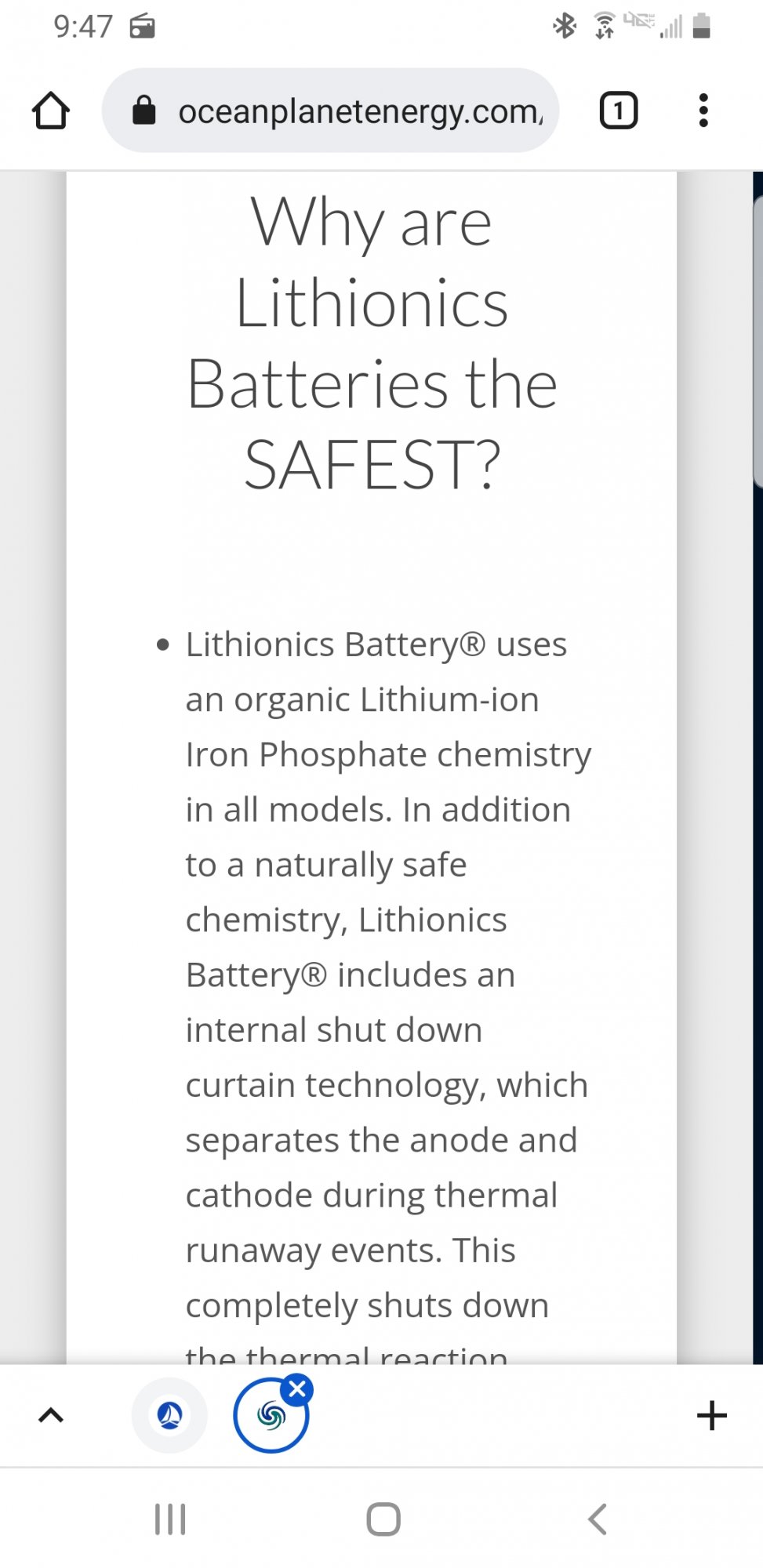

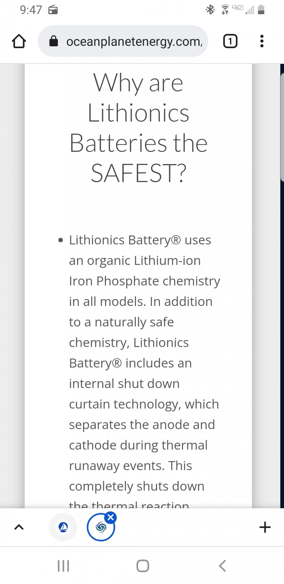

I have to chuckle when one uses the term "organic" in the sales propaganda for a battery.
Little off track but this reminds me when we had the farm. One of our Bostonian customers noticed we sold firewood. Yes we do & kidding around I told them it was "organic" firewood. Over the next month several pickup trucks made their way back to the city loaded with "organic" firewood.
I can't make this stuff up.
