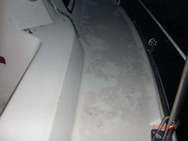

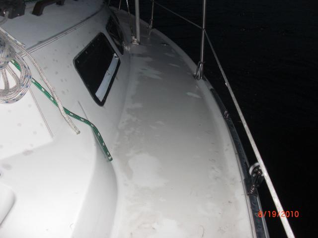

I am thinking about additional projects so one of the things that I'm a little dissatisfied with is pointing ability on our boat. I can attribute it to shoal draft keel but I'm also thinking that the track for the genny is too far outboard and that it would be simple to add an inside track. In the photo's the length from the shroud to the rope end is 5.5 feet and the distance from the outside track to the cabin edge is close to 18 inches. I really want to keep the track up against the cabin to keep the deck clear and I figure that the center of the inside track can be a good 16 inches to the inside of the outside track. The only thing I am pondering is how far aft to run the track. I want to keep it tucked in so it doesn't extend along the coaming (the coaming curves out into the deck), but the outside track extends aft about 22 inches aft from that rope. I could easily fit a 6' track if I moved it slightly aft from the shroud base.
I know about the theoretical calculations to determine the optimum positions, but somehow it always seems that the deck layout and practicality override. Any thoughts?

Is your jib that big where you'll need that extra 5" or are you just thinking form an "easy to get the 6' piece of track" point of view? If you need the extra 6 inches, how about splitting your 6' track, the first piece going along the cabin, the next shorter piece to go along the coaming. It would be somewhat of a PITA to get to the aft track every time you wanted to, but you could use a second block for that aft piece if you had occasion to set the sheet that far back.
Otherwise, it looks like you'd just have to come out from the cabin edge a bit, just angle it for maximum deck space.

Simply speaking.... the sail will determine where you put the new track. Or if you plan to buy a new sail, install the track and measure the sail to match its location. Looking at your pics, you could put a short track on the deck and another short one on the coaming.
Before you do all that though... I'd consider RichH's suggestion and experiment with barberhualing. You don't have to create anything fancy or expensive. Clipping a line to the sheet and running it cross the cabin top to a winch so you can pull the sheet inboard a few inches may give you an indication of the effectiveness of reducing your sheeting angle.... play with it.... I have an inside location for the genny, but not for the blade, so I've tried barberhauling with the simple technique described and found there is some improvement.
