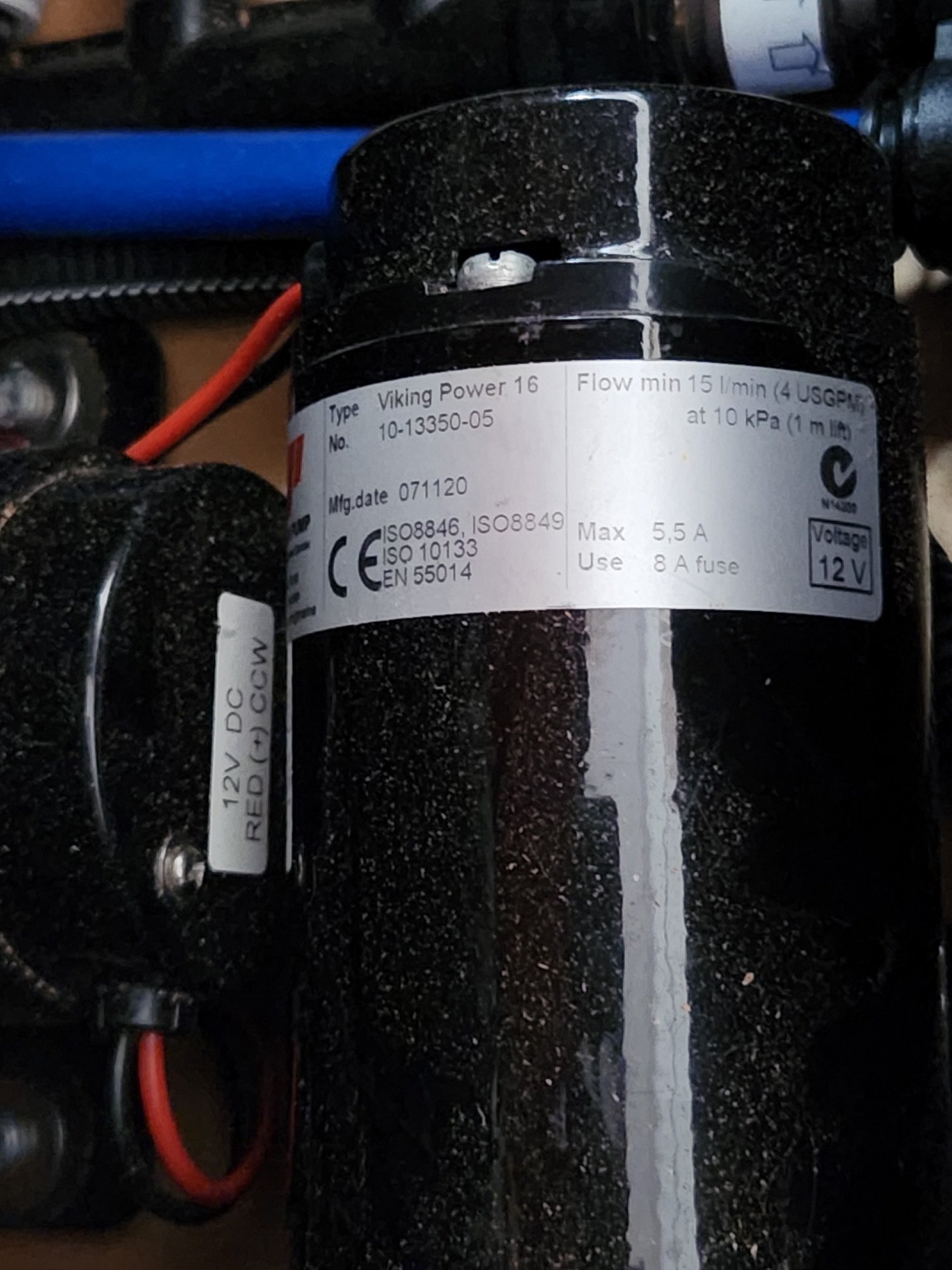

So I timed my bilge pump rate. One bucket in 20 to 24 seconds. Bucket appears to be about 2 gallons.
Looks like 6 gallons per minute to me. I tried it twice, once with the battey charger on and once with it off. The battery was full and the times were about the same.

It's in the attachment (picture).
So that is a diaphragm pump?
If it is this one, it says capacity is 4.5 gal/minute open flow.
Greg
Yes, it's a diaphragm pump.
The label says 4 us gallons at 1 meter. Sounds about right to me.
I think my bucket is closer to 1.75 gallons. So I measured about 5.25gpm at 12.9 volts. That's 315gph or almost as much water as my hot tub holds, it take some time to fill it with a garden hose too.
Will it keep my boat from sinking? Yes, but only if the in flow of water is less than the pump can remove. Simple right.
