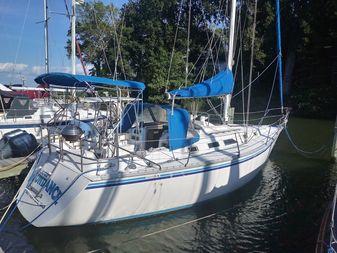

Once I got the financing in order, I purchased her at a marina near Baltimore and sailed her 50ish miles home to southern Maryland with a close friend. We made 8.5 knots on the head sail alone (155 genoa) but I left the engine running the whole time because I was a nervous wreck. Once in her slip I got to work.

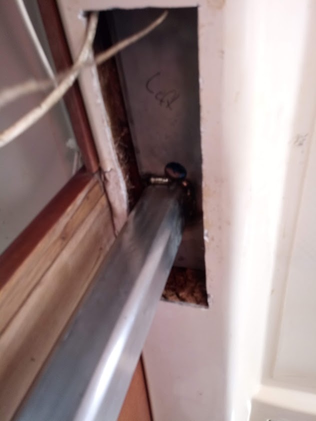

It is well known and documented that the 34 has a compression post issue so I pulled the mast and got to work. She had a noticeable crack in the transverse beam and I had no doubt it needed to be done. I replaced the rotten wood with 2” square stainless with ¼ thickness and welded 5/8 stainless plates to the top and bottom that I cut at work on an industrial band saw. (I know its overkill but I am glad that its too strong to fail EVER). After that was resolved I got to work replacing the floor that was rotten around the post. This is all done on a budget so it doesn’t match exactly. I am working on balancing enjoying the boat with friends and getting everything up to a certain level of appearance.

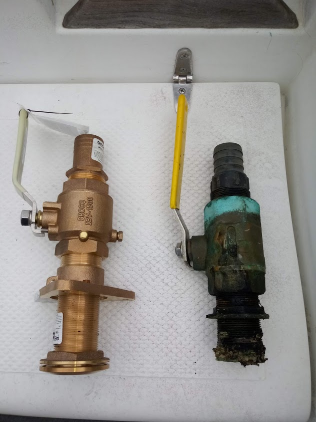

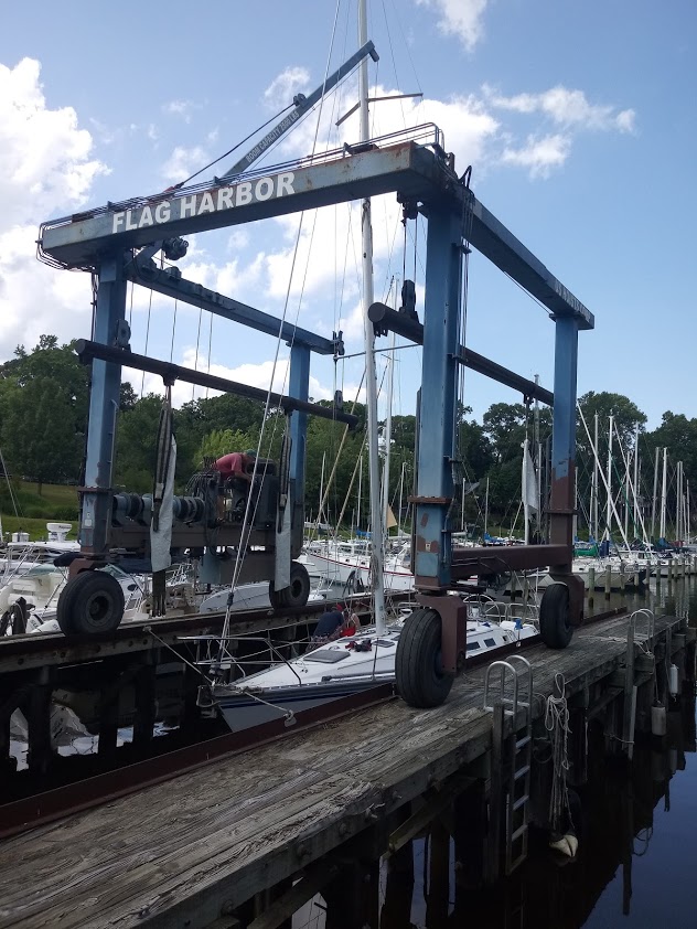

By the end of the summer of 2019 I had noticed that one of thru hulls was dripping slightly from the ball valve that was incorrectly installed directly with no flange. So I had her hauled and got to work on replacements from groco. This was costly to say the least but I sure do sleep better knowing that they are all correct. I also used this time to replace all the stinky waste hoses and put in a new jabsco head. Again, more money! But this is what I signed up for.
After putting on some bottom paint and replacing the anodes I had her put back in the water and got started with all new pex plumbing from home depot. Fortunately that went extremely well and I surely do enjoy having running water. What a treat!

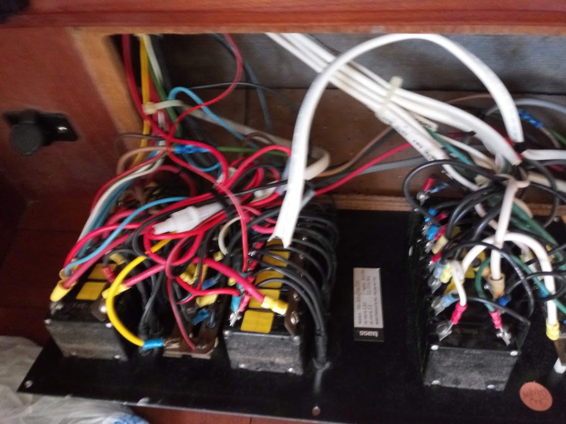

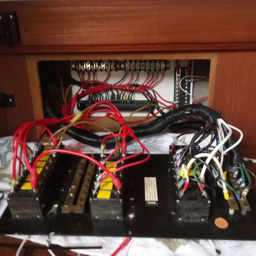

I just finished am major overhaul of the electrical panel. I cant believe how poorly this was done from the factory but it did last over 30 years with no fires! None of the wires were tinned, most of the connectors were the fork style, often the connectors had 4 wires going into them and the AC side was so tight that I couldn’t pull the panel down without shifting the thing to the left putting stress on the DC side. I added bus bars, ring terminals and terminal strips with tinned wires. Looks nicer and all neatly on a “back plane” painted white. Not super expensive and totally worth it.

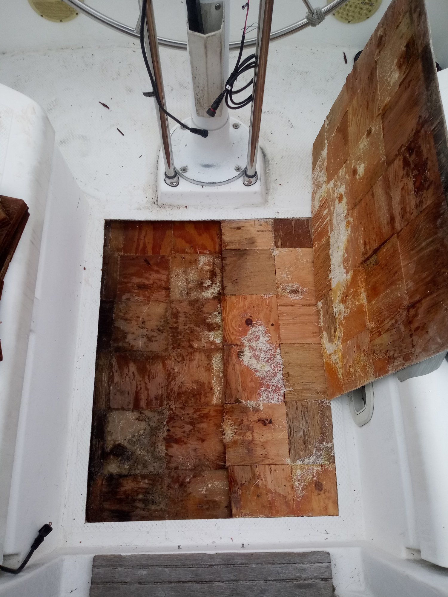

Right now though i need to finish this cockpit floor core job i started this weekend. What an adventure being so itchy with so many busted knuckles. I was gentle enough that I think i can just re skin it with the piece cut out. Sacrificed my fingers by not just taking a pry bar to the skin and i think it'll pay off.
I met a local boat builder/repair man and it was such a blessing to meet someone so willing to teach. He even purchased a few things from a local supplier at cost for me, as well as selling me some plywood scraps and csm and thickener. It seems to me that the community of boaters and especially sailors attracts kind and generous people.
I'll post pictures when its finished but here it is now.

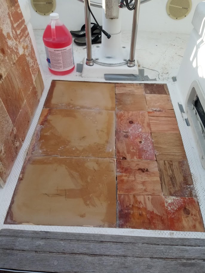

I finally got up the courage to install the plywood in the cockpit today and i think it went very well. I used polyester resin with 406 thickener and put in some pieces of plywood that a local boatbuilder had sitting around. After it set up I went ahead and adhered the top skin back on a thinner mixture. What a stressful experience at first this was. I could feel the polyester thickening every minute, even though I mixed it exactly to the specifications on the back of the container. I was way more confident the second time mixing it when I applied the top skin but ended up using way more than was necessary and it oozed out all the way around when I applied the weights to hold it down. It was no issue though, I just got some old rags and some acetone and wiped it up as it spilled. I am happy to know that the entire area is saturated and should be water tight now though(at least as much as polyester can be).
The next step will be to sand the joint down, apply CSM followed by fairing with gelcoat on top to complete the project. I know polyester is inferior to epoxy in every way but with my budget and desire to use gelcoat in stead of paint it is the best option.

@drew- I really like your approach to diving in and getting jobs done. I'm not sure what you mean by CSM, you know you have to bevel the edges the fiberglass the joint right? Sorry for pointing out the obvious if you have already accounted for this, it just wasn't apparent from your post.

@DArcy - CSM is chopped strand mat. Once I bevel the cut joint I will be using CSM to join them back together "seamlessly" lol. I have plenty of resin and mat as well as gel coat because I am sure its going to take some learning to get it right. Its the first thing people will see when they get on the boat so I want it to look good.

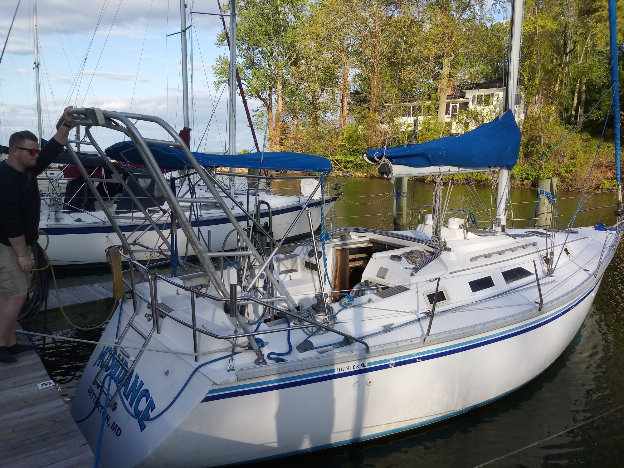

On a side note I found an ARCH!!! I had my brother hold it in place for a picture. I only need to extend the front feet and it looks like it will fit. I am going to try to fit 300 watts of solar on it as well as use it for a dinghy davit. It has been surprisingly cold and windy so I havent finished the floor yet but I am gathering a bunch of other cruising gear in the mean time.

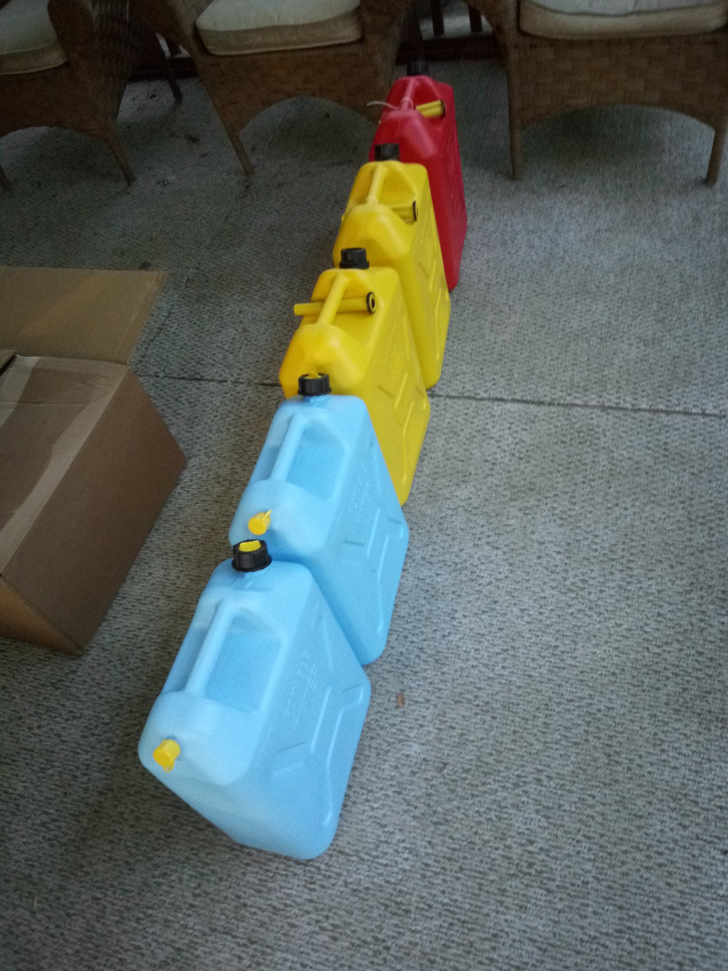

I purchased a handheld radio, Gerry cans, 90 feet of 5/16 anchor chain, 2000w generator and a water heater so far but I still need a few other things. I have been super blessed to not only have a job right now but also have the ability to work unlimited overtime. I have been working 55 - 60 + hours a week to feed the kitty while I can. I pray that others will get employment soon and back on their feet.

Nice! Try not to have too much weight on the ends of the boat or high up (it can affect stability and seaworthiness). Go for a lightweight dinghy (single-floor RIB or slatted/inflatable floor) if a RIB has a flat interior floor it's double-hulled and too heavy.
A built up base for the arch might be an alternative to an extension, depending on your situation.

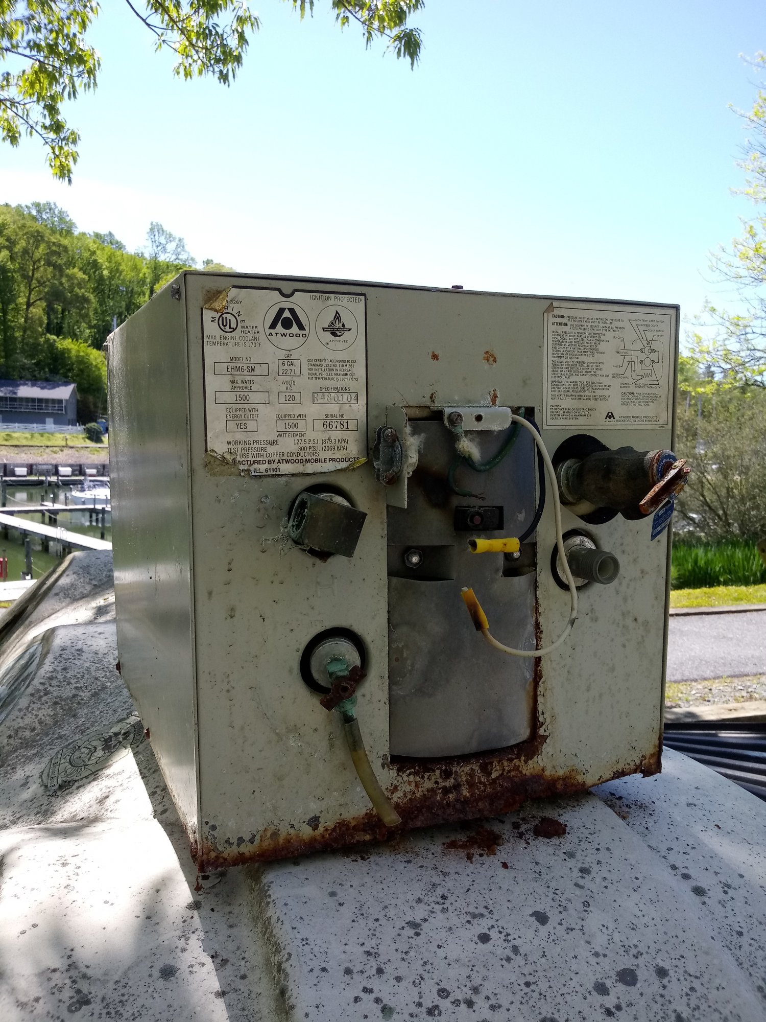

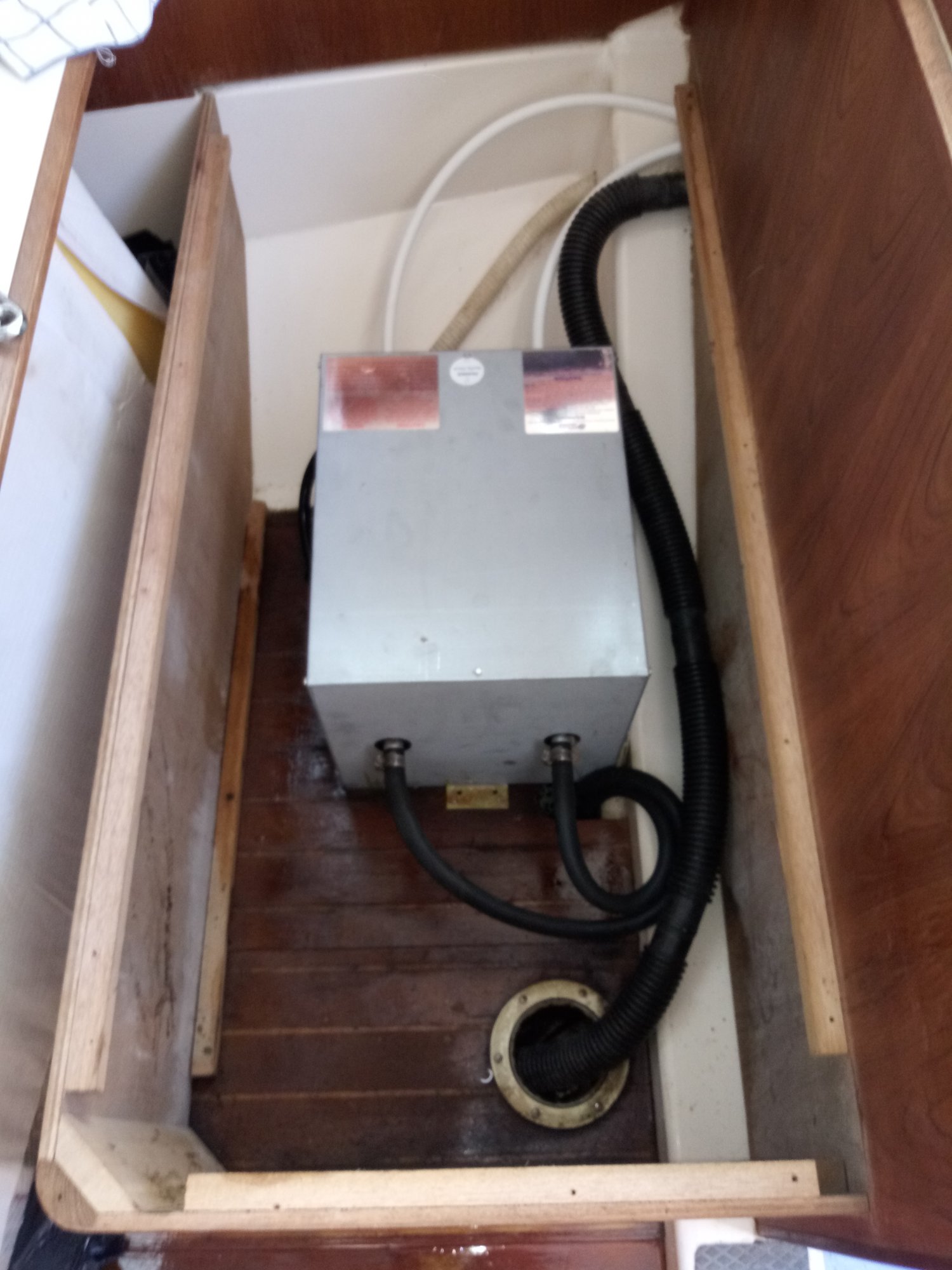

Out with the old and in with the new! Installed a new water heater this weekend. Its petty exciting to have hot water in the boat. I also got my gerry cans in yesterday. I'm pretty excited. I have a couple questions for the h34 owners and 3gm owners. The first questions is has anyone ever had nasty green coolant that even after fresh water rinsed for a whole day still looks bad? I purchased the diesel cavitation protection coolant and before i put it in i tried washing the brown tinted color out of the system with no success. Should i be worried that the PO had green in it? Is that dark brown color on the top of this green coolant my engine's metal? Im afraid of using a chemical flush for fear of it ending up in the new water heater. Also having trouble with air system after adding new coolant. Should i pull the thermostat housing? I didnt let it overheat bad but it wasn't moving coolant like it should and i did get the over temp alarm. Shut it down the second it came on.
